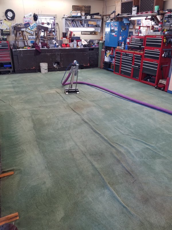

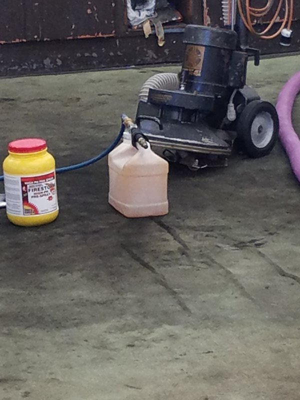

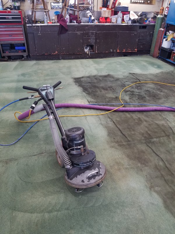

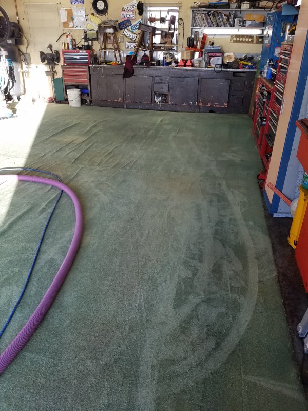

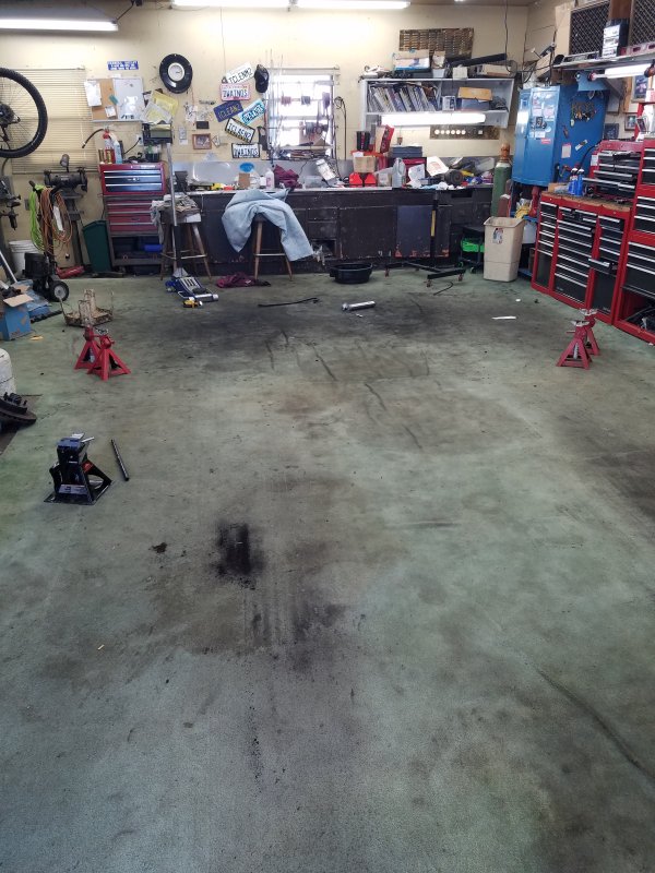

back in the 80's when rx20's first came out i wasn't convinced i needed a 2500.00 attachment to make my 15,0000(that was an expensive tm then)carpet cleaner work better . Like you sometime around the mid 90's i ended up with one. Got it for free. It had froze and didnt work. It sat around my shop in the way for 6 or 7 months. 1 day i got a bug up my ass and got it to work. The next day i went out and bought a brand new one and from that day on I've used a rotary on every job. I love um! However I do clean carpets a little differently . After prespray i clean and dry with rotary and use an emulsifier. Then switch to a rinsing agent and clean and dry again with a 45 year old drag wand. Below is my shop carpet after replacing the entire front end on a chevy 3500 van and a ford ranger, yep thats alot of bearing grease!

Probably, but I've been using steamgeni drag wands since i got the first one with a 731 portable in 1978 and the one i use now came with a new steamgeni 733 portable i bought new in 1979 since then I've aquired 5 additional including a nos one my supplier gave me for my birthday (it's on my Frankenstein machine) also i have a 12" steamgeni drag wand i use for tiny homes/ 5th wheels and area rugs so in short im already committed
