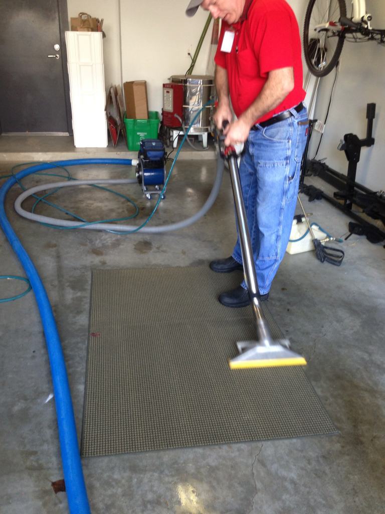

2008 Bentley , waiting for the upgrade!
Swivel still in excellent Condition does not leak air. Bought this one from Cobb but kind of heavy.

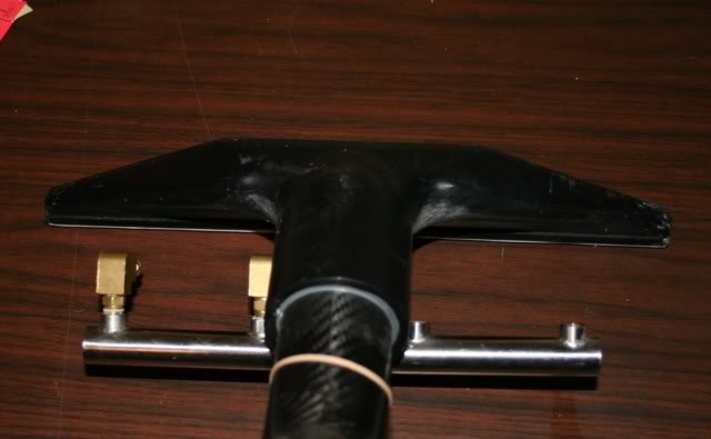

Still a horrible design.
way to get around that manifold mount location
More lipstick on a pig. I like the carbon fiber idea. Too bad the design isn't right. Wish they could scrap the current one totally and go back to the drawing board with cleaner proven designs. The bend on the bottom just isn't right and it sets up the manifold to be too close to the carpet IMHO. ( I guess they could make a really tall glide for it as a retrofit.)
