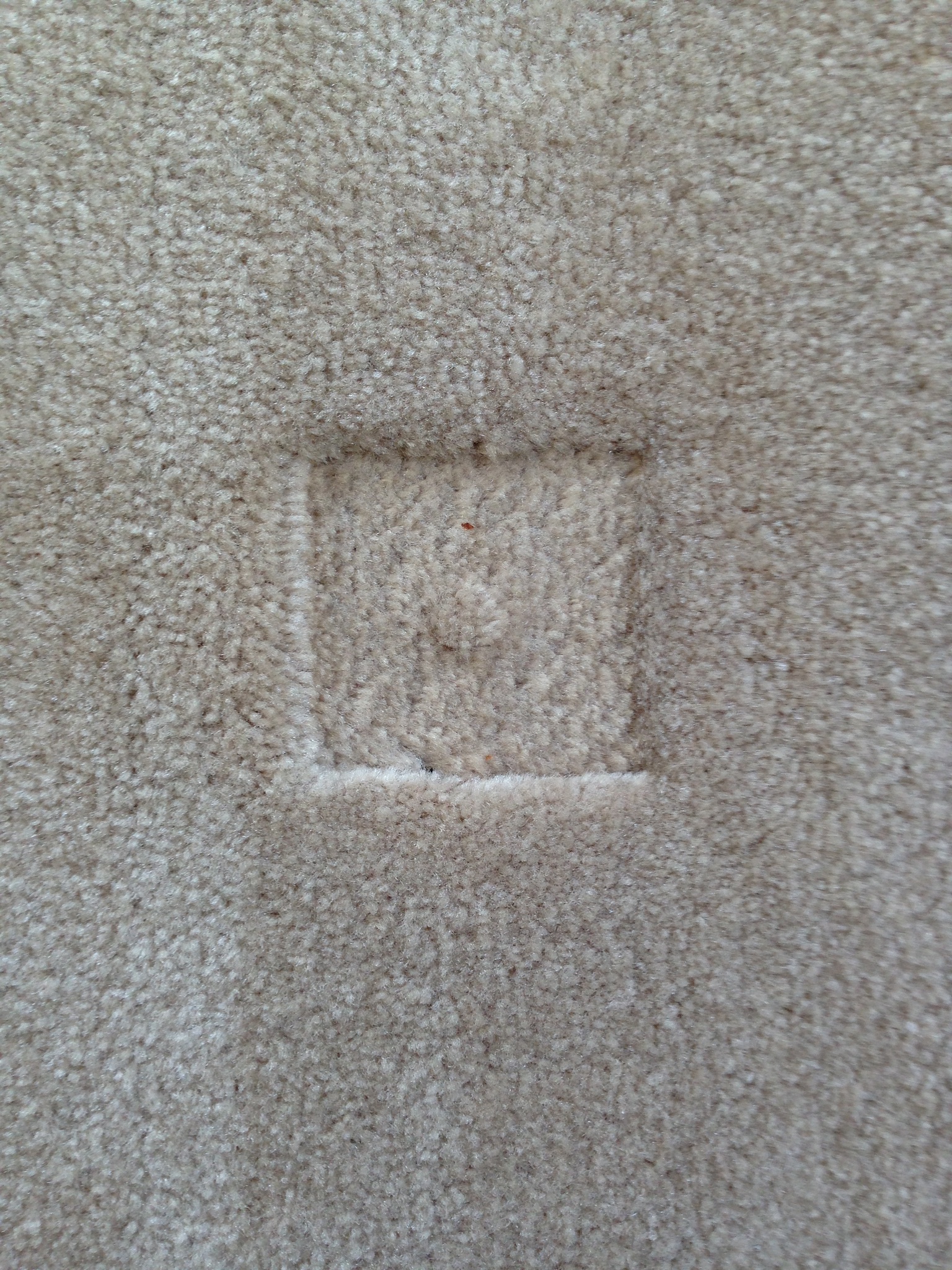

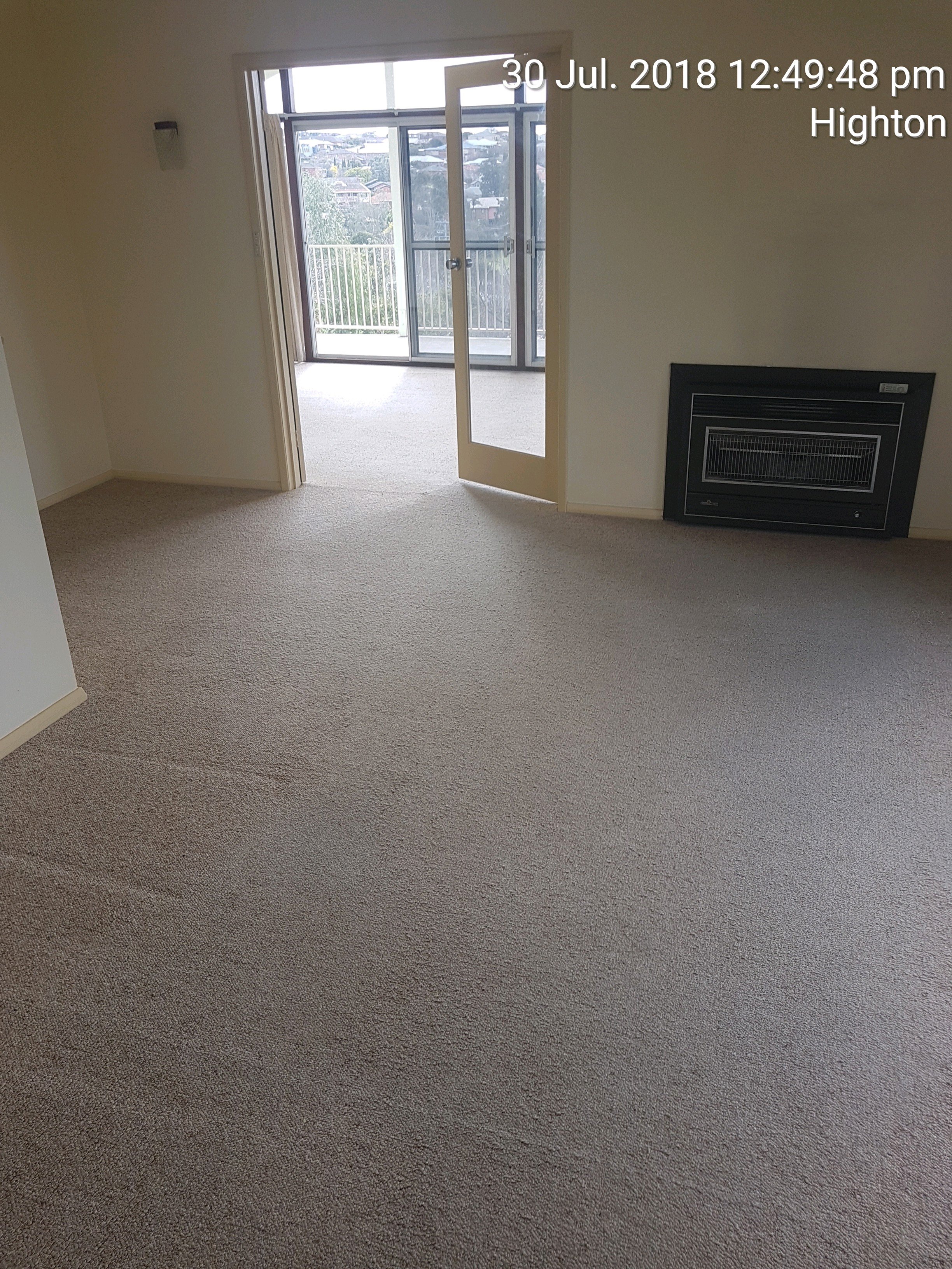

I cleaned this carpet today and you may notice a couple of indentations on the left wall.
Once the carpet is dry I advise the client to fill up the indentations with water. This releases the tension in the face yarn.
What do you guys advise?
