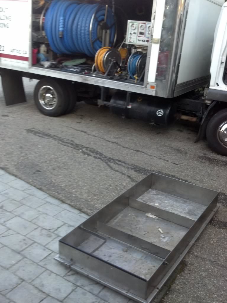

into the bellly of the beAst
114,118

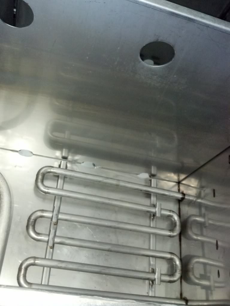

had enough with dealing with the leak in my V Fresh tank
Ripped off the filthy lid
Found that one of the pos baffle walls broke loose , AGAIN :!:
(propped up in pic)
Free heat system still works..
But my leak was just this ******* plastic fitting on the bottom end of the water sight tube.
Took it to Home Depot and cant find anything to replace it with, super fine threading...
Any one have a clue what industry this comes from?
the black line in there is the crack..

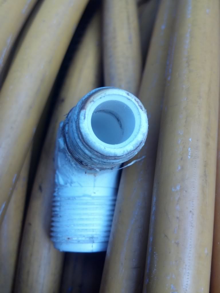

114,118
some sort of plastic, is not as hard as PVC.
Very fine threads is all I know, could not find a similar thread in all of HD, plumbing or nuts and bolts

What do the fine threads fit into? Is it just for plain water?

114,118
fits into a welded on female fitting on the bottom of the tank
Same fitting up top, a clear tube runs between them with compression fittings.
Worse case scenario I just put this one up top, not going to leak above the water line.

From what I see, it looks like a 3/8" ips x 3/8" compression elbow like you'd use on a dishwasher.

It IS a street-el, looks like a nat gas fitting. Is it described in the schematics in the owners manual? (yeah right)
3/8npt x ???fine by looks.

Just go to an irrigation supply place and they can make you up one with a slip 90 and two nipples. PVC or ABS.

114,118

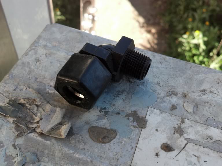

Found a replacement in my new buddy's garage..

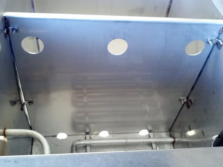

Had a customer offer to do some welding if I ever needed help with my tanks..
Five hours later he may have regretted ever opening his mouf.
I did score him a Mytee Tempo Spotter for cost though..
Found a crack in a weld along a floor seam and a corner seam as well as that cracked plastic fitting
It was the baffle walls the took the most time though. Not the first time they came loose, the pos tank is so flexy that the spot welds (originally tack welds :shock: ) break loose and the walls come tumbling down This time we made ss brackets and welded them to the side of the tank and loosely bolted them on in 4 spots so they can flex and float with the movement.

That fitting looks like it's cts, copper tube size, on the compression x regular ips threads. Next time you need one of those, you can get a Quest brand fitting from HD or Lowes. They are gray and on the same aisle as pex piping usually. Also a "sharkbite" brand fitting would have worked too.
What kind of pipe was on the side with the nut?
