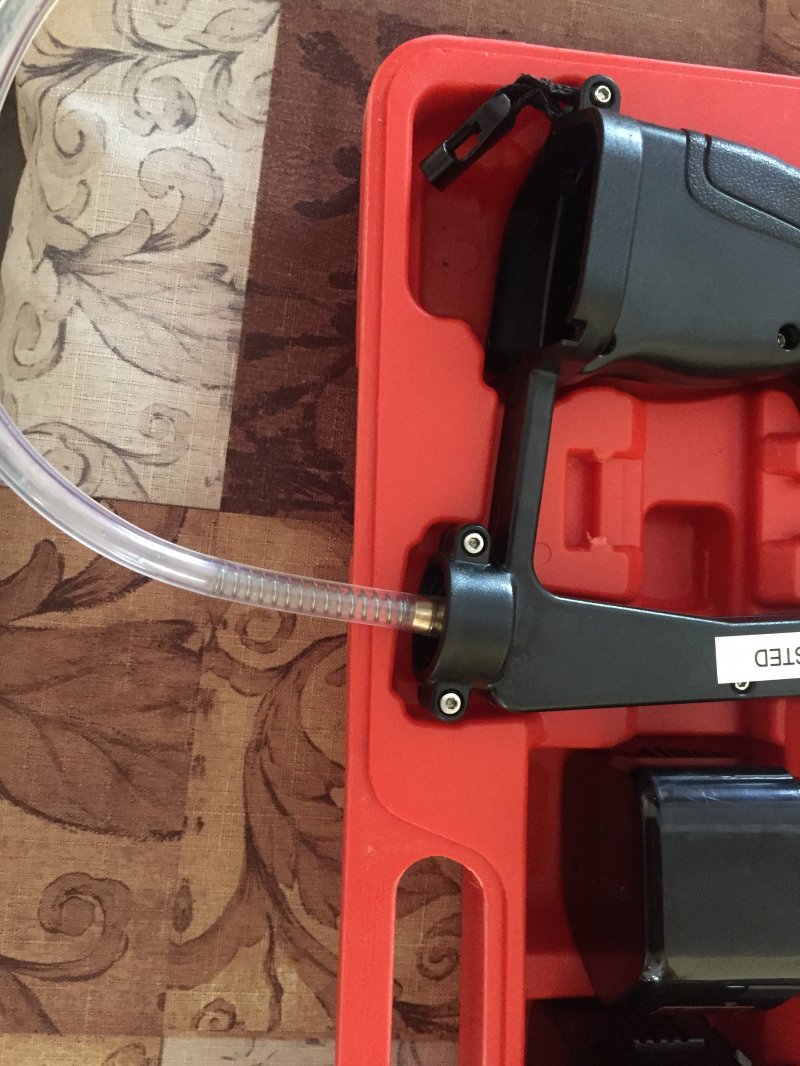

But; the case needs to be redesigned or disposed of in favor of a toolbox, because it is so closely fit that you have to remove the pickup hose, and any tip to put it back in the case. You cannot avoid complete assembly and disassembly and it will shorten the life of the plastic parts and the tubing. (Second picture).
There is no possible way that once uncoiled, that clear tubing will ever go back in. In short, the case is suited for shipping the IPS, then useless afterwards for day to day use.

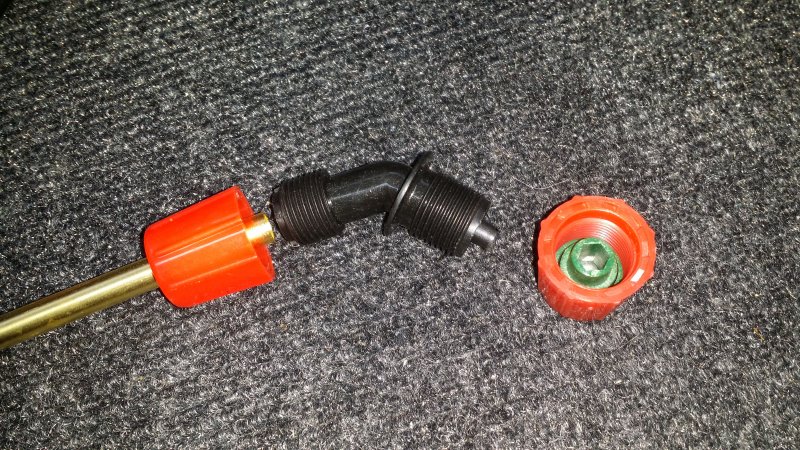

Then, just to pile on, the brass tube is attached to the gun or wand with the afore mentioned compression nuts; one attaches to the gun or wand, the other holds the fog tip. BUT: for a compression nut to work, there has to be a tapered interior sleeve or compression ring. As the nut is tightened, the sleeve (or ring) should squeeze tightly onto the brass tube and holds the assembly by friction.
The ISP lacks either a tapered sleeve or compression ring in the compression nuts. So....today I was happily spraying product for a minute, when PLOOP! Off popped the tip assembly and I hosed about a straight stream cupful of product before I knew it. No compression, no using the fog tip. (First picture).

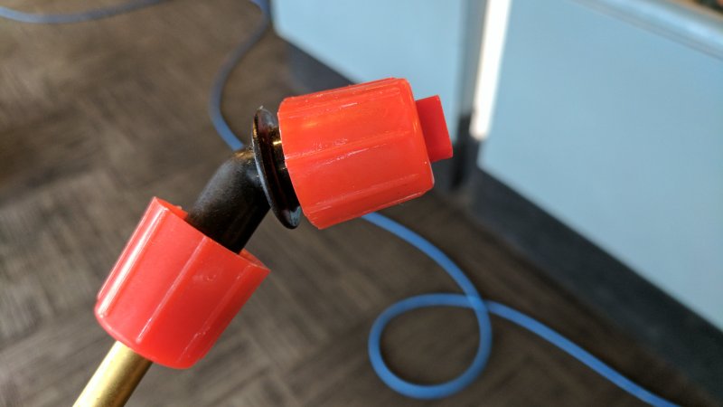

you got the black angled elbow backwards between the compression and the spray tip.
Shame the case doesn't hold the assembled sprayer

You put the impeder down inside the brass tube instead of against the metal tip? I'll look at it tomorrow. How do you prevent it popping off at either end, did you get proper compression nuts, or rings?

Haw haw, Mike. "Mike would never steer me wrong" I thought. Being a trusting guy I did what 42 years of plumbing told me wouldn't work and guess what? Turning the adapter around produced a jet that would shoot across the room. Not a spray. If the impeder isn't right up against the metal tip, you get a straight stream (in addition to poor compression of the adapters).

no worries, I felt as stupid as you will once you have that Ah Ha moment and it all makes sense. Keep trying, it works.

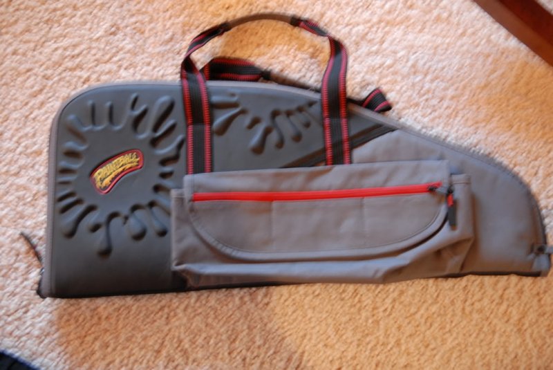

Start looking for alternative cases to carry the sprayer and accessories.
I found a couple of small Paintball gear bags that may be a nice fit......NOT one that screams firearm of course.

Frank is right. And btw, the paintball case is brilliant.

I don't understand why your sprayer won't fit in it's case. I install the qc on the sprayers all the time and it fits in the case as it was made to do, without issue, and I don't remove the little IPS roller cover on the end either.
Regarding the case not being usable? I understand that if your gun doesn't fit, because of a modification someone had done, or installed to many fittings on the end, of course it won't fit. I'm interested in seeing your sprayer in the case, or a picture of the end to see what kind of hardware is on it. I know I could figure out what's wrong in your case if I could see it. Franky, I don't store the sprayer in its case because it's used on every job, and it just gets in the way. I even tell my customers that if it's inconvenient to use by removing and storing back in the case after every job, it won't get used. As for Frank, well he's celebrating his birthday with his daughter today and he sorry he can't join us in this conversation.

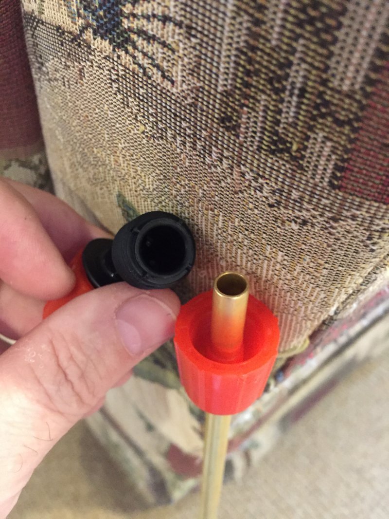

What about this, pic 1 and 3 same. Just cut off a 2"piece of the brass tube like that and install. Then you have a short tube that will work as you want it to. Regarding the qc installed on the end automatically? I'm not sure why it wasn't. But again it's an upgrade. Many people don't order it at the same time ect. As for the hose not fitting in the case attached to the gun? Do you keep a drill bit attached to your cordless drill when you put it away? Probably not because it won't fit, just like the sprayer. Sorry But all of these little issues are the same little things we used to encounter when using a new pump up sprayer. Working out and tweeking it to our liking. I'm glad you like the sprayer, as a matter of fact. I think I sent that to you, it had my test sticker on it. Lol

Chip, the short tube idea is perfect, or a 3/8" brass mechanic's coupling. And yeah, I'll sort the other things out, but take my comments as constructive criticism, then sell a $290 version, hahaha!

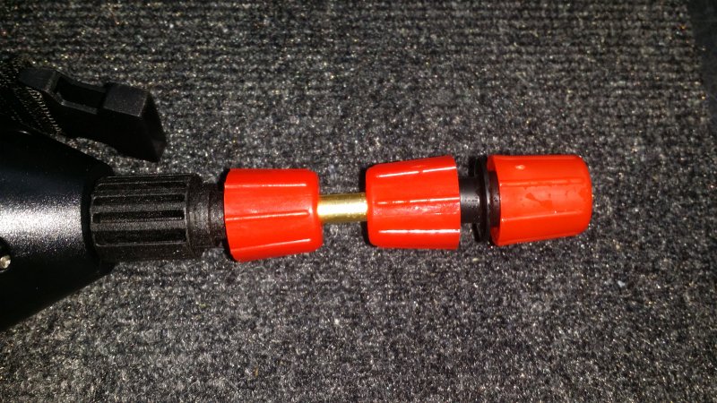

american brass couplers wont fit.
just assemble the tip like I show in my photo and quit being such a marty.
