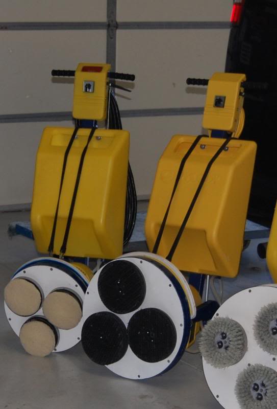

Shorty showed a few years ago how he uses a big rubber bungee and it helps hold the head up to the handle. That helps, at least you don't have to worry about the head pinching your fingers.

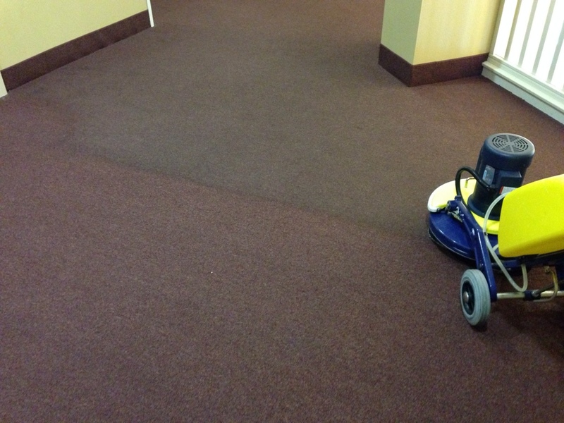

Big Yella is eating it up again today!
I'd never attempt this kind if production on CGD in a building this large.
Helps us stay competitive with our pricing too.
