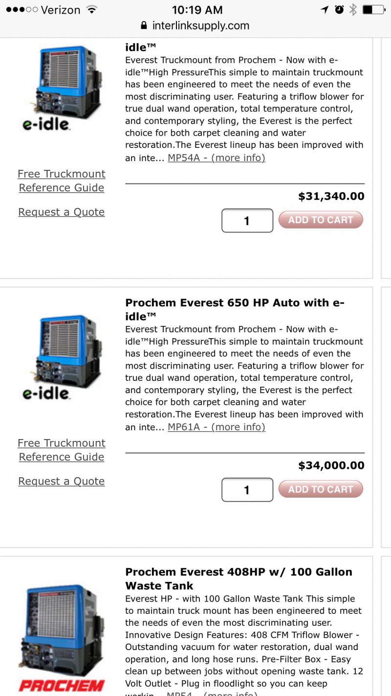

10 years a Prochem Everest owner. Van getting tired so almost time for new again. But having enjoyed the Everest can I really go back to an air cooled slide in? Or possibly a truck powered system e.g. CDs butler or pro 1200? Or is my grass greener than the other side.
PROCHEM EVEREST PROS:
Heat
Quiet for a slide in
Very little maintenance/very reliable
Great CFM
CONS:
Heat - dumps water like crazy if using low flow tools. Also gets crazy hot in the van.
Large footprint. Also in a standard roof van tank is a pita to clean and service.
Heavy
New units $$$$$. $34000 with all the bells and whistles (just the truck mount)
Anyone moved to a different system from an Everest and been happy?
