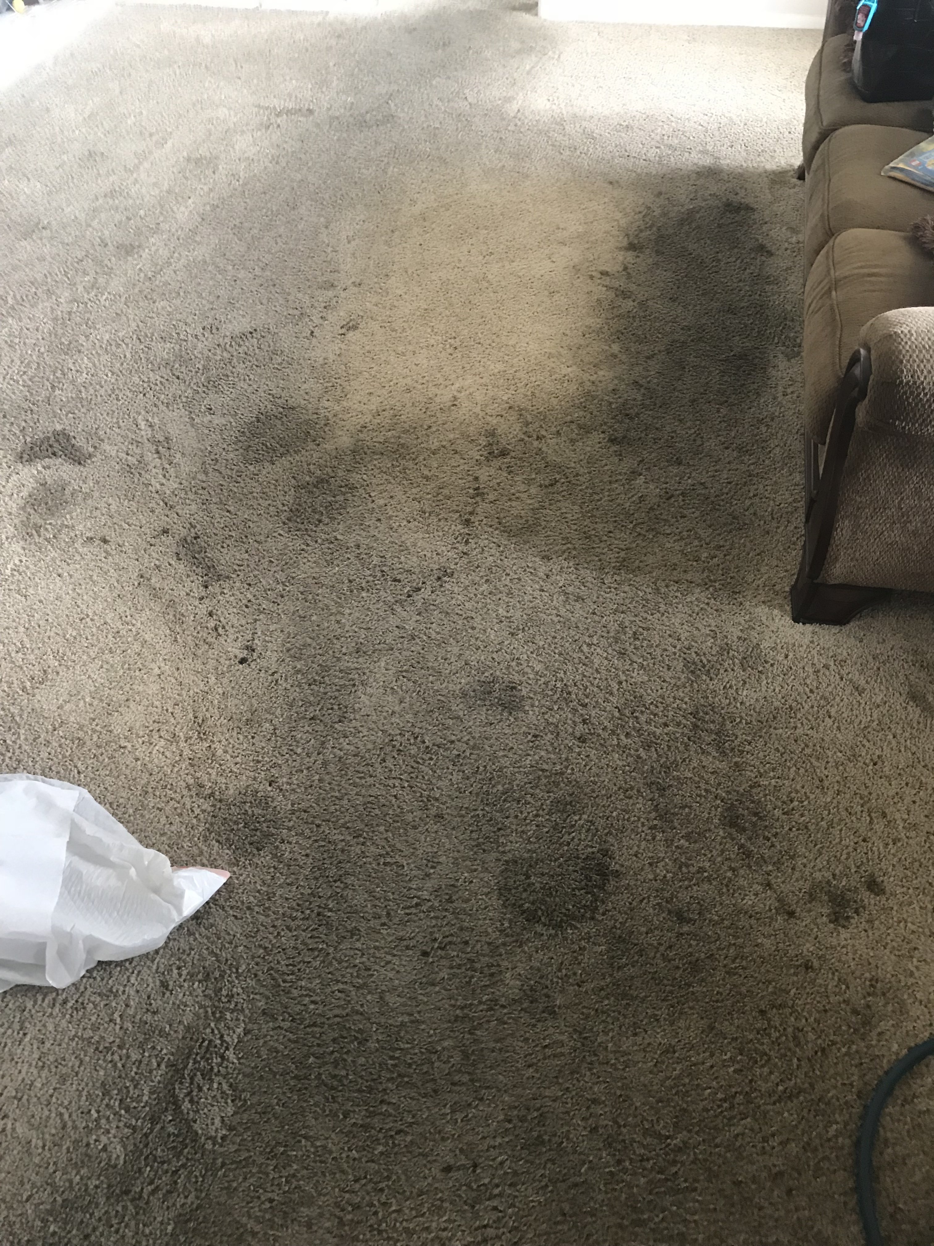

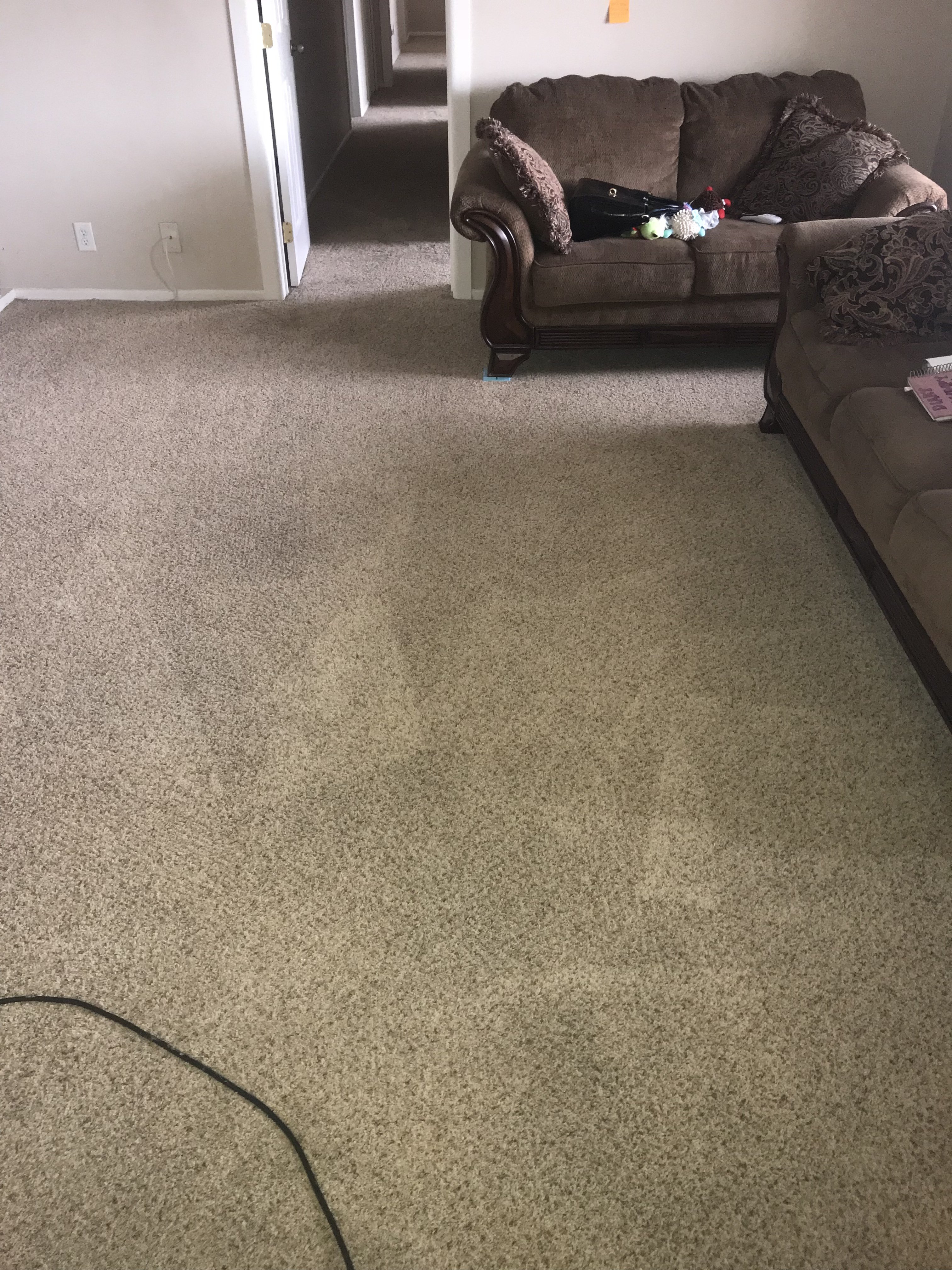

Just used the 360i for the first time, it did its job but....

After day two, I gotta say it was pretty cool to be able to easily grab the tool and carry it in one hand 150 feet away up a flight of stairs and into a unit while carrying my clipboard in the other hand. Even without the brush head I was able to turn this driveway back into a carpet again without anywhere near as much effort, tool is amazing!
