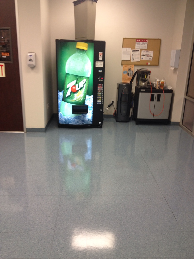

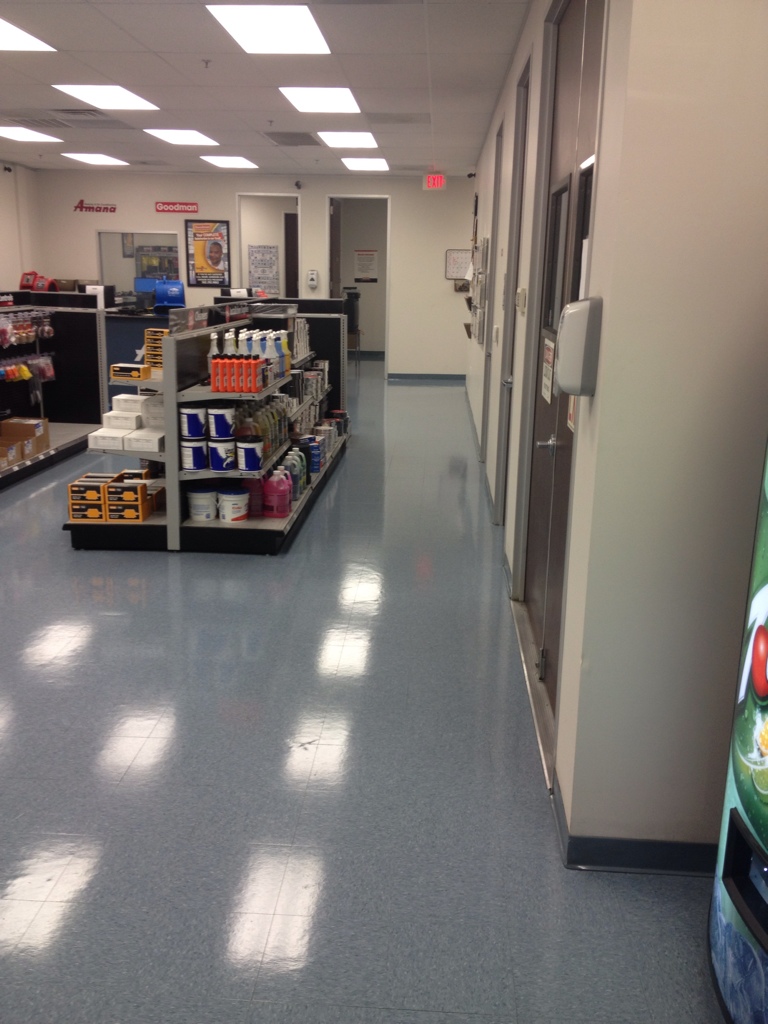

I agree with most but have tried the microfiber for laying the finish down and find I am much faster with a 36 mop. Just finished this one a little while ago.
