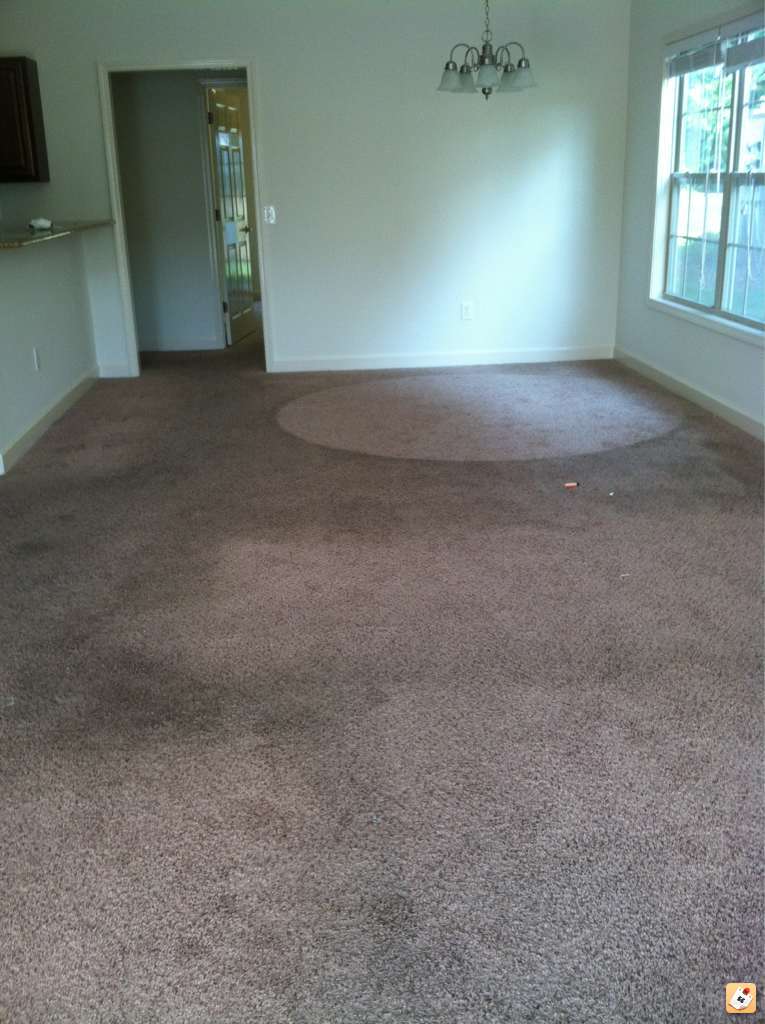

Found a unit to test in : )
Cleaned this exact unit 2 months ago an look how they left it. Sheesh

It should be coming up this week. They called and wanted me to inspect it first.
Middle tank : )

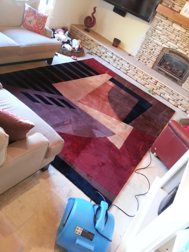

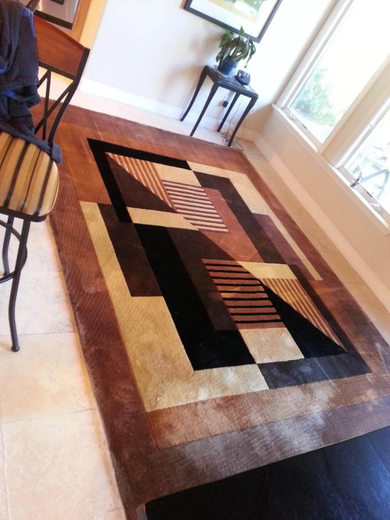

Di a greasy dog REtriever job today, just loaded with oily soil, the HF loaded wiht Flex ran out and we had some wool rugs to do so half a room got sprayed with eh MJ along with the wool tufteds. They were loaded with doggy dirt, drool from you and chews, food and drink spills etc.
All of it came out with just a scrubbing and AT'n.
Pre spray and rinse..
as long as you don't have a POS siphon that draws up hill, you will LOVe this for wool, uph and moderately soiled nice wtw.

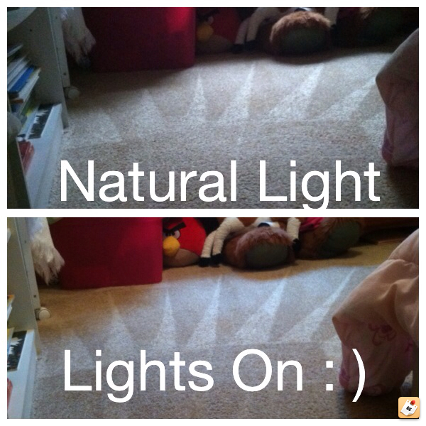

Used Green Earth Traffic Lane Cleaner as the so called detergent : ). It's a little whimpy. Rinsed with Mikeys Potion.
Room wasn't that dirty to begin with, still yet a kids room.
Will give more results as I use it up.

Hey Art,
I posted another thread about that trashed unit and using another brand. It didn't end well : (
They ended up replacing the living/dining piece and left the bedrooms and hallway.
