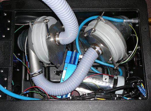

Mytee uses the hi-perf 3 stage vacs. They are 556 AirWatts each in parallel.
John has promised me a Breeze with Dual 6.6" vac motors in series . . .
so I can also test them on the carpet.
You can fit two 6.6" Ametek vacs,
and 700 PSI Cat pump system in the Breeze that John is building.
This was a Breeze with dual 8.4" larger vacs and 400 PSI pump system:

Gees dual 8.4 vacs
Im looking to maximize power using 2 cords no heater. Capable of doing tile n grout and carpet with a long hose run (min 75 ft) and a pump out system. The longest hose run possible while keeping my combo.
Im guessing the dual 6.6 and Cat 1xp will be my combo?
Thanks !!
Ive considered the Goliath 4 vac system 2 in series and 2 parallel along with the 1200 psi Water Otter .. but Id either have 3 cords to monkey with or a super long pressure line running from the janitors closet (which is where Id plug the WO into) all over the areas to be cleaned which could require 150-200ft of line
