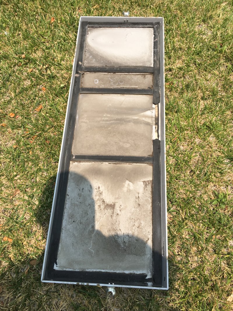

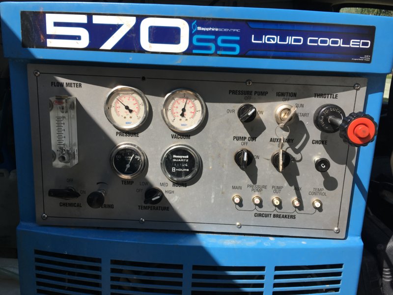

Ok I've been messing with my relief valve forever.
It was set to 12hg originally and with a 100 feet of hose it would go to 9-10 hg with a wand on the carpet.
I set it to 14hg and with a sealed 100 feet of hose or a wand on the carpet it sat at 12 hg.
After awhile it dropped again I bought new hose cuffs and changed filters and tightened up my relief valve again this time setting it to 14 hg's with a 100 feet of hose sealed that helped for awhile.
Then it dropped again a week ago down to 10hg???
I opened up the lid and sure enough 2 small holes in my gasket.
So I ordered a new gasket in the mean time I glued the 2 spots with a glue gun so I can work.
The gasket apparently has been bad for awhile
Because when I sealed the machine at the truck with my rc99 filter and 6 feet of 2.5 it shot to 20hg and the almost stalled.
With a 100 feet of hose and wand on the carpet it sits between 14-15 hg and hot damn if the carpets aren't dry and the machine is hotter and it cleans like a mother.
I think my gasket had problems all along.

Can you show us a picture of your gasket and how many hours are on your truck mount?

Sam you can easily make a better gasket. I use the black polyurethane in the caulk tube. Clean it throughly then wipe with acetone. Spread the polyurethane then cover with wax paper. Put the lid back on and press down. Don't start the machine, just use your weight. Wait about 4 hrs or over night and it's good to go. The wax paper won't come off but easily the excess tears off. Don't get the stuff on your hands, it's permanent once dry and will have to wear off. My filter box is on its second machine with only a small touch up of the poly.
11,551
Sam;
Sorry to hear that.
How old is your Sapphire 570 ?
What caused the gasket to fail ?
19 months wear? I have an inline filter and don't open except to clean the blower filters.
But sometimes will use the tank filter at the end of the day. Just use.
