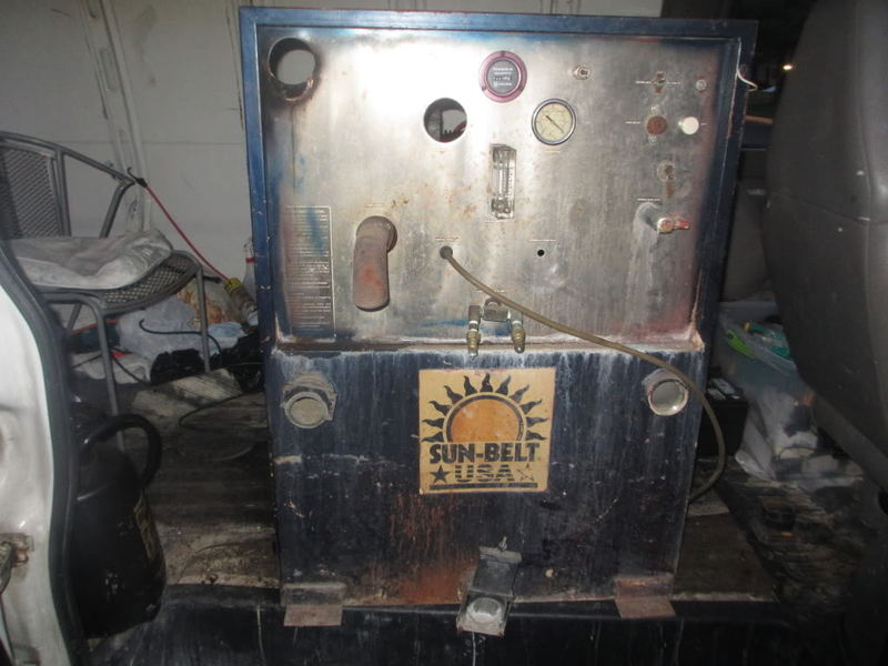

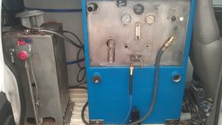

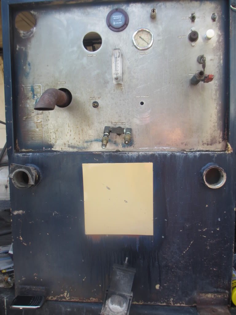

Here's an update on my TNT that I picked up in a consignment shop for $2000 bucks w/ heater. It was sitting there for 5 years and had 4400 hours on it (Craigslist ad said 500 hours).
This is what it looked like when I picked it up:
Had never done this work before, I decided to take on the challenge on my own.

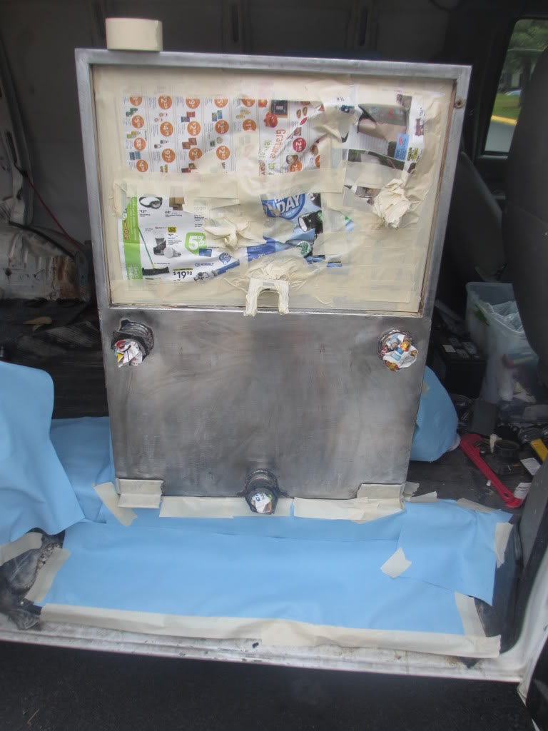

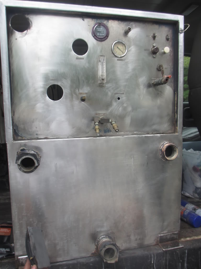

Cleaned it up

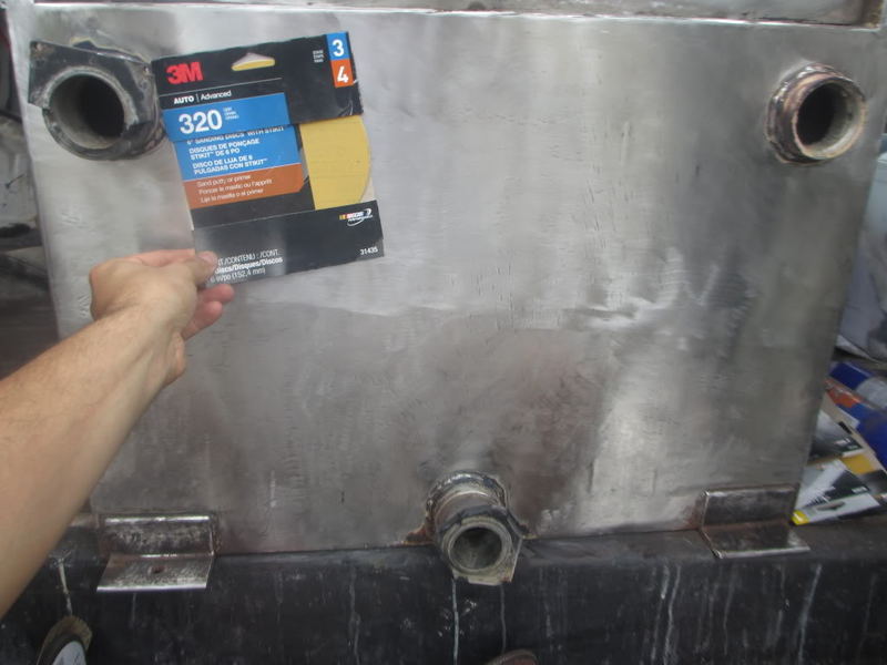

Sanded it down (down to 80, 120, 180, 320, 600, 1000 wet)

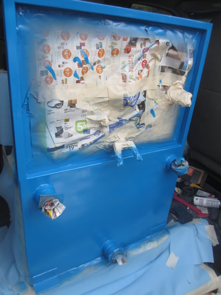

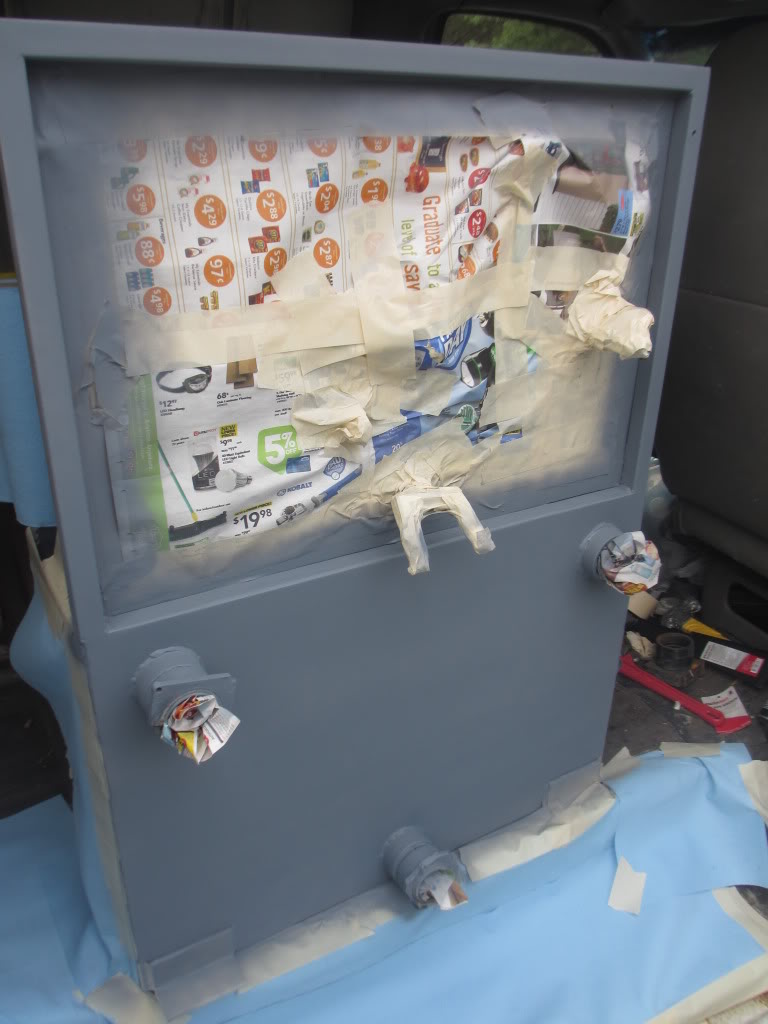

Primed
Painted
Installed

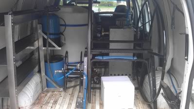

Installation by Sunbelt in Raleigh - w/ Rokan 300 electric vac reel, Rokan 300 live sol reel, Rokan 400 live sol reel (garden hose) on left rear door, stainless shelving, 100 gallon poly vertical tank, water softener tank, n 3HT w/ new coil.
A lot of work has been done to the machine to get it back to running conditions, it's been a work in progress even after the installation @ sunbelt, but I'm glad I'm finally to a point where things are working well. I'm using the 4 to the door 2 inch to the dev large filter than 2 to the VT14 w/ #7.5 flow @ 400psi, getting dry times in the 1-2 hours w/ 1 dry pass, if I do a 3 level home, by the time I get to the basement the bedrooms are fully dried w/out fans, with dripods they're dry b4 I leave the house.

Elecric hose reel, fresh water tank, on board water softner, live soltution reel, 3ht, and all stainless steel construction.

How much time did all those sanding steps take ?
Any concern about the bottom of the tank ?
Was that recovery tank regular steel ?
Glad it is performing well for your application.

That was a very nice restoration job.
Thanks, it was my first time doing such thing, just took my time, researched it, and gave it a shot.
Too much time, if I had to do it all over again, I would've just used this paint remover:
http://www.youtube.com/watch?v=oPKGRdeOVwo
Which I would've used if I had known of it before I sanded the machine down, I only sanded the front as the sides and back will not be shown, the front was the most important being at the client's home, etc. I actually have that product in the video but have not used it yet, I'm looking fwd to giving it a try, if it works as good as the video says, I will do other projects w/ it and not have to go thru all that sanding again.
No
Stainless steel. It looked like it was repainted blue, but prior to that it was an off tone yellow.

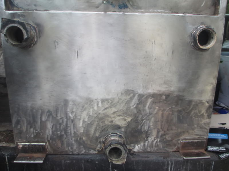

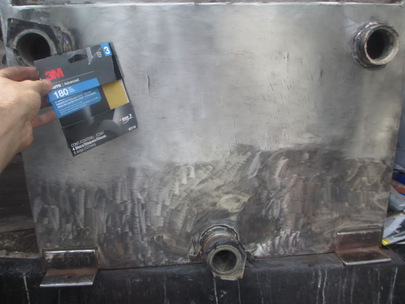

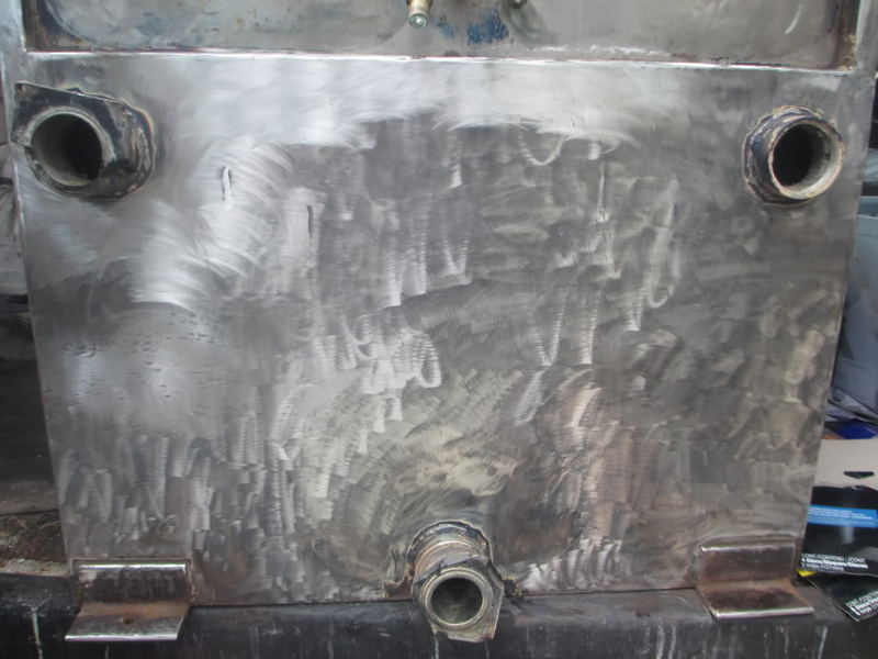

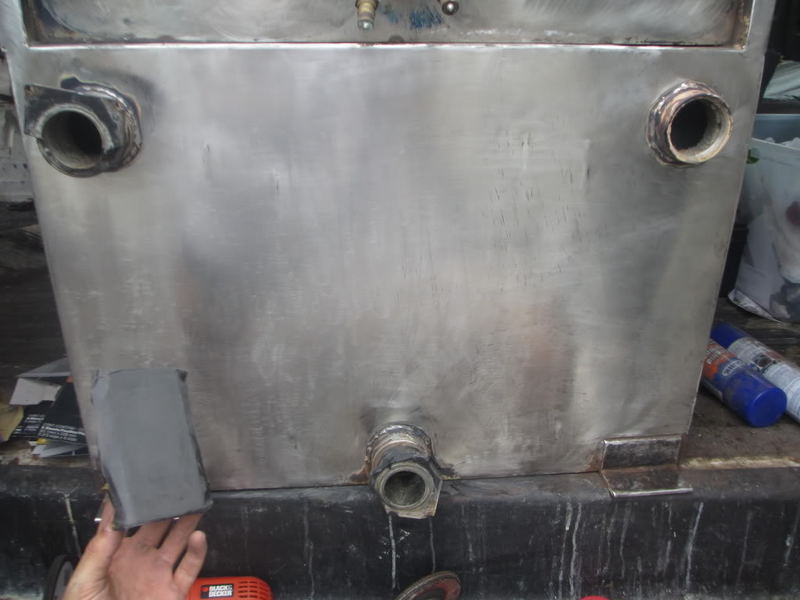

I documented each step I took so later I can go back and see what I did as a guide:
Keep in mind this is my first time sanding something like that, no prior experience if it doesn't look eye pleasing on the grits.
80 grit
120 grit
180 grit
320 grit
600 grit
1000 grit
Later on I used a scotch brite pad (dark grey/black) on panel, but it's tough since I was not sure how to remove the switches and everything else so I just did it around it all. I was planning on painting the panel as well but decided to just leave it like this as I didn't want the paint spray to get on the gauges, etc.
