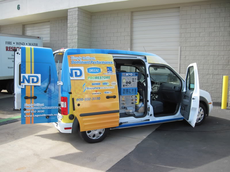

Guys I don't know all the answers im just try to see what works.
Pros:
Low entry price. $10,999.
16.5 hg
300 cfm
1000 psi General pump
Very low maintenance cost
Low parts cost.
Quieter than most TM.
Not marry to the van like a pto.
Aux electric power when needed
Remove gen when replacing van or sell with van for up charge
No long lease payments
No power cords to plug in fast set up time
Makes it own hot water no propane needed.
70 gpm pump out
Cons
Generator is $5000.00. However it in the initial price of $11000.00
Uses fuel. Truck run at 1500 rpm
Not as powerful as a Vortex however powerful enough to do the job.
Limited to about 200' without a booster
I may have missed something.
Lastly I would say this. This is not a portable. I think of it as a hybrid electric TM.
I agree with Richard it not easy to get the mind around it but I see it as a way to clean carpets fast and economical. Let the machine work for you instead of working for the machine. It's a far cry from a $30,000.00 unit.

Here's an example, look at a locomotive, they use DIESEL engines to generate electricity to power ELECTRIC motors in which to drive a TRAIN!
So in theory, John just may be onto something. The gas engine to drive potentially even more than one generator,perhaps. You COULD actually create An electric MonsterMount. 600+? CFM.
You would not be limited by how much power could be transfered by the clutch of a PTO before it starts to slip and burn out the clutch.
Also Consider, Say, Ford Transit Connect $20,000 + Johns LectroMount $11,000 = $31,000
Butler PTO = What? $55-$60,000
Also the fact that the ETM would also be easier to work onthan most truckmounts. Also the thought of a Van powered truckmount that could be swapped to a new van relatively easy, sounds pretty cool too.
Plus the fact that, there is the potential of plugging in on some jobs if you wanted to. With a regular truckmount you will not have that option EVER.
Just my thoughts..
