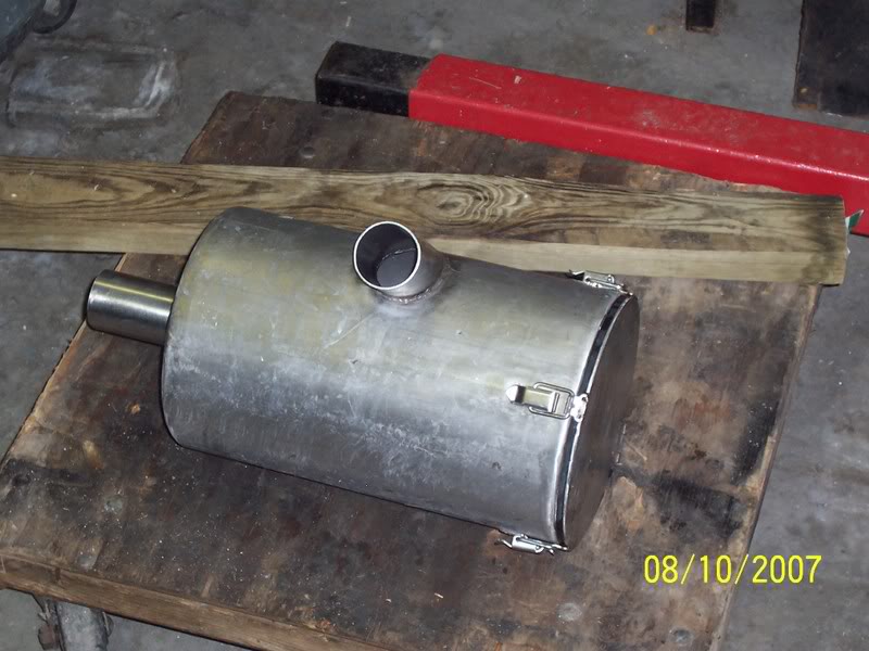

This is a box built by John's that is on their website.

yeahs whats wrong with just an intank filter box, the one on my prochem works great, just pop the lid off and pull out the metal mesh filter box, any filtering setup should involve a metal mesh basket, looking at the pic of that new tank, without seeing the bottom, how does each one of those seperate tanks drain??

the filter Bob described above reminds me of the PowerClean version I saw on Jim Bethel's setups.
My filter traps soil on the "outside" of the filter rather than the inside. Very easy to pressure wash off the junk without getting my hands into all that junk. I have a large in-tank filter which I hate touching, all the hair sticks in it, its hard to clean, taking a few minutes rather than a few seconds. I usually have to clean a lot of the hair and lint with my hand.
Bob Foster
8,870
Ron take some 120 grit sand paper and sand the inside of that box and remove some of the burs around the stamped holes. Then it will rinse easier.
