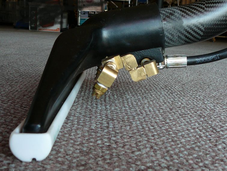

This is the 4-Jet setup that we modify on the Bentley.
Jets can go even higher if you want:
The cast metal head outflows the CMP 14" (aka Greenhorn) wand easily.
I've asked Michael Lockhart to bring in one of his PC Titanium, for a side-by-side test.
Larry

LOL. Why aren't you using the "new" manifolds?
Edit: and what does this mean in the real world: "outflows the CMP 14" (aka Greenhorn) wand easily"
cause I didn't notice any improvement in dry times even when compared with a 12" AMF ebay wand

I would like to see the other end of this photo to see how high the wand handle is lifted to get the jets that high off the ground.
