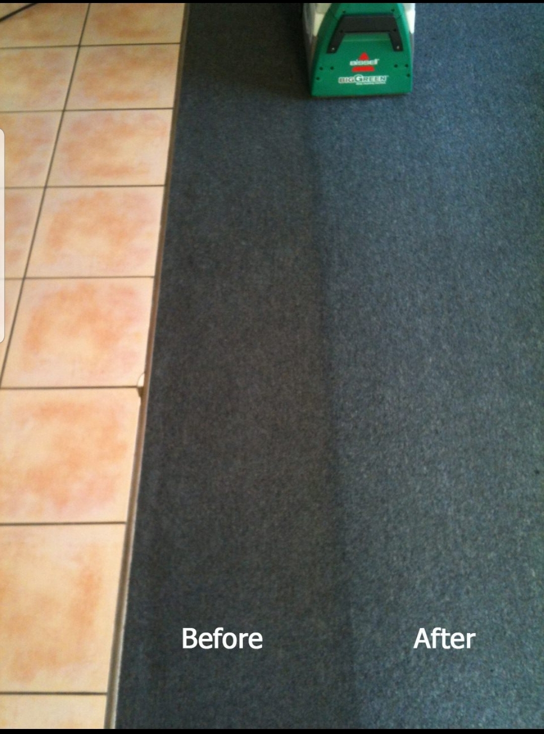

if a carpet is visibly and evenly soiled even outside the main traffic lanes there is a good chance of a residue from previous cleanings.

the even soiling in the before shot suggests a residue problem
the machine they proudly show in the after is most likely the cause of the residue problem Screenshot_20191002-235211_Trade Me.jpg
