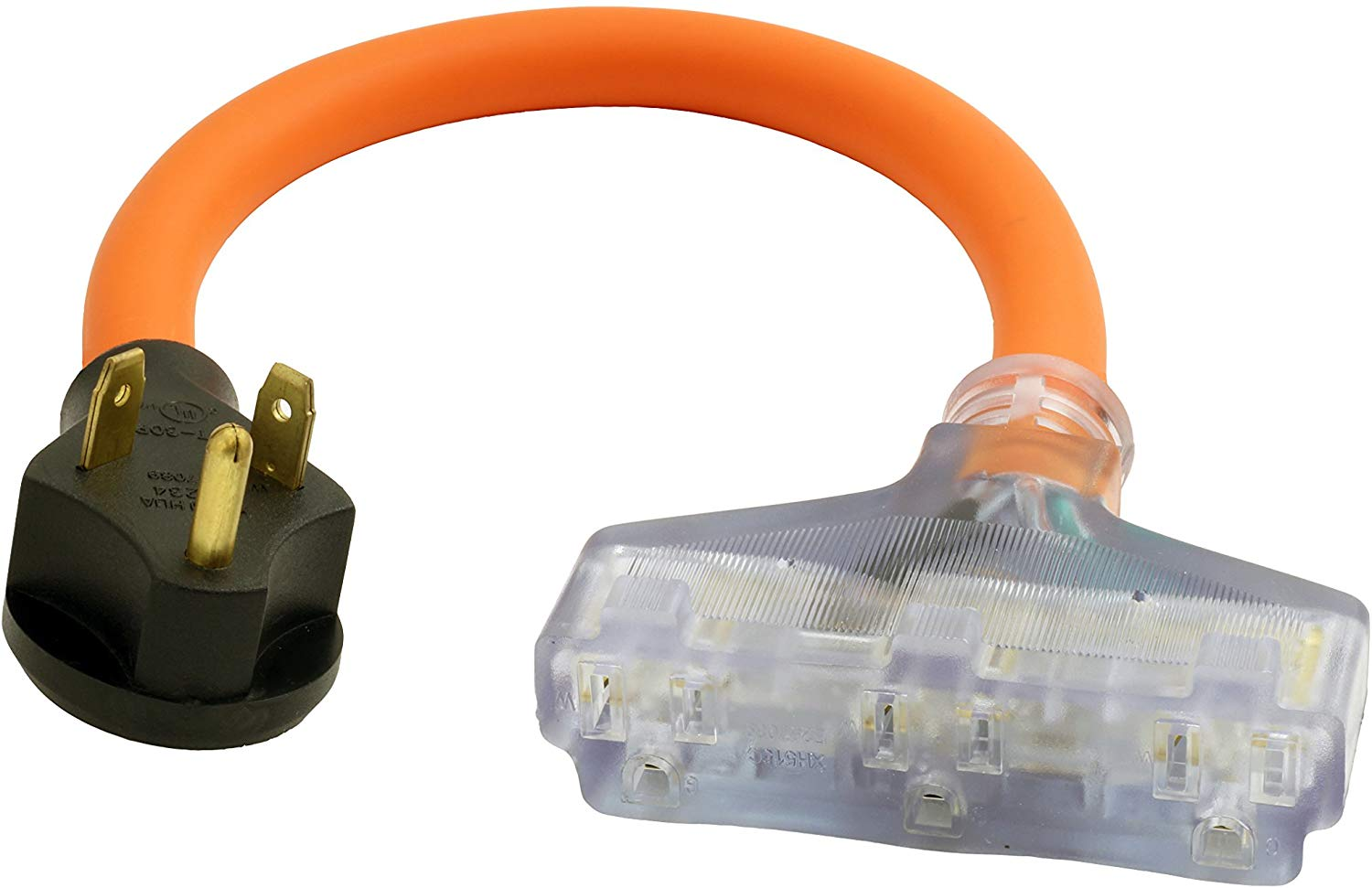

Do you have a 220V splitter box? This helped me greatly when I was a proty hack.
I've never heard of them. It still goes back to the same plug/circuit. Kind of like at the office desk where I have 5 or 6 things plugged in. How do they work to stop the overload of a circuit?
It allows the use of the 220 v circuit for 110 v devices? More amps available. Great tip.
