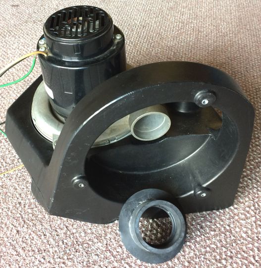

Total lift with 2 of these vacs is 170" .
I'm guessing they are 110" of lift each.
So the Series spec is ~ 180 CFM with 170" of lift
vs
Parallel 340 CFM with 110" of lift.
The key is that the lift and CFM drop less with these AirWatt vacs than other 6.6" & 5.7" vac arrangements I have tested.
Most of the customers testing the new Breeze state that it feels like a entry-level TM.
I do have a manifold that will series mount 2 of the new vacs with no connecting hose:

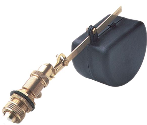

Here's a new idea to include on portables: a tiny float in the fresh water tank so it shuts off instead of pumping itself dry. The 2lbs of float would be well worth it. I hate it when I run it out of water. It's hard on the pump and wastes time re priming.
14,608

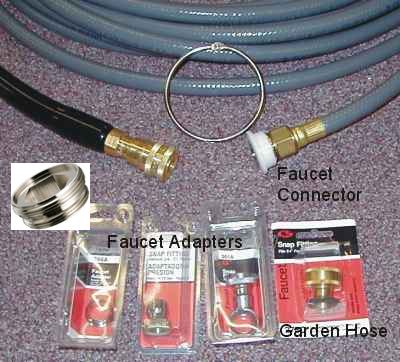

Can't you hook up a water hose? If not, I'd invest in a setup where you could
