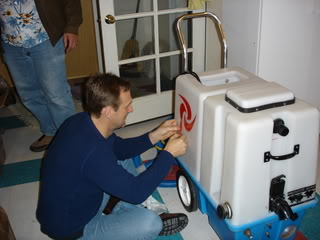

I'm thinking that it's positioned well to fill the commercial niche. What do you guys think? Configuration? Colors? Name? Price? Let me know what you think. I appreciate your feedback!
good move Rick
can't give any real world feed back as far performance (I'd rather have my eyes poked out than to have clean anything but upl w/porty)
so I'll let the guys like Willy with nutz 'n bolts experience do the performance/longevity part .
but know enough to say a porty, wand and upl tool offers MUCH more utility and versatility to the com niche guys compared to the Steamin Demon ..which ain't "all that" IMO:icon_rolleyes:
the ability to clean upl (not rub on it with a angle grinder or car wax buffer) as well partitions and such will be welcome to many, I'm sure .
a light nimble wand makes quick work of tight areas, under desks, etc that never get touched wth OP, Cimex or self contained portys like walk behinds and Steamin Demon
the name is monkey sheeit marketing ....but no biggie in reality, cause only morons will think it's more than a porty
Colors are nice and cabinet has nice eye appeal
on the practical side, I've always considered the portys that open like a clam shell to be the best design .
You did well there
It allows for quick access to components for visual inspection and/or repairs, as well as the virtue of rocking back the waste tank for quick easy rinsing as the water and crud naturally flows right out the dump port
don't know enough about price/value aspect of portys to have an educated opinion
but just adding a porty (and not a niche porty like Steamin Demon or walk behinds) to your line up is a good move in general

I wonder if it comes in other configurations. Like NO auto fill/ drain and no heat. You can almost always get hot water on the job and unless you can stick it in a janitor closet auto fill/ drain scares me about leaks. (OK I worry too much)
I'm ASSuming (maybe wrongly:redface:) that you don't "have" to use auto fill/auto dump to operate it.
if so, much of the utility goes right out the window if the "need" to be tethered to fill and drain hoses is required
I'm also assuming the heater can be on or off (or I'd hope so)
if either of those assumptions are incorrect, I'd STRONGLY suggest the unit be revised
Auto-Fill / Auto-Dump is not a standard feature. The price for the base TruckPort with 500 PSI, Dual 2-Stage HiFlow motors, and 2000 Watt Heater is $2250. The price for the model with Auto-Fill / Auto-Dump is $2988. My thought is that the base model will be the most popular model. We've sold Mytee, Kleenrite, and Windsor extractors, and from our experience - 500 psi portys with heat have been the most popular configuration. That's why we specced the TruckPort with these features since it seems to be what most guys are looking for. Simple, effective, affordable.
We are not currently offering a TruckPort model without heat. Maybe we will add other configurations at some point down the line. You could always just turn off the heater if for some reason you don't have a need for it, or if you have severely limited current.
