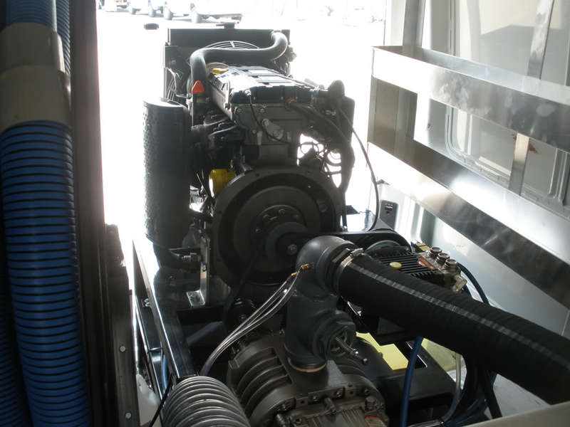

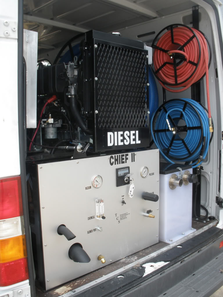

Here are some pics TCS sent me awhile ago..........ITs the first install of a diesel model..... They stated........... This is how the customer wanted it set up.. There are other install configurations that allow more room to be in the van... Also, this pic was taken awhile after it was installed..

Hose reel position sucks.
And it's right next to the burner.

That's on my list too Jimmy. Love the stove pipe.
I've got a big Kero heater, would hate to burn regular diesel in it for very long and try to keep the van clean.

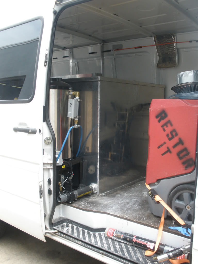

We ran one of our 405's out the back door like that, with vacuum hose reel on one side of it and slide out utility rack (16"x48") on the other side.
I had no problem with it but I was a little uneasy with the potential for it to get squirrelly if the on bad roads in bad weather, especially when my sons were driving on road trips with it. I'll do it again with a dually next time.

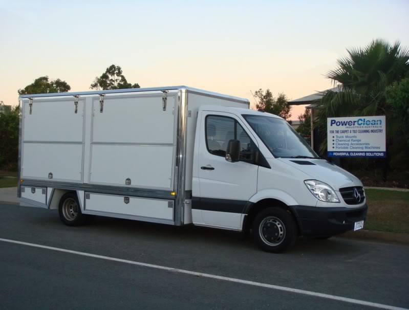

Is it dually? Otherwise a large percentage of gvwr behind the rear axle. You can't tell without actually driving in the kind of situations I mentioned.
I found it acceptable, but I was always conscious of its handling characteristics and compensated for it. Good tires properly inflated, and avoid sudden lane changes, among other things. Didn't feel comfortable chancing one of my young son's family future on my layout design.

Diesel truck mounts have suffered from vibration issues. How has tcs addressed this? Even with a smooth running diesel it can be a problem.
Got to love the single fuel source. Bet it gets HOT!

It may not be that heavy, the 405 has a much bigger motor 900#. 26" wide unit. I moved it back to the side door in the new van.
I really like the diesel vans, our 7.3 Powerstroke Fords beat the 5.4 gas hands down, and get better milage. Would have been a great candidate for a PTO version.
Is that Sprinter a dually? Pix don't show enough to be sure.

putting more weight over the rear axle isn't new, twas thought of 3 yrs ago and designed.
Leaves the middle of the truck available for mixing station, chems, tools etc.
makes for a very balanced truck and load, except for the shift in weight between FW and Rec tanks

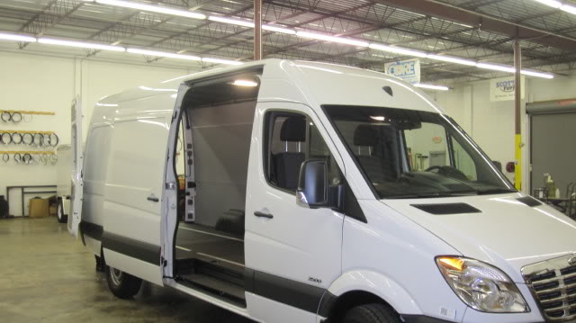

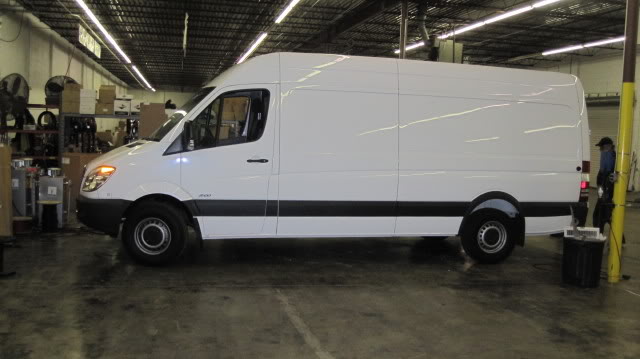

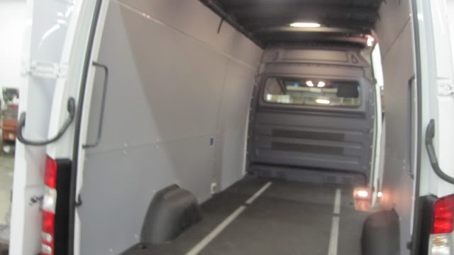

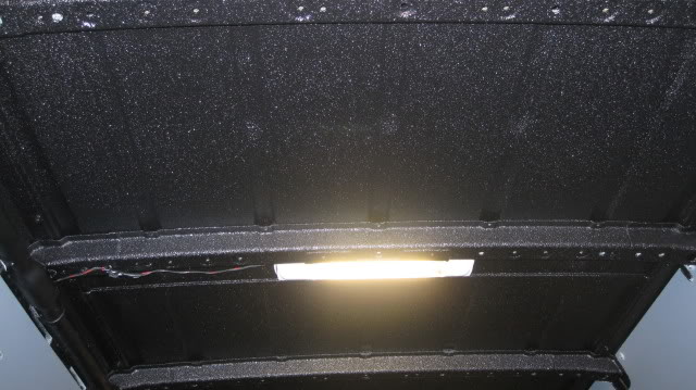

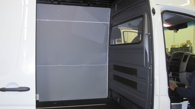

We just got the sprinter back from linex . We had the floor and up past the wheel wells plus the ceiling.
We will start the install next week.

The cleaning performance on this machine should be as good as anything. It is tight in that van though. Too bad you couldn't get a Sprinter with a little wider body.
