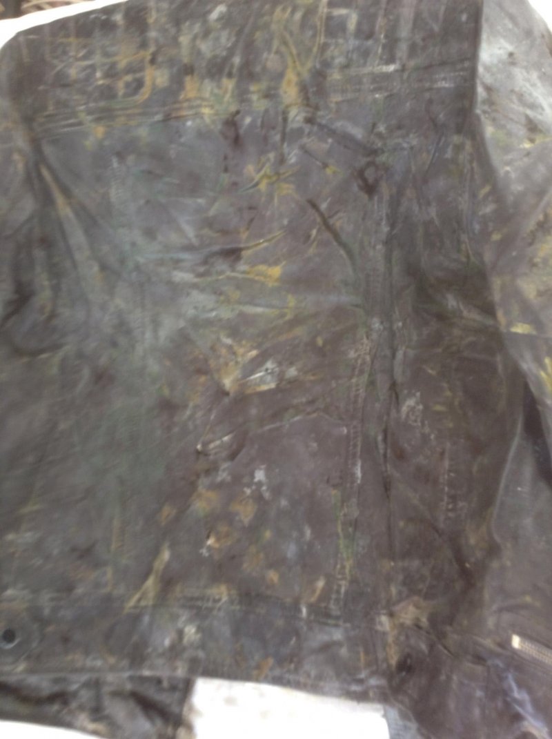

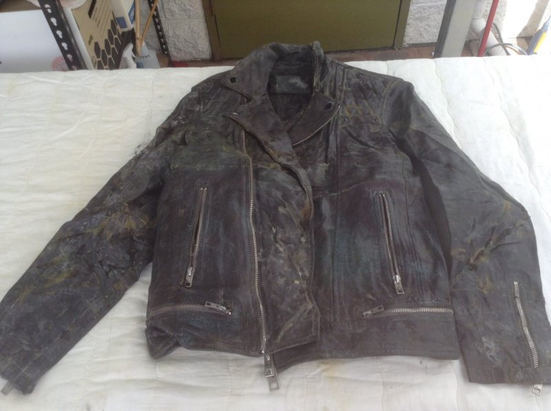

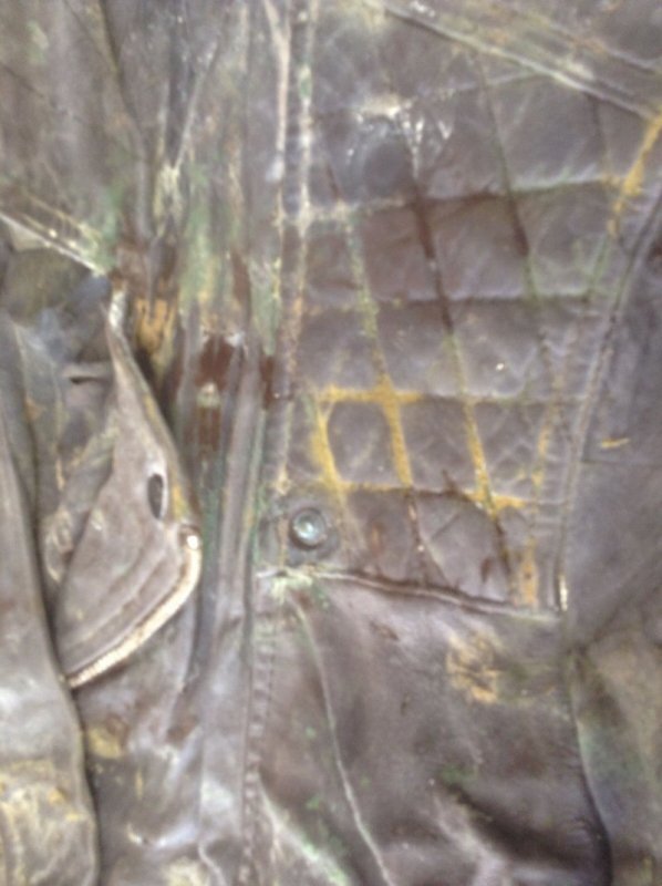

Leather clothing with mold.
This was dropped of to me to clean as the (several) local dry cleaners would not touch it.
As you can see, mould spores are very prevalent.
So bad in fact, that the interior lining is rotting.
I did suggest throw away & replace, but the overseas gent say's it's a family heirloom and wants it restored.
I'll do my best with no guarantee.
Sorry for the poor picture quality, the pics were taken with my Samsung 7 phone & I still am not familiar with it, but now that I'm on my pc, at least I can rotate them.

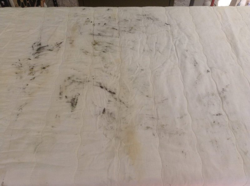

One pic (4), shows a mattress cover that was clean prior to placing the jacket on it for photo's;
No pressure was applied, this is just to demonstrate how easily the mould spores attach to other items.
I'll post more pics when I'm finished, PROVIDING he gives me a waiver to remove the inner lining so I can treat & clean the interior leather.

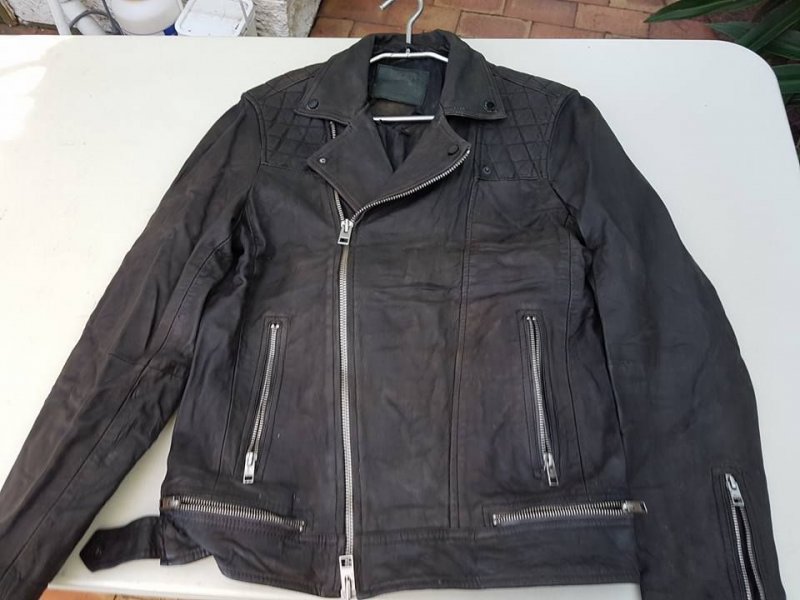

My normal charge to clean, deodorize and nourish/protect a leather jacket is around the AU$100 mark, depending on leather type & problems.
This particular one will be around AU$200. because I will have to remove the interior lining, treat the interior leather & also spray a black pigment/sealer over the entire exterior of the jacket.
Here it is part done.
