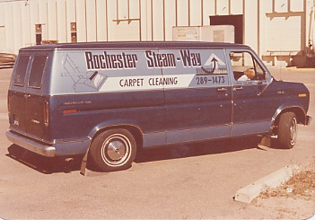

My Minnesota van in 1977

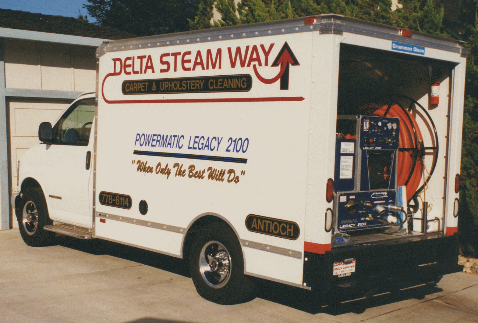

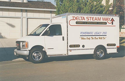

My Antioch California 1997 van.
I have no clue why you guys use vans when these are available
Other than being a little higher those box vans are about the same width and length as a regular cargo van.
Of course I understand cold climates changes the appeal. My Minnesota van fit into my heated garage.
