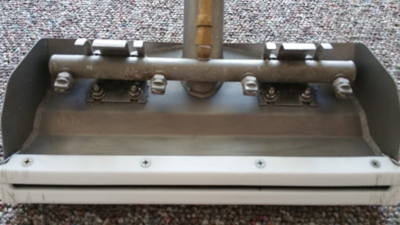

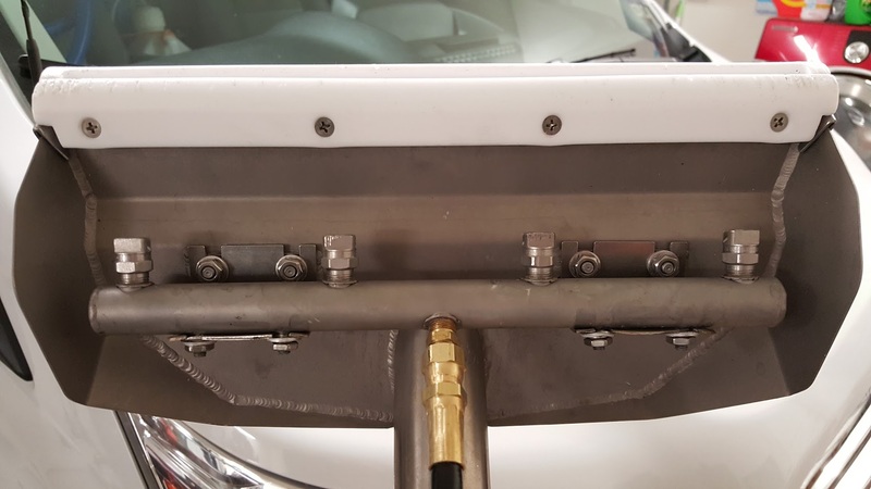

Seriously the more I use this wand the more I like it.
The manifold is super adjustable which is great, but have you ever had that feeling when you're watching TV and you have 200 channels to pick from so you can never settle on any one thing? Well that's kind of how it felt, no matter how great it was cleaning, you always felt like you could make a tweak here or there.
Anyway, after using it for a while you realize there is really only 2 ways to go. Manifold way back on the curved bracket pointing toward the glide for more shear, or manifold tight up against the head for more traditional set-up.
Settled on it like this:

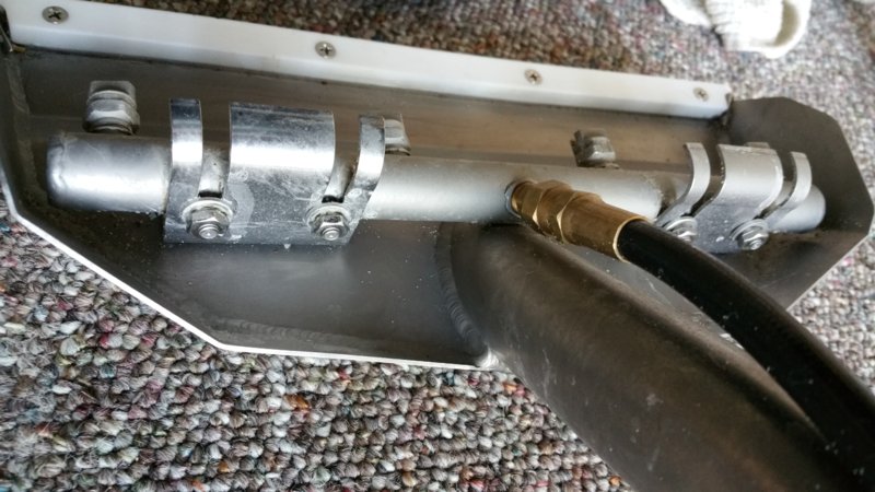

From the other angle you can see the manifold is just barely resting on the tube (the horizontal adjustment is actually bottomed out as close as it will go):
That's how I have found it to work best, but it's easy to adjust and test.
I don't know how to say it any other way that hasn't been said, but this wand is fantastic.
Mike has mentioned that he doesn't recommend it for trashed stuff. I guess that's true if you're comparing it to a rotary, but as far as wands, it cleans just as good (or better) than any other wand I have used be it 2", heavier, or unglided.
Highly recommend you don't let the 1 1/2" tube deter you. This wand in no way feels like a toy like I thought it might. Super light yet flows air like a 2" and the beefy valve handle makes it so the tube doesn't feel too thin.
Length seems perfect. I think Mike said it is 1" longer than stock.
Just an all around pleasure to use. At least get your mitts on the test model if nothing else.
D Luke
Apr 12, 2015
1,033
Derek
Better include some negatives. All that jumps out at me is:
-PMF vac adapter is high quality but way too long. Hoping to either find a whip I like or look into having someone flare the wand end to 2"
-The support pin between the lips is of course a hairball magnet.
-Edges about as well as a typical Green Glide. I thought it might be a bit better with the 2 piece glide.
-If you set the manifold back on the curve for high shear the jets will dig in to the carpet if you extend the wand way out in front of you to clean under a table/bed/whatever.

If you don't want to cut them off you could take the manifold brakets and bend them around a curved object like maybe a 1" or 1.5" object and create more of a ARC type bracket that would keep the jets the same distance from carpet but give you a more shear effect. For those that are into that.
I'm not so sure how effective the shear part is as a fiber that is 100% wet with no shear is still 100% wet with full shear.
