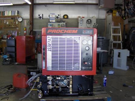

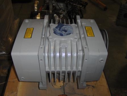

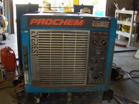

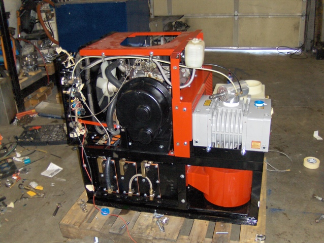

Oops sumbitted before finishing the post. This is an everest we resurrected.
These are the Guys that performed the "laying of of the hands" that brought this back to life. Bud is on the Left and T-Dub on the right

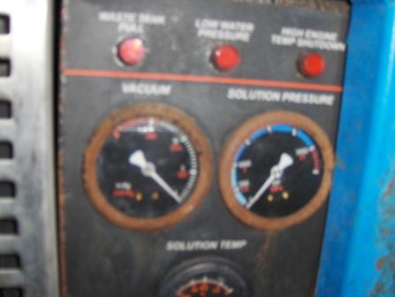

No..but it does have all new "wear" items, belts, gauges,hoses,chemical metering system etc. It is already installed and working for my good friends in Oregon. The used it for the first time yesterday and are extremely happy.

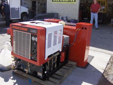

Would have if I could have got Prochem Blue Powder coat for the price I got teh red and Black we would have. We got the powder coat done at a screaming deal and the customer was ok with the choice before we did it (machine was pre-sold)

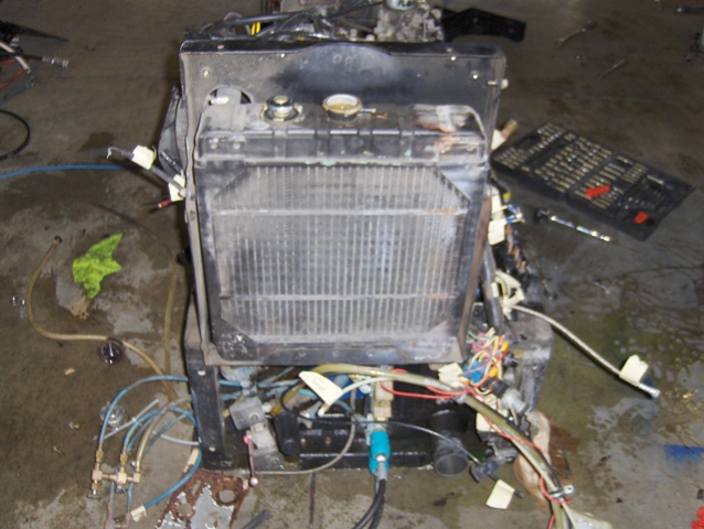

Thanks. I have 50 or more pics I just choose a few to post. This is the 3rd one we have ressurected. We will be starting a Legend Ressurection this week.

Yes it is the Nissan Carb unit.
Nice job John......You must have bought up all of Nicks red spray paint cans.

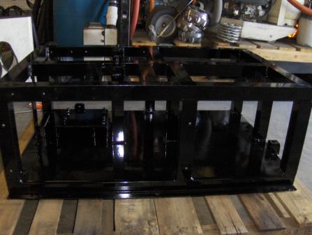

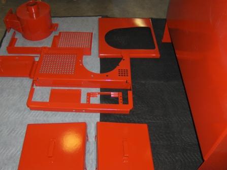

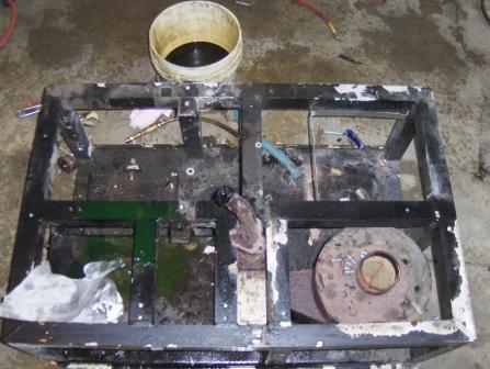

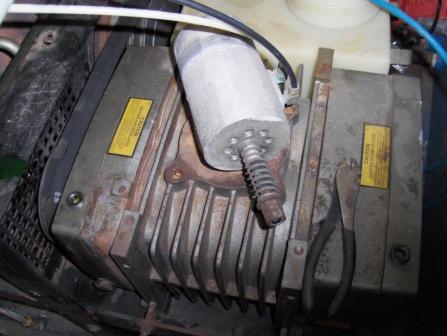

Everything except the blower and the covers where sand blasted and powder coated.
lance
Oct 19, 2006
624
John, how much would it cost to do the job like you did? Did you replace the gauges or clean them up? How much time did it take for tear down and rebuild?
John Olson
6,281
Orem UT
John Olson
We was in it about 3k of pocket (parts,powder coat and labor) so around 4k if you brought one that looked like that to us. We replaced all the gauges,hoses,belts,brass etc.
John Olson
6,281
Orem UT
John Olson
As long as the motor blower and pump are good it can be rebuilt. Now with that not all machines are worth rebuilding. The carbureted Nissan with only 4k was worth the investment.

What kind of paint do you use? Anything different for the hood?
Hoody
Oct 24, 2007
6,358
Bowling Green, Ohio
Steven Hoodlebrink
Most of that was powder coated, the only "paint" was the black on the dash, and radiator. The air filter cover was painted gray, and the blower was painted grey.
