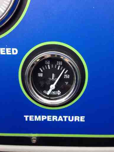

Update.... So I take it to Nashville and a great guy by the name of Chris Pond at Cleaners Depot goes through it with me. Here's what he came up with. He determined the blower was not getting hot enough so the secondary exchanger could heat the incoming water that was preheated by the van. First thing he did was increase the lift from 12 to 14. That added 10 degrees. Then he increased the speed to high (1500) The manual says to use medium unless your duel wanting or have over 300 feet of hose but he said with temps in the winter increasing it to high is needed. Then set the psi on the wand to 400 instead of 500. Then he blocked off the van port and put the machine under a load for about 10 minutes so the blower would get hot and then we were getting temps up to 220. I asked him when we clean in real world situations and have 150-200 feet of vac hose and are not closing off the vac port if we still will get those temps and he said we should. So we'll see what happens.

I'm getting good heat, even during this cold winter. I'm probably not as knowledgeable as some guys on here but I have some experience with different CDS. My Cleanco 47 is great. Butler was my first choice but just couldn't find what I wanted (used) when it was time to buy. I work alone so no dual wanding, I don't think I'd want to with my rig. Cleanco has been in the game as long as I've been alive (37) right along with Butler. Decent heat and great real world dry times while using a Devastator, my Rotovac 360i or glided wand.

It does take me a while to get there and I'm sure the temp ATW is quite a bit less. I like the Cleanco though. I'm pretty sure I'd like any of the CDS. I wish it wasn't SO COLD right now. We're really slow and I'd like to change the belts and fluids and do a proper descale (no room in my small garage). Reduction in preventive maintenance is great! Add one of the water pond type deals for reels and fresh tank and you'd have serious space, even in a standard length van.

It sounds like your 1200 is working as it should. I was going to mention blocking off the vac to heat up your blower for ten minutes. If you are sucking in ice cold air, the blower HX will actually cool the water the engine motor HXer heats. Also, this isn't a wimpy Hydramaster or a pathetic Cleanco or a gay Butler unit. Don't be afraid to turn this sucker up to 1550 rpms and 16" of lift, especially in the winter. You won't hurt it and you will increase the heat and the vac performance.
