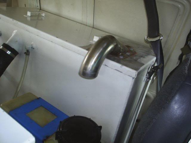

Then you have a Gardner/Denver...408 .."good blower" plenty of SUCK.. 8)
Come off the Tank with a 2 1/2 inch adapter...CUT HOLE IN tank lid...!
Then run 6 foot of 2 1/2 hose to front of unit...
Install cool -cuff...
Then run 50 foot of 2 1/2 hose on you 1st run from machine....then reduce to 2 inch...
It will BLOW YOUR MIND.... :lol:
ps RUN on HIGH...& you now own a 650....running on medium.... :shock:
"About a 350.00 mod....if you have 2 1/2 hose".... !gotcha!
