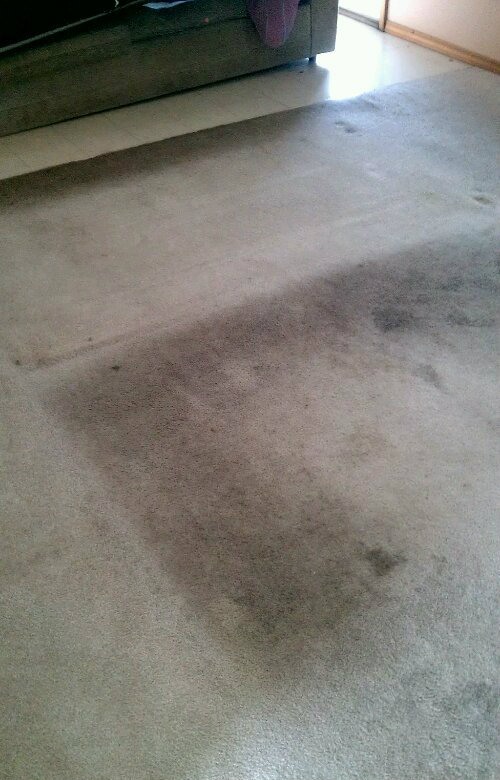

before
notice extreme soiling not only in front of but behind sofa, next to vinyl floor.

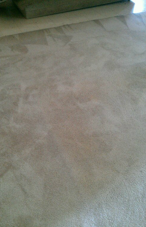

after
pre vac
pre sprayed black areas with Bridgepoint's Clean Free mixed as spot remover. pre sprayed rest of carpet with clean free mixed as traffic lane cleaner extract with plain hot water and rv 360.
yes I should have groomed prior to after photo, maybe next time.

Im tellin ya, that cleanfree is the best soap-free style product Ive ever used. Nice job
Wow, James you're truly improving their indoor living environment.
We would do them if asked, but they would pay extra for how soiled they are.

i did a job the other day that looked like that and when i asked the custy if she knew wat it was? she replied baby oil and ashes.and it was bedside. :shock: :shock:
