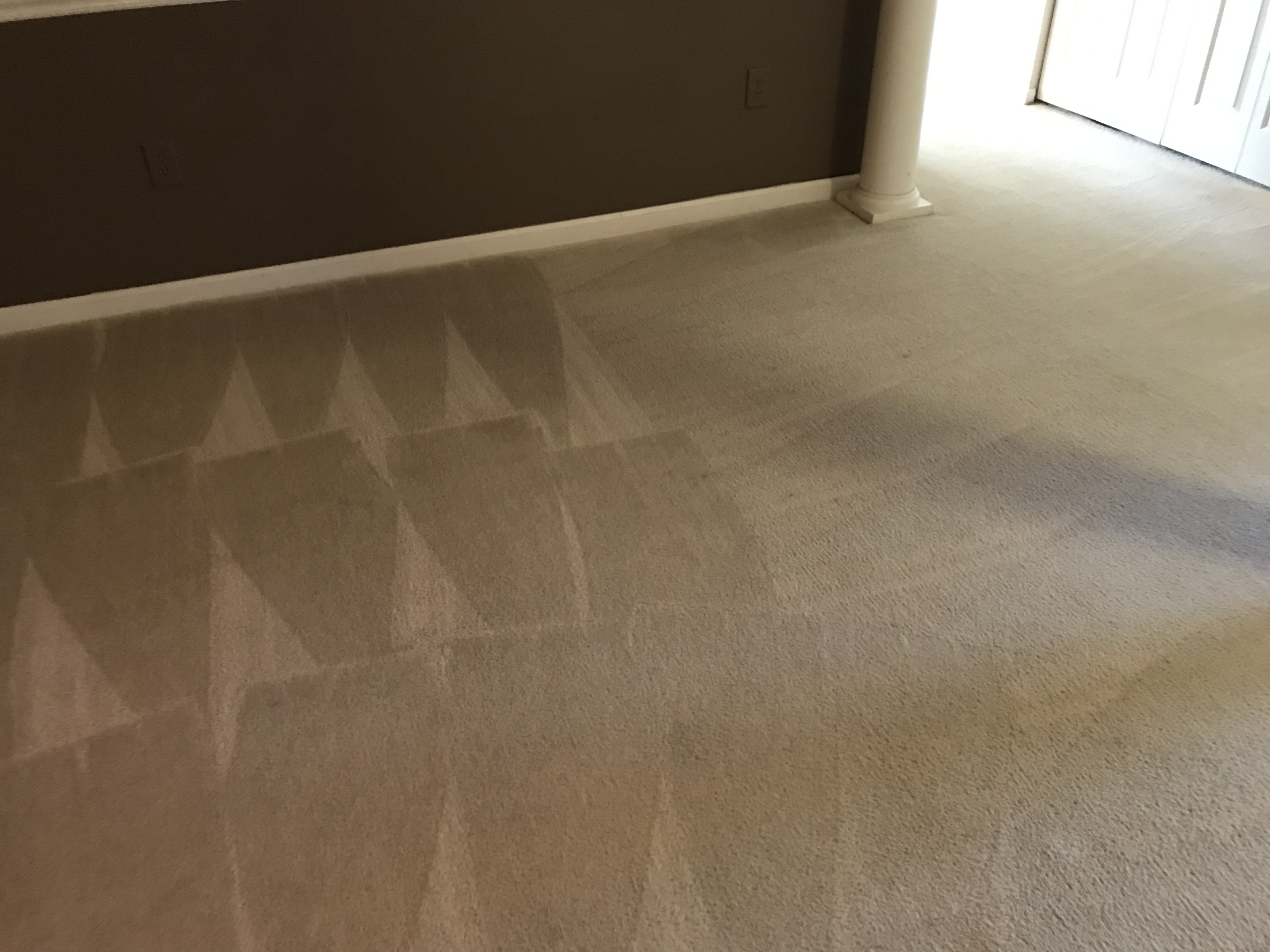

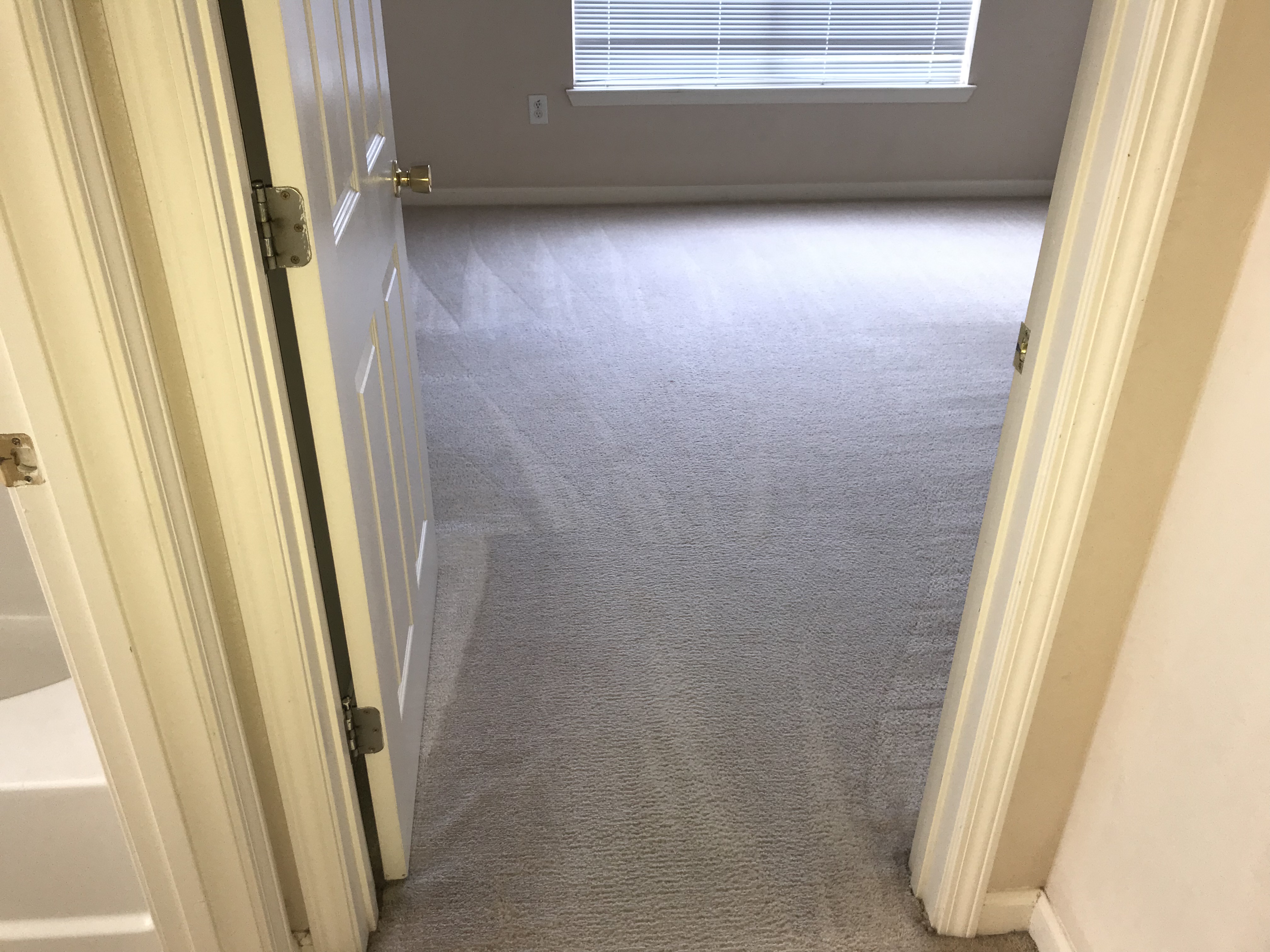

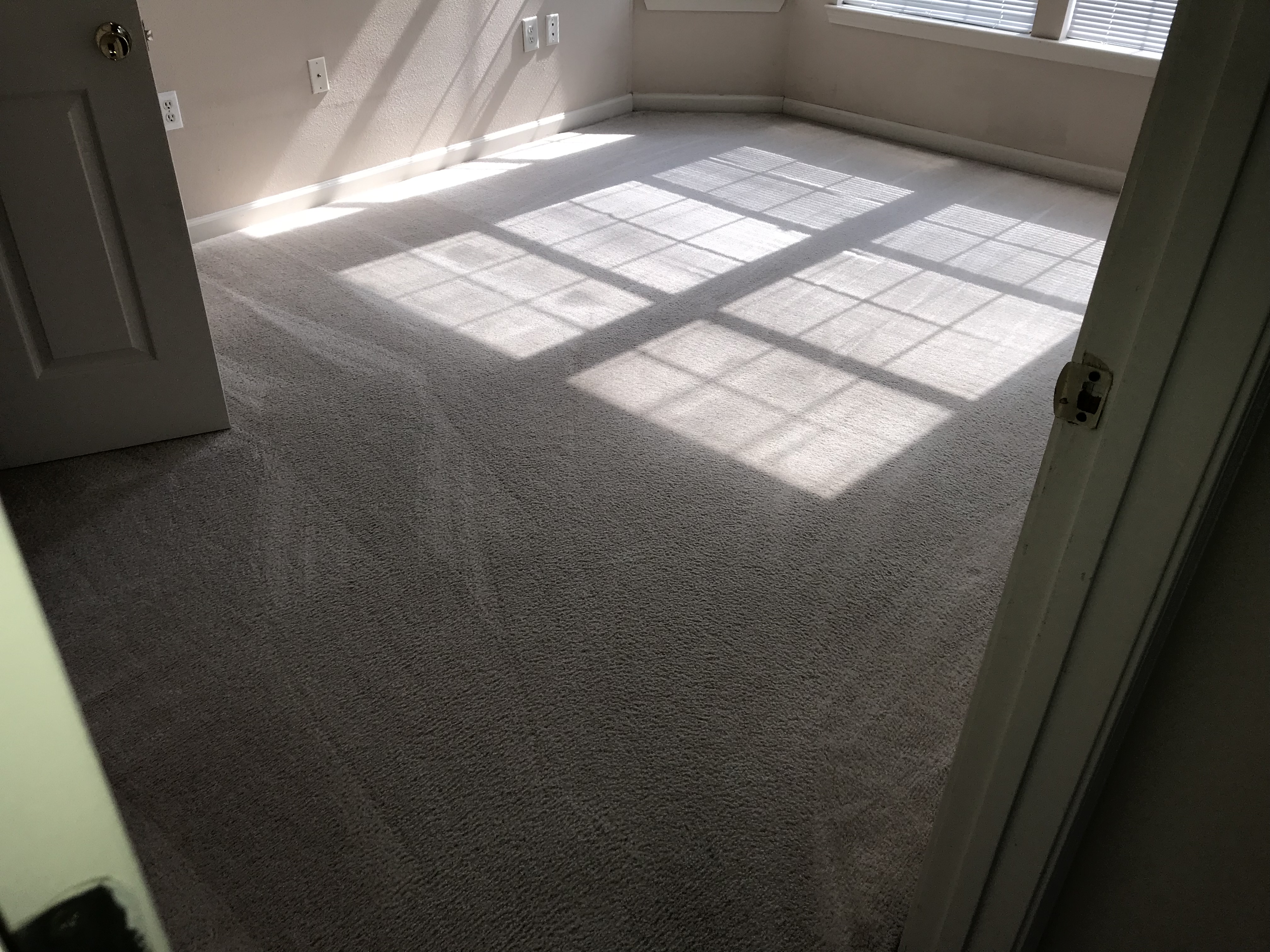

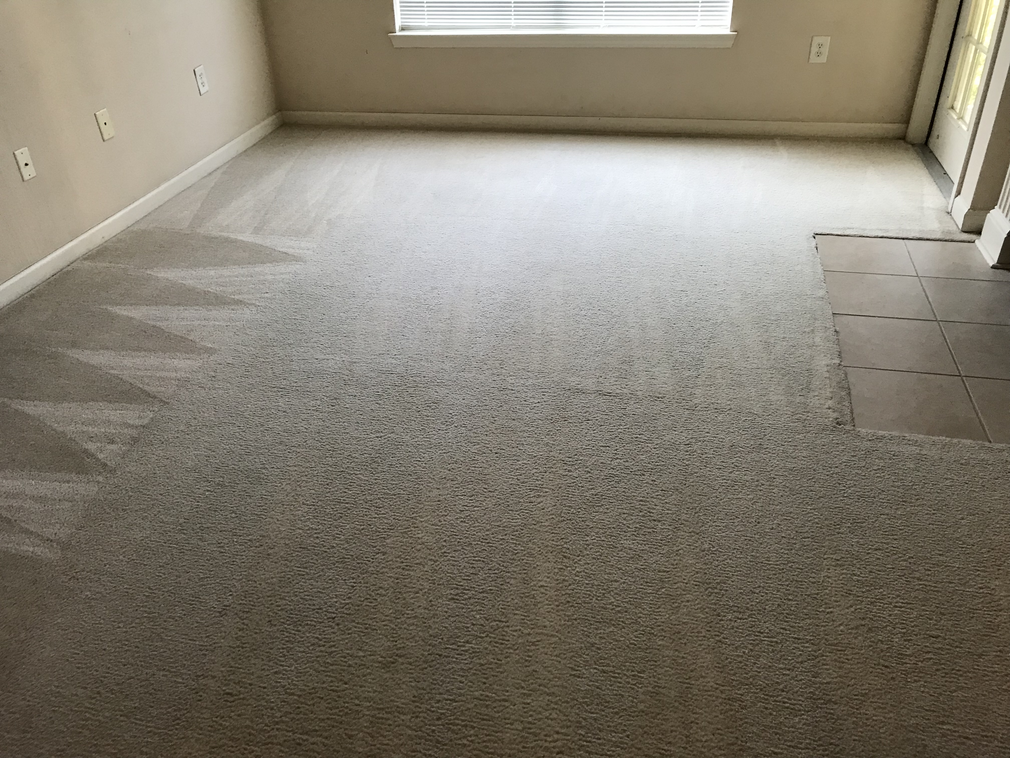

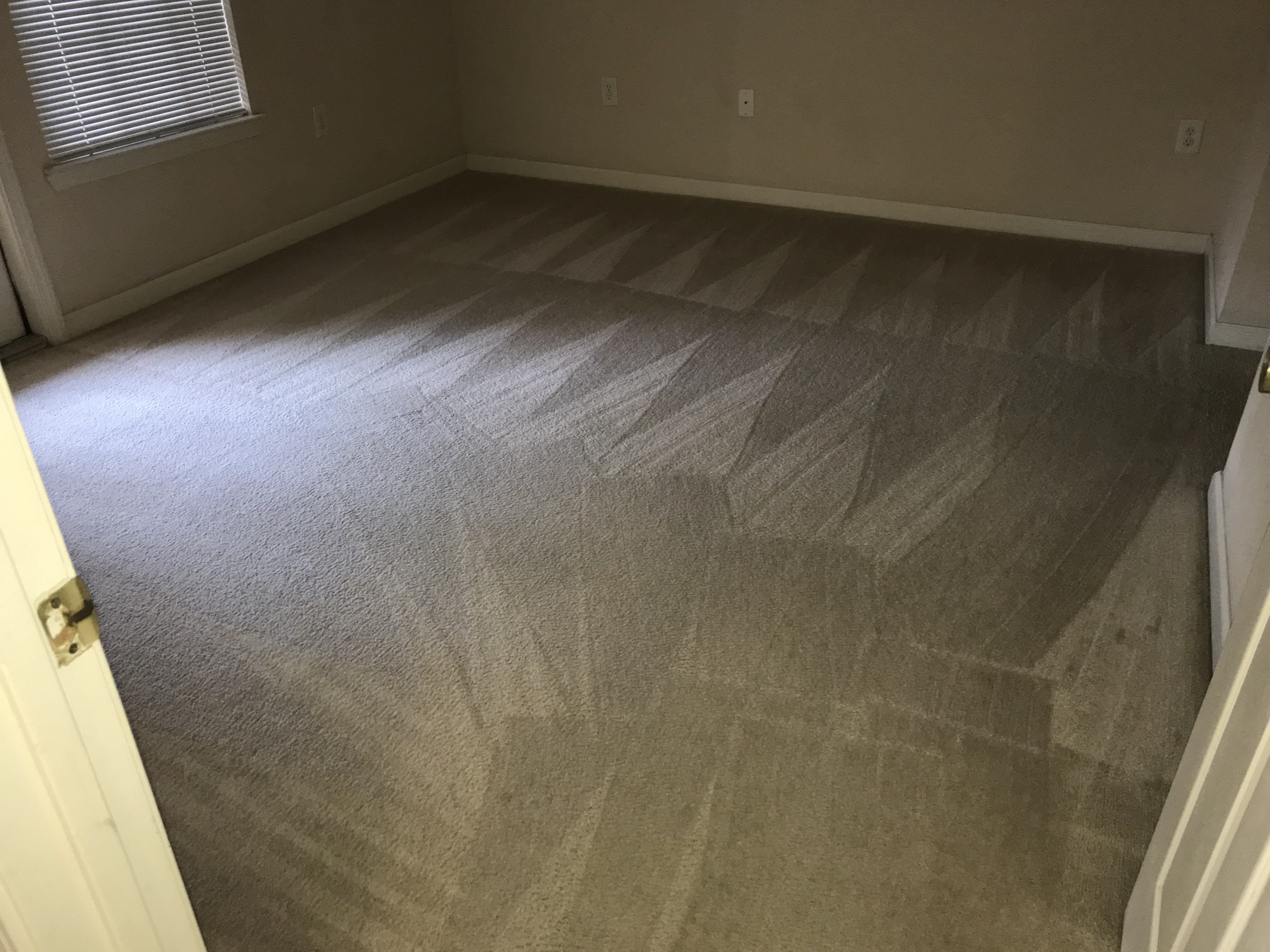

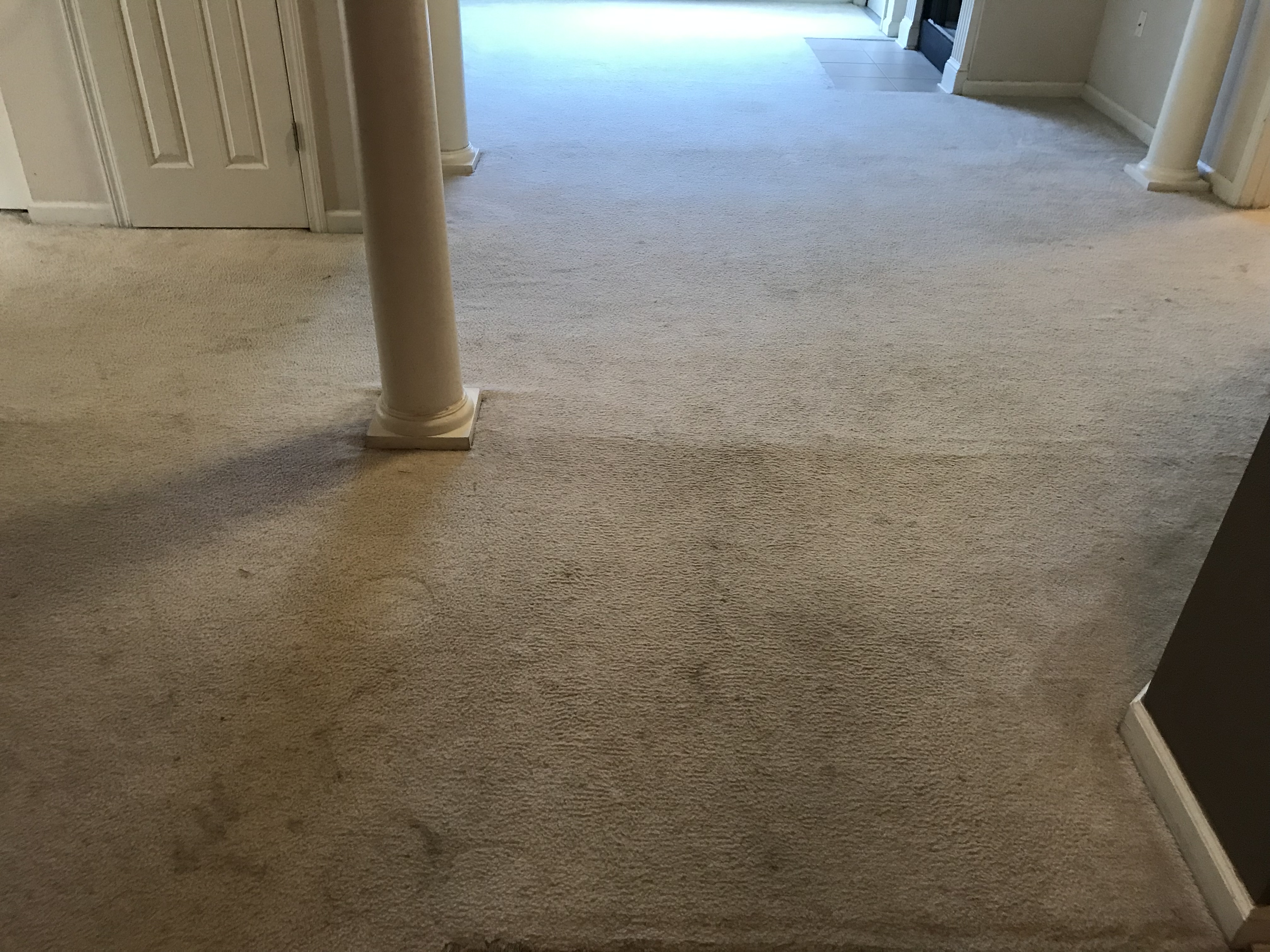

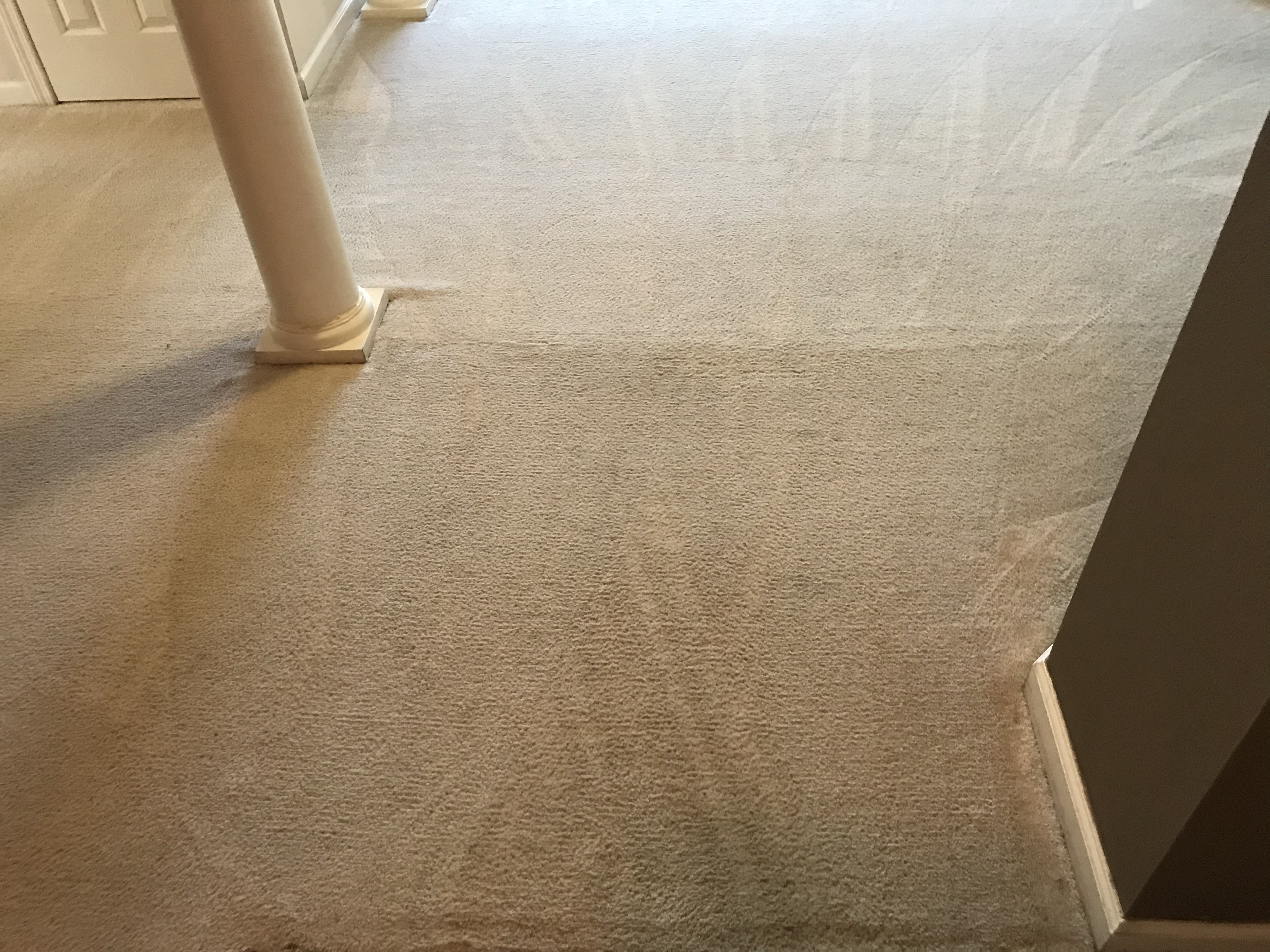

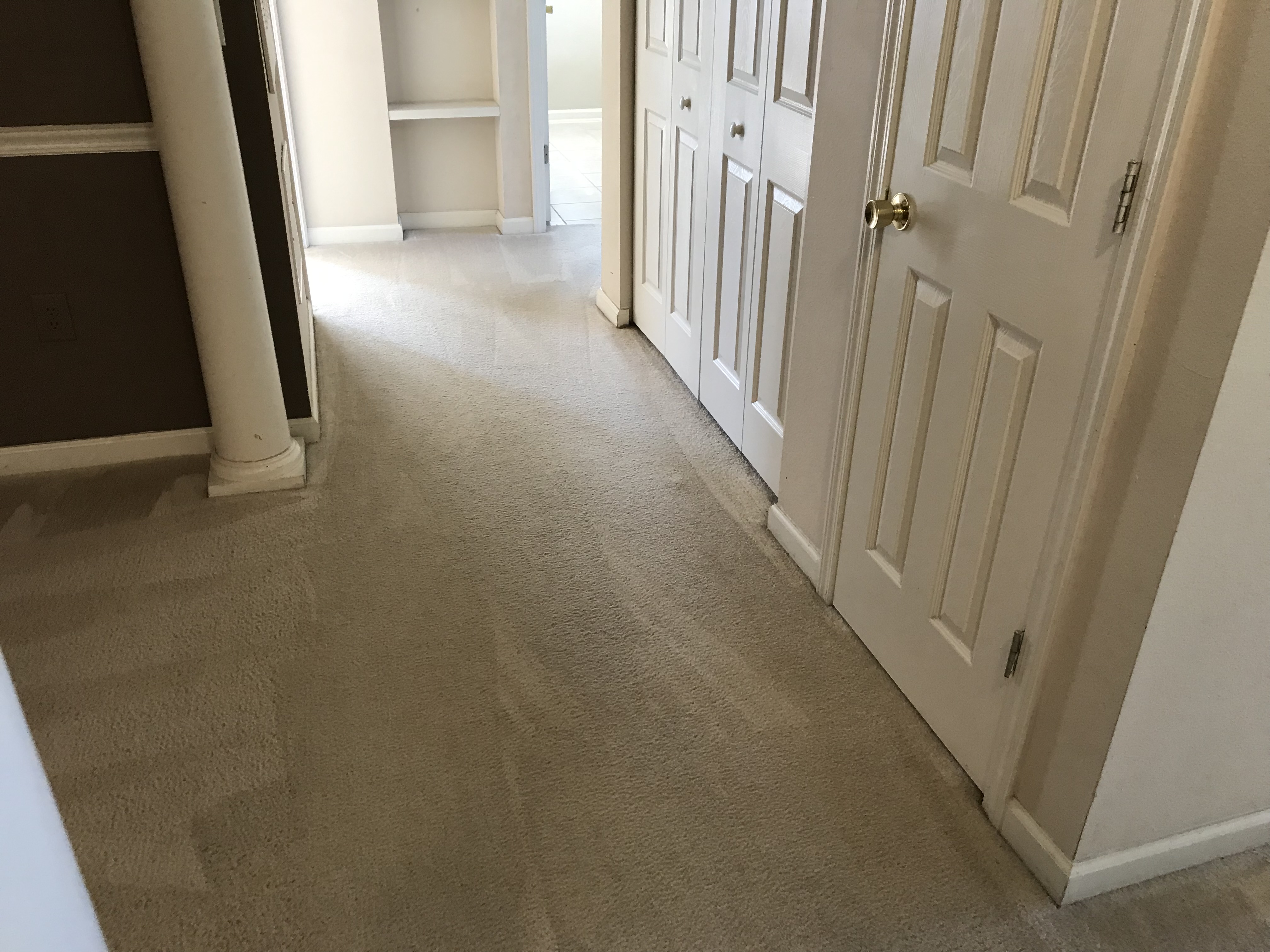

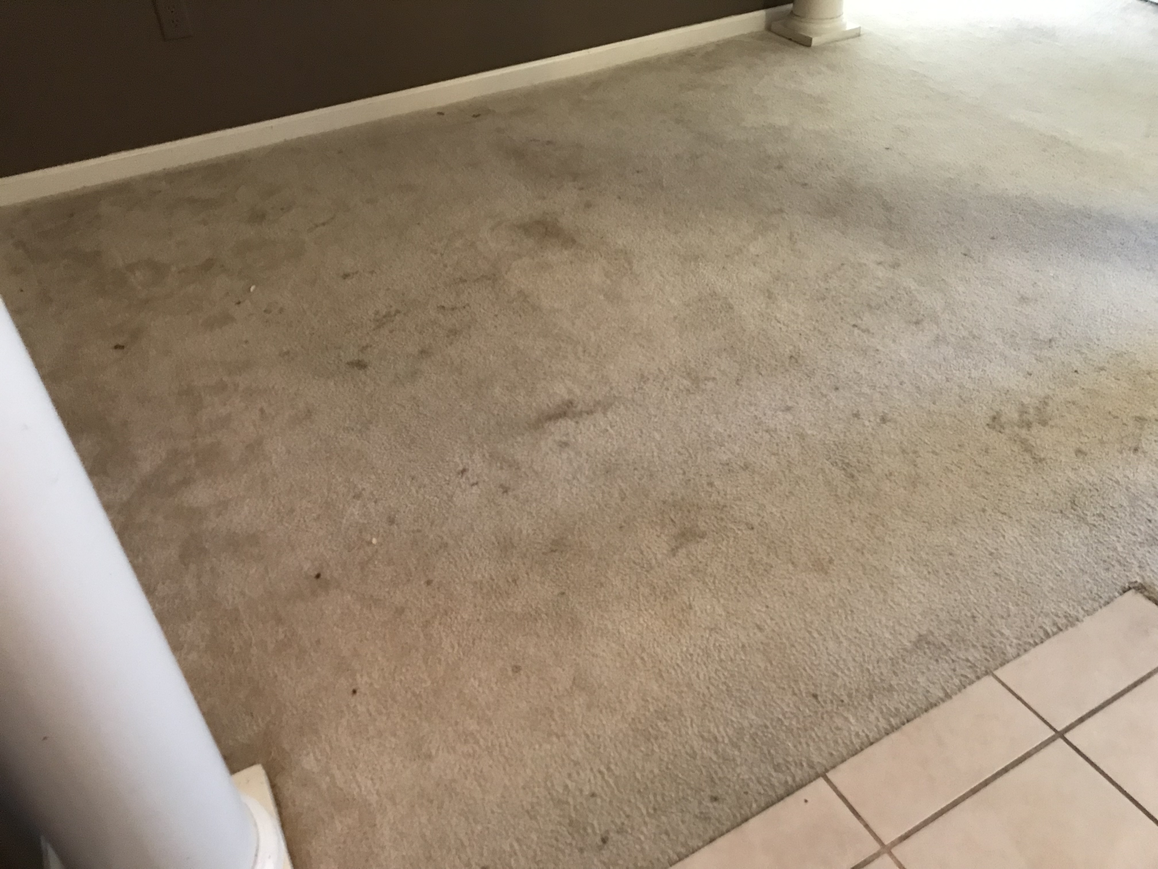

Arrived at job this morning that would have been a 250 foot 3rd floor setup. Ugh. Wasn’t feeling it.
PreVac
Battery sprayer DS2. Two jugs worth.
CRB
PostVac
Total job and post took 1.5 hours.
I am first and foremost a HWE guy. But this turned out pretty good and the customer gave me the 👍.
View attachment 94022Before
View attachment 94030After
View attachment 94023Before
View attachment 94029After
The rest of the rooms after cleaning.
View attachment 94024View attachment 94025View attachment 94026View attachment 94027View attachment 94028
