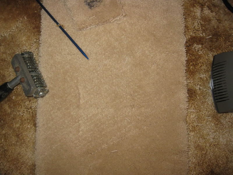

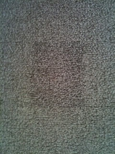

I have all the tools I need koolglide ect. ect., just no confidence... Here's a little practice from today, it's a work in progress :lol: I'm having a hard time getting the marks from the knitting needle out.

Once you have put the patch together look between the lines to see if you have any gapping, ledging, or fibers stuck in the seem. And remember not matter how perfect you get it.. there is no such thing as an invisible seam. And also remember that cutpiles are going to be some of the hardest to seem up and make look descent.
If all looks good from the three points avoe, take your tucking tool or hawkbill and rubb it back and forth a few times.. trim the seam up with some duckbills to make sure the levels are equal, then tractor it well. it will blend in more as time goes on.

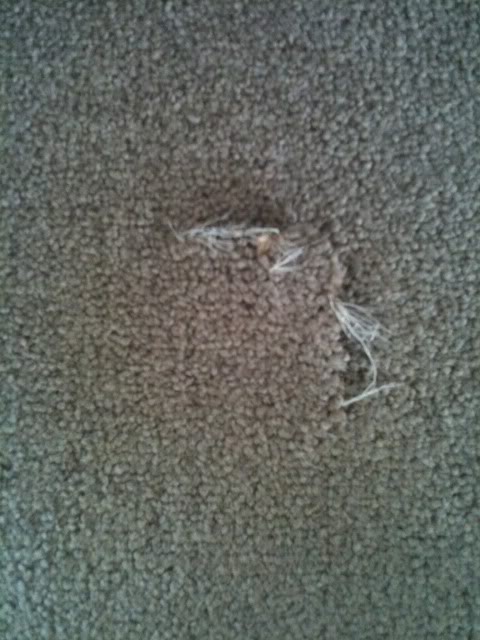

This is a repair I did recently. It was a rental property and the landlord instructed me to use the brand new off cut to repair this damage.
Ok, so the repair is visible, but only because of the colour variation. The joins are tight and uniform.

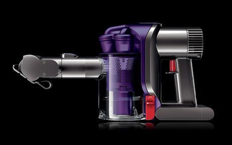

For anyone doing repair work, spend a little money and get one of these babies.
http://www.dyson.co.nz/store/product.asp?product=DC31-ANIMAL
It's so quick and easy to tidy up after yourself once the repair is done. It's more convenient that grabbing teh full size vacuum from teh truck. It's also got a motorised head, that means I can run it aggressively over my joins and repairs to ensure they are not going to come loose after I leave. It also frees up any wispy tufts that may need trimming instead of them working out over time and leaving a hairy join on a patch.
Battery lasts me almost a week using it 2-3 times a day most days. I need to either get a spare battery or the 12 v charger because when it gets low, it dies suddenly. Their philosophy is a vacuum that works all the time, hence it stopping before it becomes ineffective.

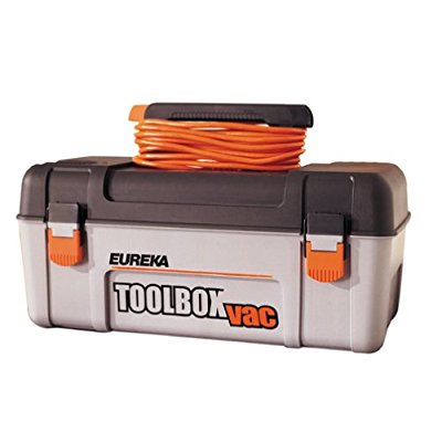

aheemmmm....

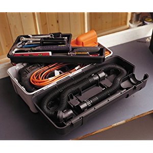

I kinda of like this one... I will admit ours was free.. but add this:
I can carry quite a few repair tools in the box as well.

Nice concept... and with the addition of teh power head achieves a similar result.
You'd be surprised the number of comments I get about simply vacuuming once I'm done, obviously it's not the norm.
