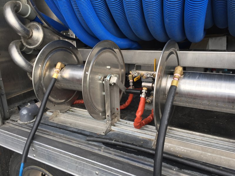

I usually make it a habit to replace my solution hoses at the beginning of summer. I like the Goodyear hose, but don't like them blowing out. Aerotech no longer has the smooth hose with these strain relieve ends so I had my new hoses up fitted.

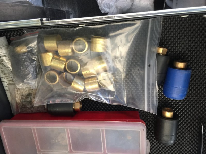

Parflex is the shit! I agree with the orange/yellow being difficult also.. I thought it would break in, but it hasn't happened. Nice thing is you can put your ends on at home, and it's light as hell,and it won't leave unremovable snake lines in the carpet, and no black death. Why anyone would use Goodyear in a house is beyond me..

Is there any video footage on howcthis is done? I've never tried this before, for the parker.
