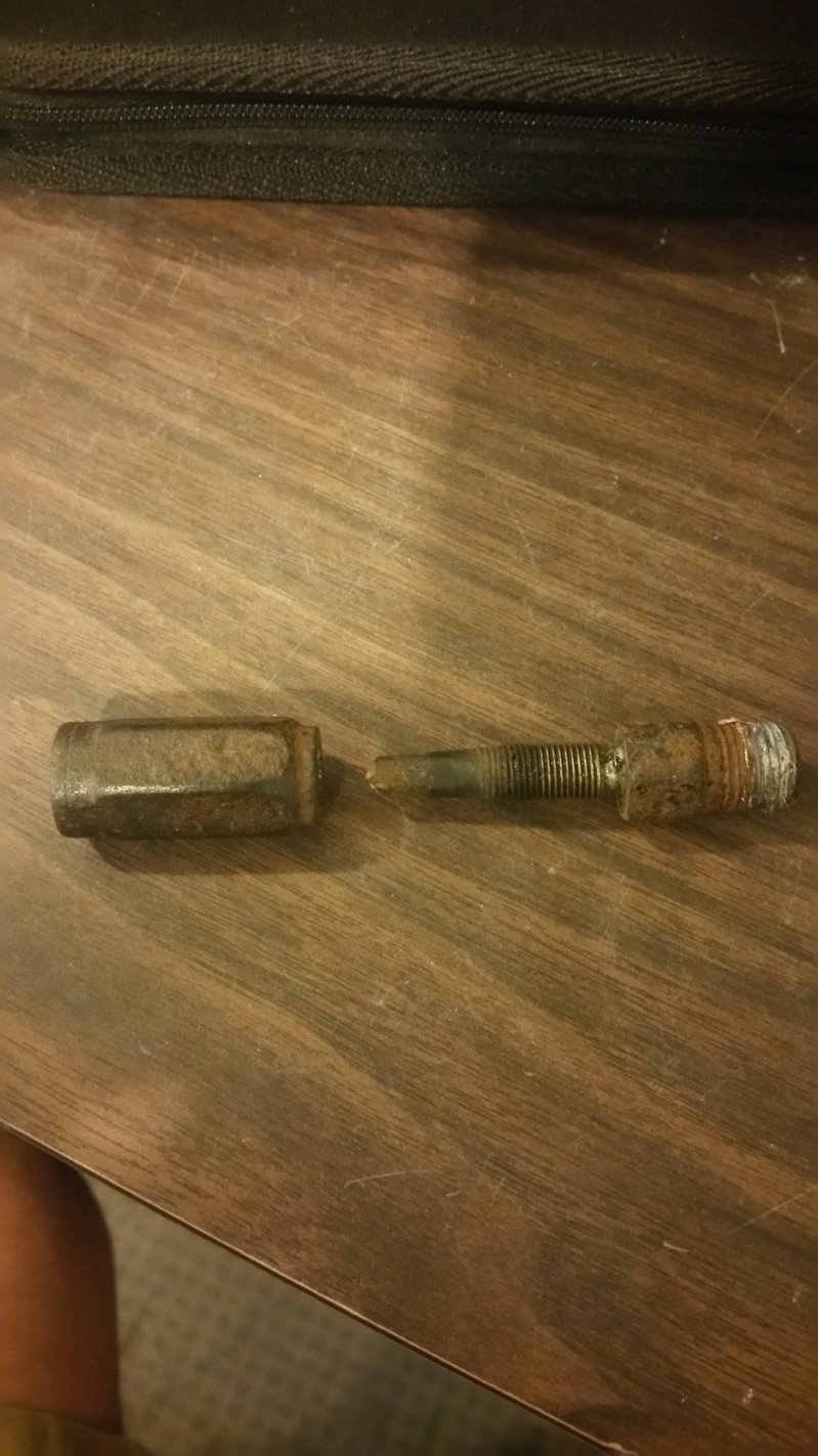

No video needed.. Here is an old one:
The piece on the left screws on to your hose (reverse thread) then screw the other piece in all the way..
View attachment 15446 The piece on the left screws on to your hose (reverse thread) then screw the other piece in all the way..
Where do you get these? Ive picked up a few here and there over the years and have been reusing them but i'm do for some new ones.

I don't find them to be very reusable. They don't cut into the hose the second use. They are a life saver to have onboard. Never used the paraflex, so they may get be reusable for that.

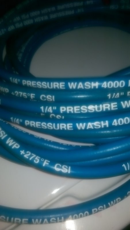

This is the hose i use. I get it locally and he can crimp it with whatever i want.
