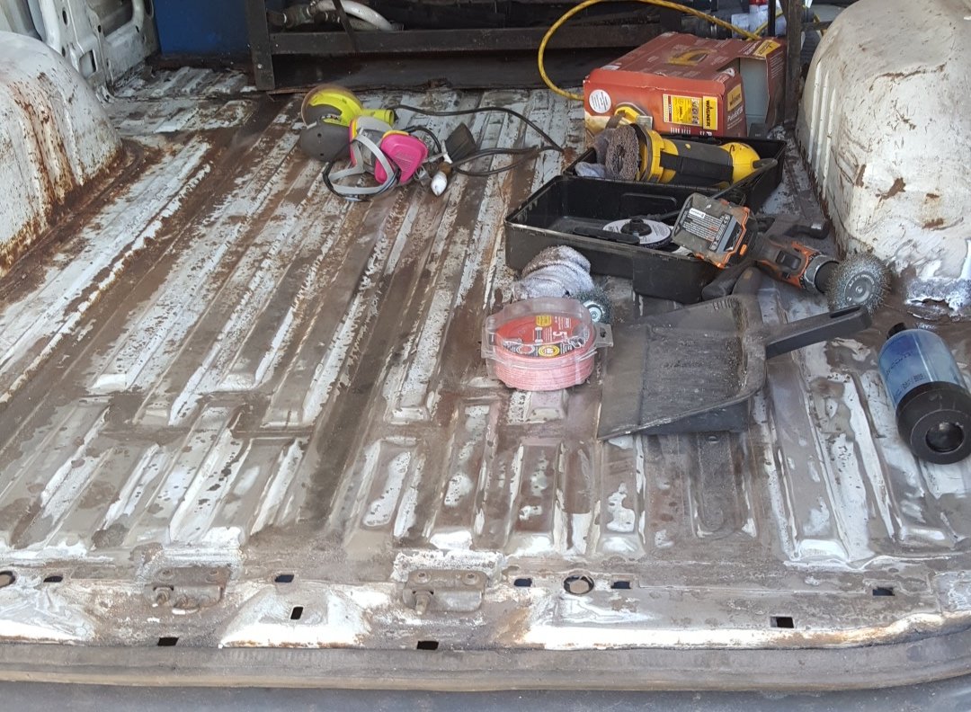

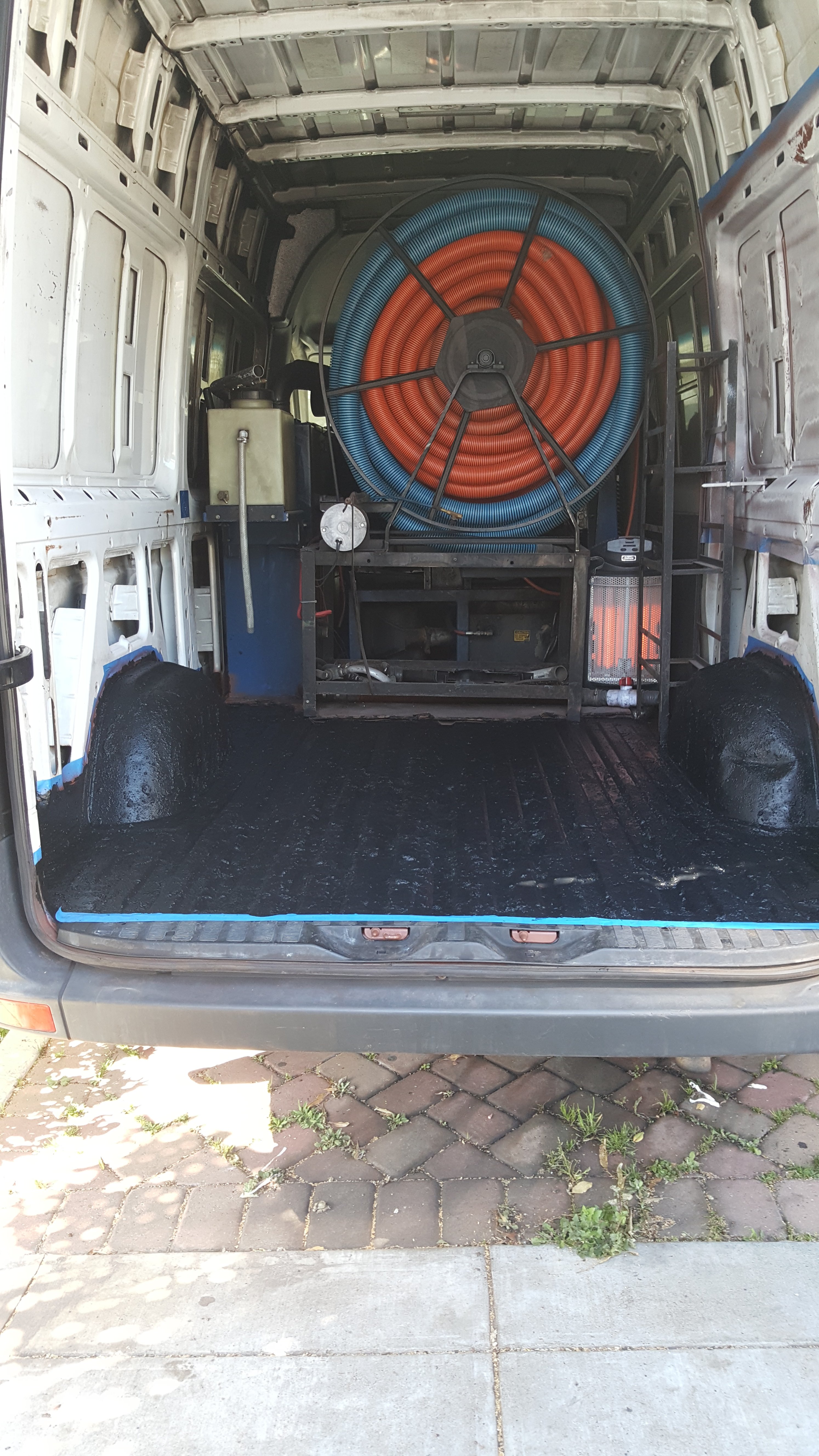

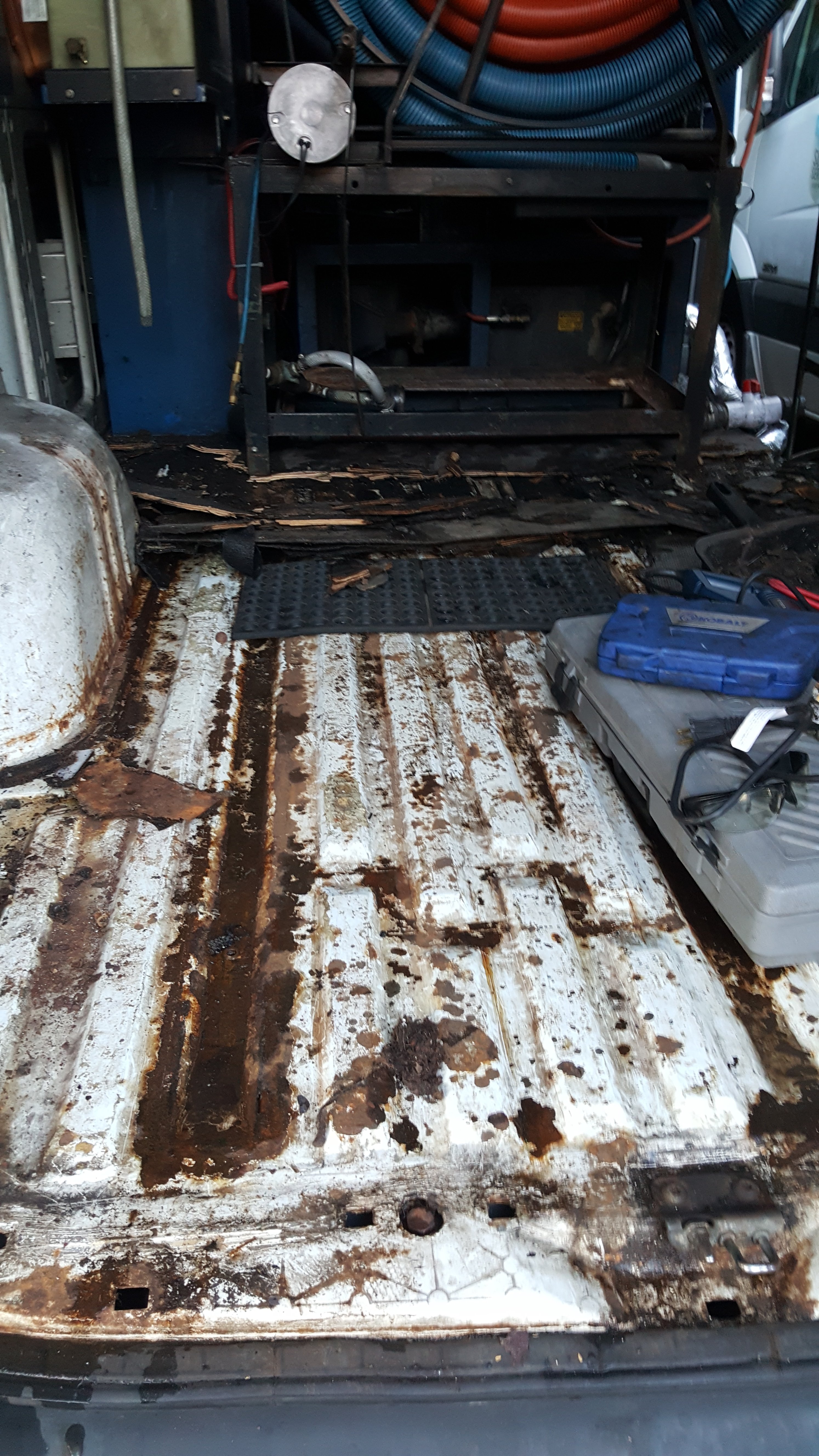

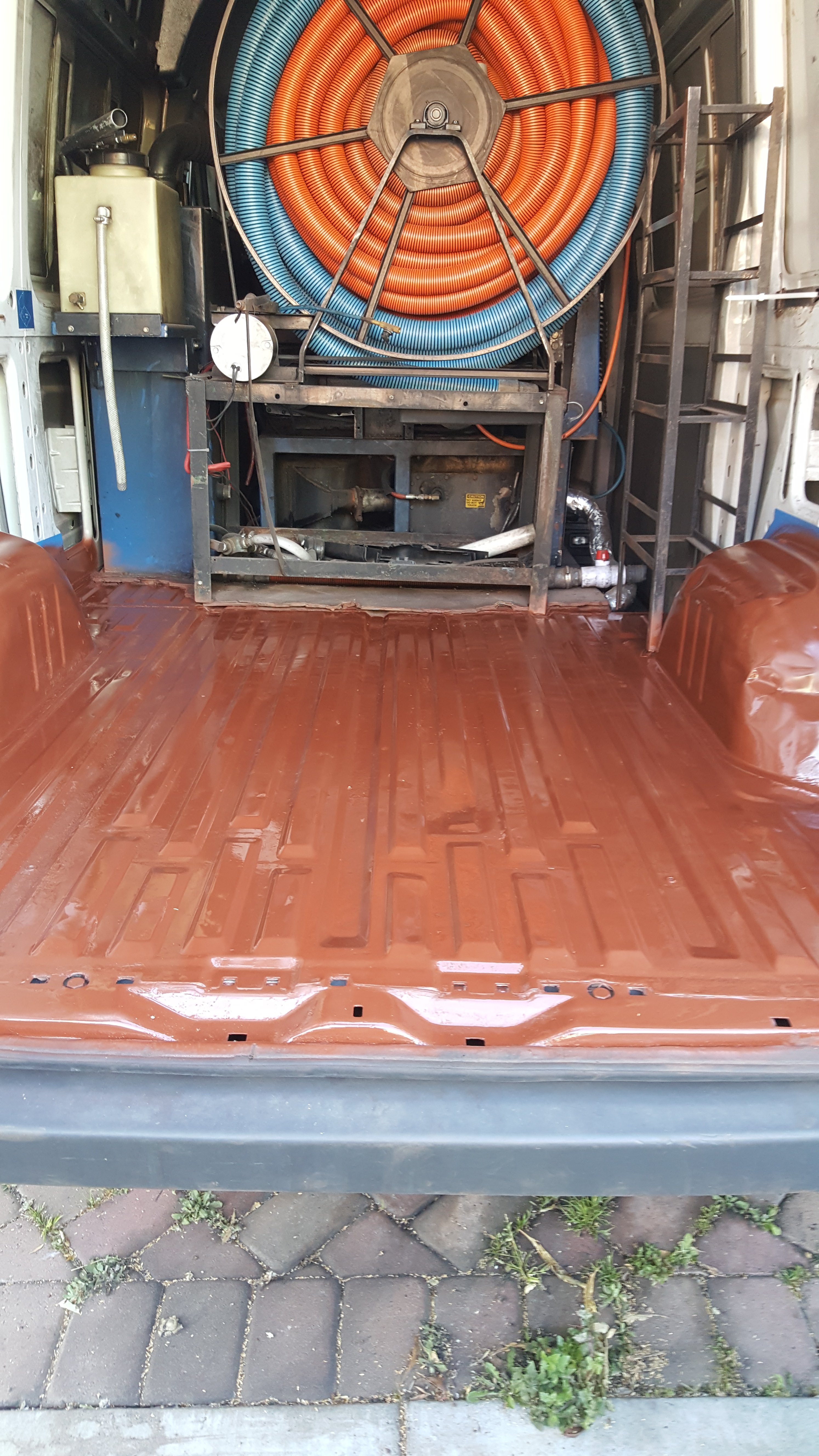

I did it myself with this stuff:
http://www.jegs.com/i/Duplicolor/31...MIvv2QgObJ2QIVFrbACh0kJADiEAYYAiABEgLgZ_D_BwE
It was cold when I did it.. I think hotter weather would have been better. I'm thinking smooth would have been better but I saved about $600.

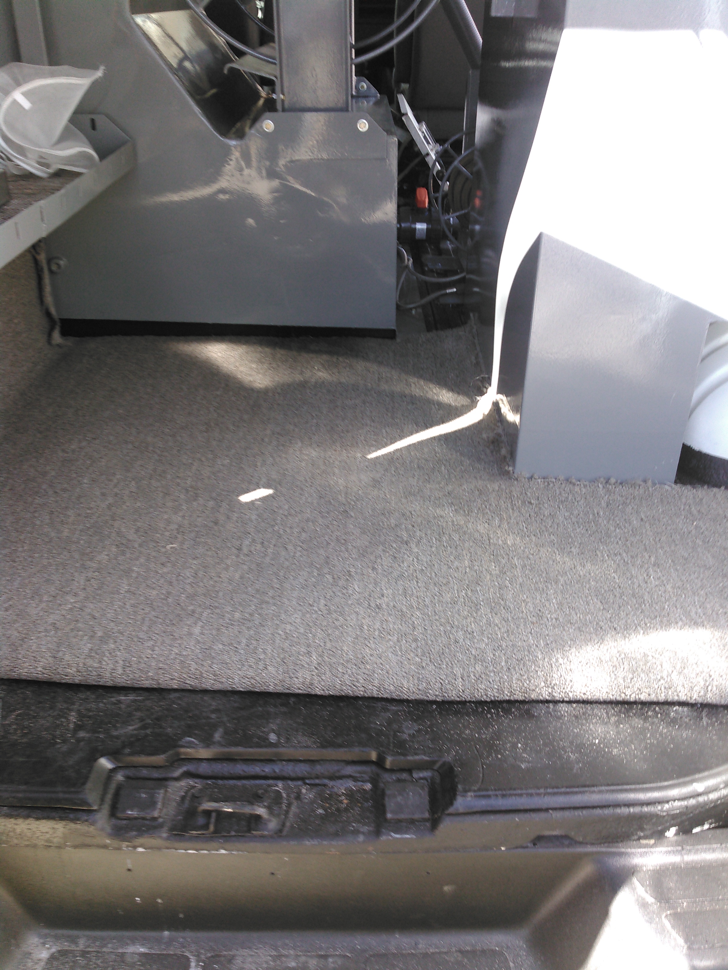

Not sure what's on mine but I got a piece of carpet for $35 to lay on top of it.
I'll pull it out occasionally to clean it and replace it if it gets too fugly.
should help with noise too.
