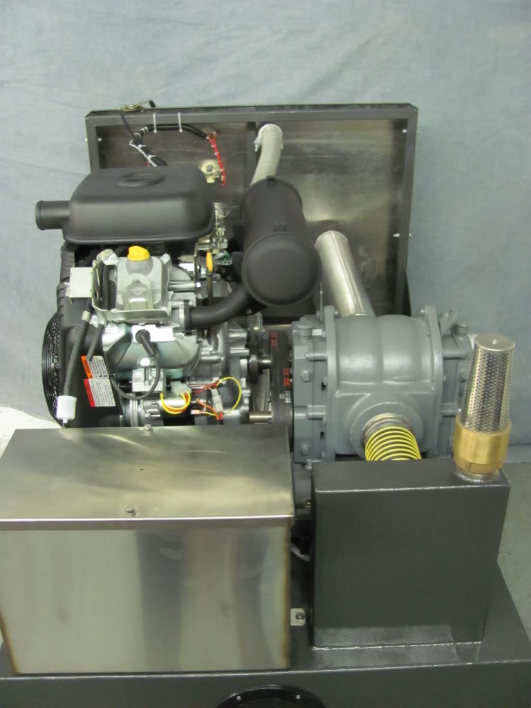

Nice machine for sure, BUT
If you are going to build a real money making machine Les, it needs more power (suction) to effectively run two tools and dual pressure regulators or possibly two pumps (not as important as the suction). High pressure would be nice too.
Why can't you use a larger motor like the Nissan and build a machine with larger blower plumbed right?
I would love to demo one.

clean and simple. Doesn't get any better than that. And you can find 99% of the replacement parts locally

Sweet machine Les. Is the tank the same size as an TNT machine? I have an idea about turning my old TNT into a Beast like this one!!

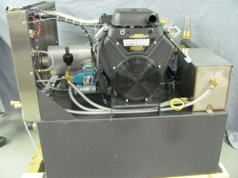

8) Looks like something I could work on without cussing.
What kind of vac relief is that?
Do side mounted engines stay as cool as front mounted engines?

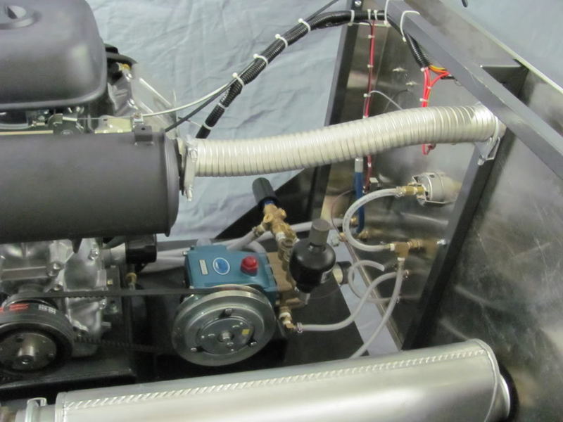

You can add a second pressure regulator to any machine.
The primary (factory) unit set at the higher pressure, and the second one, fed from the output of the first one, at a lower pressure.

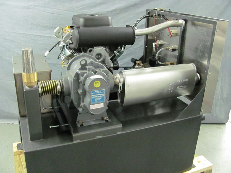

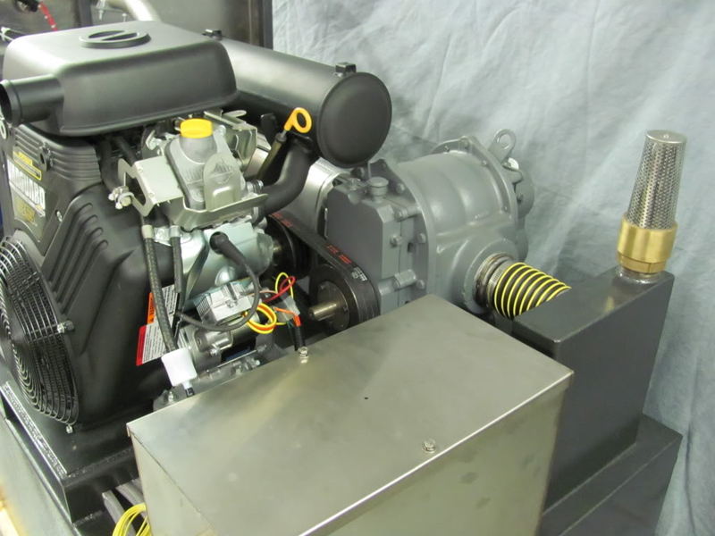

Nice! I assume its a slightly lower cost C4 than the original? No Bayco valve or silencer. Is that the Roots 59? Might loud at max rpm?

That C4 has all the vacuum you would ever need/want for single or dual wand cleaning.
Coupled with a 4HT, it also has all the heat you would need.

The side mounted engine fan blows the air past the heater and out the back door. It stays surprisingly cool for a machine that generates so much heat.
It's kind of genius really.
