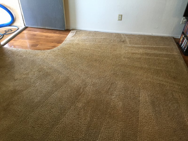

I've seen it it looks like little dirt pockets in the shape on a zebra stripe little 2 to 3 inch and its patterned.
My rx20 did it 360i did it and hoss to.
Usually only on a light colored thick nasty carpet!

Customer doesn't remember the name of the previous cleaner, but a RE was not used and "zebra stripes" were also left by that cleaning. I didn't notice stripes before I cleaned, but a lot of soap in the carpet. His daughter's house is where I used 900 psi to get old soap out. Possibly same previous cleaner.

Went back to the job with "zebra stripes" today. Yup, faint black stripes along the path of the Hoss. Customer said he cleaned it with his home unit, and another cleaner cleaned it since. The other cleaner also left stripes with his wand. Problem was lots of soap residue from one or both sources.
Vacuumed, sprinkled crystal defomer per Mark's suggestion, sprayed Zone Perfect, scrubbed with Brute and Tu-way pad, extracted with Greenhorn and End Zone, dried with Airpaths. Looked good when I left.
The key seems to be defoamer. Is it possible to add defoamer to prespray or rinse instead of sprinkling it on and raking it in?
Thanks to everyone, even Russ, and especially Mark and Gene who, I think, had the key idea. Next time I Hoss, (probably tomorrow morning)'I'm going to try Jim's pattern.
