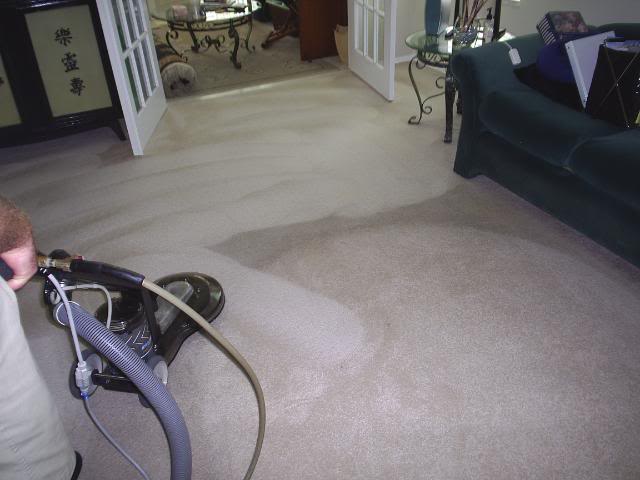

Jim,
If I had to clean again...I would never use a wand...They are light, fold up easy
loading & storage. They get right up to the base boards..No overspray & are PERFECT
for in home area rug cleaning..."RIGHT ON THE WOOD FLOORS." I've seen Jimmy naked
The bigger the TM the better... LIKE!

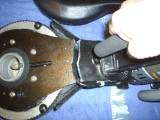

If you try real hard...You can BREAK them.... :lol: :lol: :lol: :lol: :lol: :lol: :lol:
