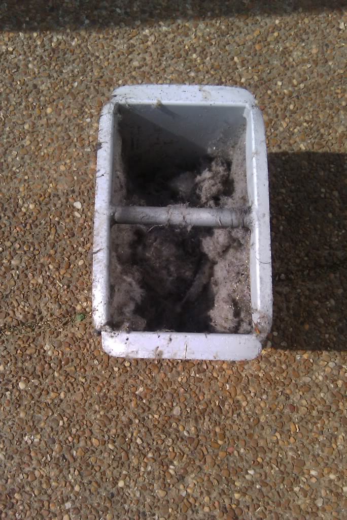

All of this came out of the downstairs only. Carpet was vacuumed good before our arrival.

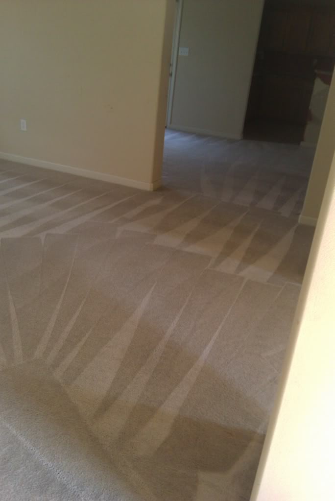

Finished

Looks like the filter is full of polyester fibers.

Carpets came out good....

Thanks for doing the video, I always enjoy seeing how others do things. Job turned out great!

Now....if you had a pair of panty hose in that filter basket it would have been a quick lift out and toss away. No hosing' out the crap.

Daniel you can increase the flow area of you waste basket by buying a small piece of perforated stainless and then have some body cut and weld it in the sides. solid just doesn't make sense to me. i did mine for only 20 bucks. holds more stuff without loosing air flow.
gene
gene
:idea: - I didn't even catch that - great point.

Great tip. I'll do that and know someone that will do it cheap.
Well I have a dual 2.5 inch port that I am going to have installed on the top of my tank as soon as I get a day off during the week. I have some new kick ass mytee filters that are 2.5 inch as well. I'll just use panty hose in them and toss after each job. I'm sure the air flow will be much better. I only use the basket when the inline filters are dirty, but I hate them.

agree..this is the best for a waste basket...
then just take a knee high and put it where the hose connects....leave the basket in for support...
just pop out and throw away....this will also eliminate setting up extra inline filters...

what do you guys have against just grabbing the stuff out with your hands . shiteatinggrin
thats what helpers are for :lol: who do you get the piglets from ?
gene
