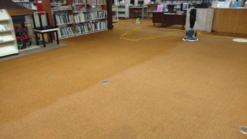

I have the Ryobi sprayer. Got it last week. Works OK. It is loud and one gallon is crappy but I don't do carpet every day so it works for me. The quality is very good for the price. Well made and well thought out except for the size. You can see it in the back of this picture with my new vibe.

Was that post HWE or cleaning if not thats alright!!!. How many soft, how long did it take you? Ball park of charges...

Your picture gave me a lot of hope. This evening I loaded up the kids and wife in the car and drove out to a very large health club in my town. I submitted a bid. I bid the job with using a technique I learned at Mikey's Fest by the people that put on the presentation from Excellent Supply. If I get the job i'll be using my Orbot. Fingers crossed.

Orbot vibe working great. This was my first vlm job. Dirty library that hadn't been cleaned in over two years. I sprayed with the Ryobi, let dwell for a few min. Then I used superzorb pads to clean. Only caution I will say is if carpet is moderately soiled you will go through more pads than you think. I went through 15 pads in 4-5k sq feet of carpet. I could have used more. Pre vac well and post vac well when dry.

My bid was for 6K sq ft. So I should plan on about 20 diapers?

I think it depends on soiling. I imagine the gym doesn't have alot of protein based soil like foods so you should be good with that.
