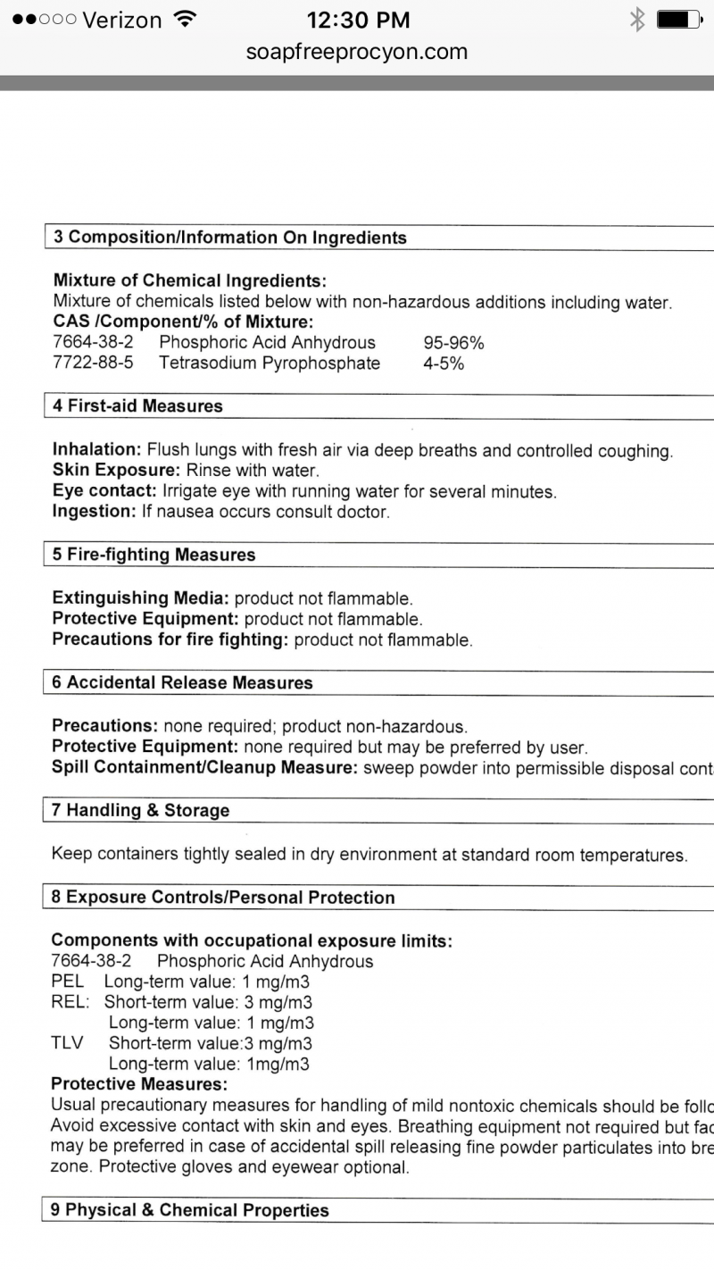

Procyon powder should not be causing corrosion in your machine.
The procyon I am familiar with used STPP as the primary builder.
We also use STPP in two of our powder presprays, and have not seen this problem.
STPP has a pH of 9.5 and is a water softener.
It had been used for many years in premium laundry formulas with no issues.
Which procyon product were you using in your CRB machine ?
Have you looked at the SDS to see what builders are in it ?
11,431
13,372
I hear my bearings getting loud now. I was thinking of disassembling it and cleaning it up. There is corrosion around the bearings.
I use prozyme plus which has a lot of salts too.
Larry Cobb
5,795
Larry Cobb
Strange formulation , strong acid base, . . .
Phosphoric acid is CAS 7664-38-2 (in SDS above)
That acid would cause metal corrosion @ 95 % .
Questions for their chemist to answer !
Any other users seeing corrosion ?
28,078
All their other products are 9-11 percent phosphoric acid. I do not believe it contains 95 percent phosphoric acid. It would be an extremely hazardous chemical. I think we are misreading what the sds sheet is saying or its a typo.

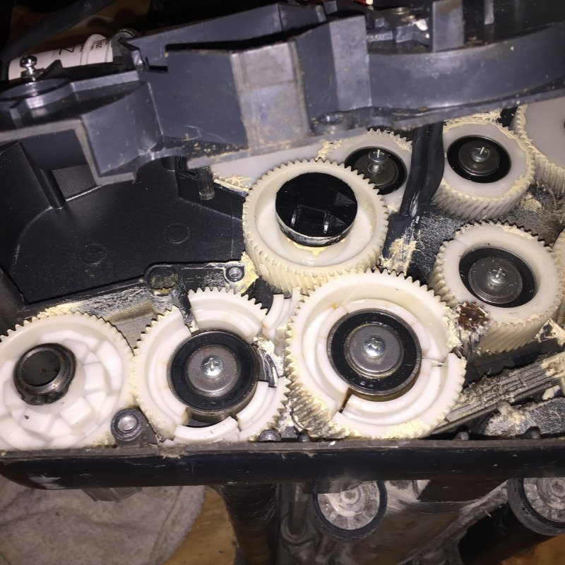

Here's what happens when your elves suck the cord. But I haven't seen any corrosion (this is a DP-420). Don't suck cords. It costs around $24 a gear and this sucker has 12.
