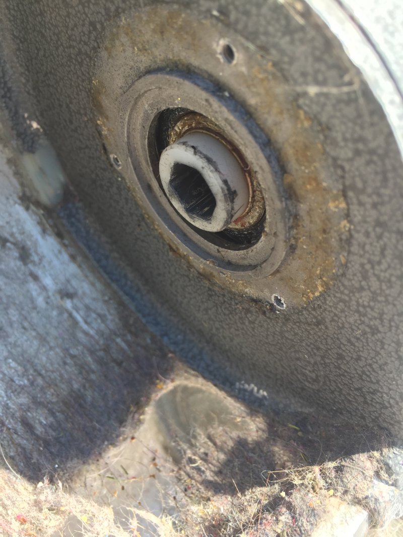

I used Procyon Powder for over 20 years, but only as a rinse. I've moved on to some of the newer products out there for PS and rinse. Procyon still makes a hell of a give-away spotter when you mix and bottle yourself.
Now I know what to do with the 100 lbs I just bought.
GeeeAus
Sep 23, 2013
1,120
Grant Baverstock
Procyon powder should not be causing corrosion in your machine.
The procyon I am familiar with used STPP as the primary builder.
We also use STPP in two of our powder presprays, and have not seen this problem.
STPP has a pH of 9.5 and is a water softener.
It had been used for many years in premium laundry formulas with no issues.
Which procyon product were you using in your CRB machine ?
Have you looked at the SDS to see what builders are in it ?
I'm inclined to agree. Most pre-sprays use these builders in some proportion. Soap free offerings rely on it to a much greater degree. It makes up more of the product. That means in time everybody grooming in powdered pre-sprays will start to see issues.

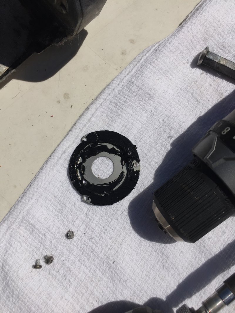

So where do I get parts f hirom for this crb? I haven't had the chance and really don't feel like chasing down stuff here.
I was wondering if there is a rebuild kit. All the screws and a few ectras, the bearing covers and bearings is all I need I think.
I don't know if a parts list has been posted or not but was wondering what's holding the bearing in. I don't see a snap ring.
I need to get back to this and probably order the 15.
I wish I had time and energy to piece it together but maybe another time. I'll take better care of it now that I've had it apart and see what happened. Thinking of a piece of felt over the bearings for extra protection.

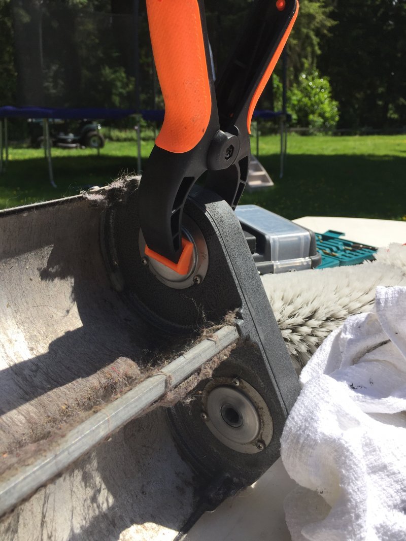

I was all freaked out after seeing the pics Reg was showing and the machine at Johns the other day. I use products full of stpp so I was expecting the worse as I don't take the brushes off very much and clean, I just rinse the brushes and vacuum them off after every job, so hair does build up a bit on the shaft.
I took my 10" all apart last night and all was well and beautiful, the bearings looked new, and my machine is 4 years old. The neglect it must take for those pictures Reg was showing and that I saw at Johns Place the other day blow me away. I'll definitely be taking the shafts off and de-hairing more often as routine maintenance.
13,372
I called excellent supply and spoke to Rod. I was happy they are replacing the screws with hex bolts. Should really help with maintenance. We talked about ways to sheild the bearing more too.
Just wanted to give them an honorable mention. Getting some Ds1 too. Really looking forward to the 15.
