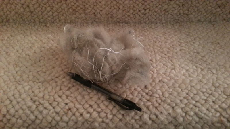

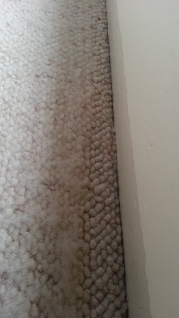

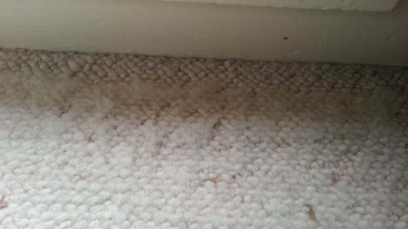

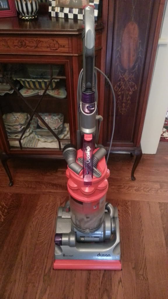

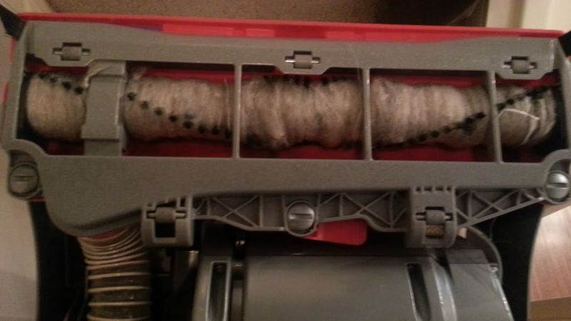

Are modern Dyson vacuums still RIPPING apart wool carpets?
This bastard is viscous!
4 years of abuse...
Loaded with fluff and plaque residue...:errf:
and no one to blame but herself and her lack of reading warranties and doing some research..
I guess the Dyson doesn't offer close to the edge grooming after all...
What are you Dyson owners seeing?
Has the twisted roll
been replaced with the tubular roll?
and is it any gentler?

I think today's beater bar is better than the one you are showing in the picture above. Even though we use Dyson's a lot, very rarely on wool. Today's Dyson also has a selection mode for setting the bar height. That one there is an auto adjust, if it does auto adjust.

The tubular roller has been around many years. The DC17 Absolute has had the tubular roll for years. It does not get loaded up like the other one but it is still to aggressive for wool or even some fine polys. I turn the roller off when working on wools.

Dyson is the best vac on the market. I haven't found a vacuum yet that will edge close to the baseboards, but the Dyson comes with a nifty tool that you can use to edge with ... it's called an attachment hose and tool. Most cleaners have no idea what that is or how to use it. Pitiful!

Also with all the models they have the $300 version with a twisty beater that doesn't work to good on the animal version they have the round beater bar.
Much better needs belts replaces I have 2 a dc33 and a dc17, the 17 is way better but is an animal.

The issue os the Red Bristle on some Dysons have no give in them and are just like wooden dowels. I think there is a rug manufacturer that says if you use a Dyson you void their warranty.

I believe MANY wool carpet manufactures say that Ron.

The dyson suction is great. If you do use it on wool use the floor selection rather than the carpet. There is no adjustment on the dyson . The floor is suction only . Carpet as you know run the brush with no adjustment. The bristles are to stiff and to agressive for wool. Like Ron said if you use it on wool you void the warranty. I get so much pamplets in the rolls that state do not use dyson. Some say do not use a beater bar or roller brush , suction only.

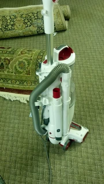

We have the second one, bought at Walmart. Looks a light in the loafers but vacuums like a beast.
Love it, one of the guys bought one for his own homes after using ours.

thanx! so how does the hose & wand compare? the Dyson's is a great design and very long and practical.

well yeah, one visit a year from you and your Dyson aint going to shred it like the one above.
Hers obviously did over a 4 year span
