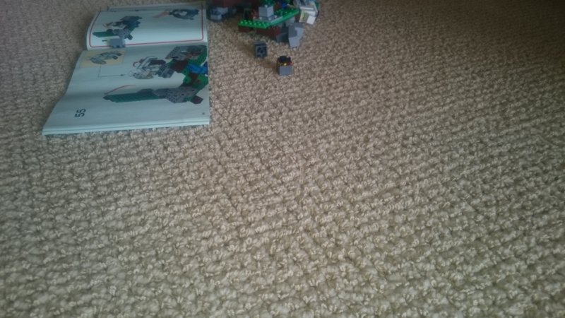

Nov 2, 2007
6,196
This is the type of loop carpet we have....and it keeps coming back to me how some of the companies out there only clean these carpets with bonnets and claim they can't be steam cleaned. Right Cole?

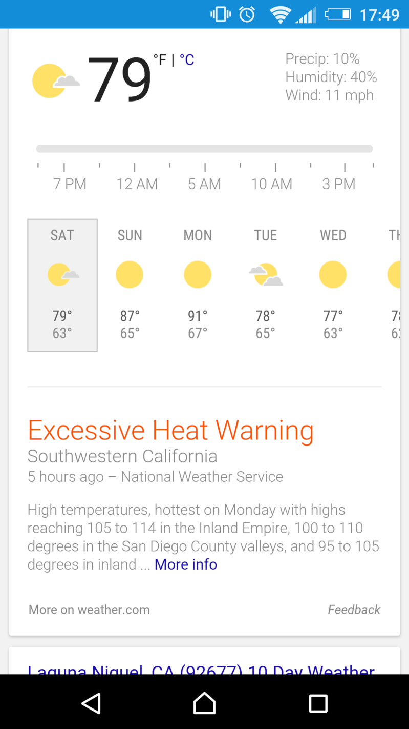

Fook Zee, thats not carpet! :winky:
What is your humidity like there? I can see doing that here with a Zipper but you might as well triple drying time with just a wand.
Humidity is terrible here. :errf:

Around 45% when I was working. Maybe a little higher...
This is right now :
