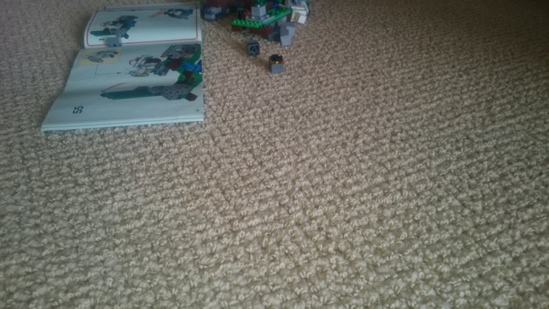

This is the type of loop carpet we have....and it keeps coming back to me how some of the companies out there only clean these carpets with bonnets and claim they can't be steam cleaned. Right Cole?
Rolling eyes...
You never got it did you? I had burger flippers... I had them encapsulating as to avoid PH burns. Of course I sold it was it was absolutely necessary... I came up with the idea in the early 2000's and confused the entire market here in Atlanta. Guys trying to argue against my hundreds of thousands of fliers stating that you HAD to do it... It's called a disrupter.... ZERO-Rez does it NOW- claiming that EVERYONE else leaves a residue. Go fight that fight instead of complaining about an ancient marketing campaign of a long dead company? lol Clearly you need better things to do? :)
