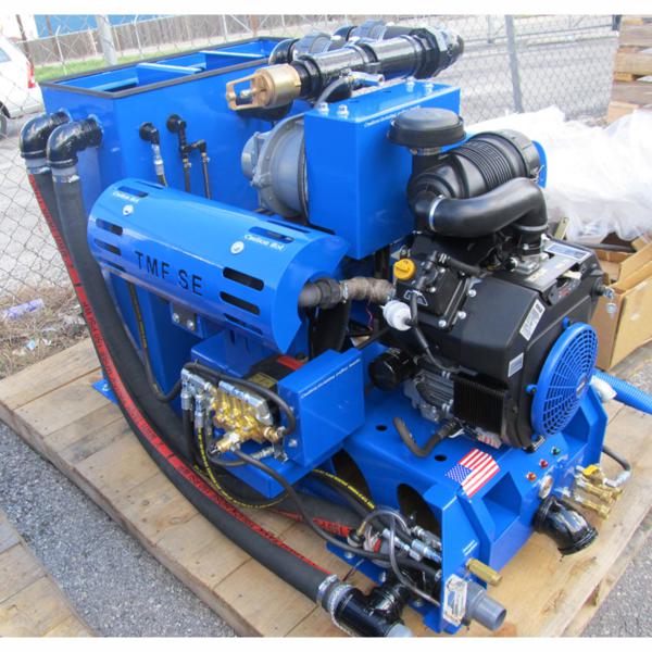

fyi,
:lol:
a]http://www.youtube.com/watch?v=CegiLUMX950a]

Our local guy that repairs tm's has 2 of them in his shop for repair. He calls them a big pos and can't figure out why anyone would ever buy one.

400 cfm from a 45 blower.......
Ya, right, when you run it 4000 rpms (max is 3600) at 12" Hg or when you run it at 3600 rpm at 4" Hg.
Why is it so hard for a manufacture to tell the truth about the real specs of his machine? You can tell that he runs the 25 hp Kohler at about 3200 rpms because of the tiny tach. But what he turns the blower at he won't tell you.
And you can dual wand with two 1.5 inch wands. Great, if you want to do things the same way cleaners did them 10 or 15 years ago.

I was struck by how very beautiful the Amtex machines are. They would give someone a pride of ownership that other manufacturers could learn from. And the price is very competitive.

We've had a small Amtex (20 hp with a Roots 45) product Working daily for almost 6 years without any major mechanical breakdowns. I think we paid about 9k installed with hoses, reels, wand, etc. Ben provides excellent phone support 24/7. If we needed another system tomorrow, I'd buy from Ben at Amtex.

The machine actually looks pretty cool. Don't know about anything else, but it scores in the looks department.

A closer look doesn't reveal quality in my opinion.
Kinda like a dressed up chemtex.
But if it works for you.

Carpet systems aren't that complicated, we do our own repairs and am as familiar with quality as any other grease monkey. While I'm neither a stockholder or a cheerleader for Amtex, but they're using Kolher and Honda engines, Roots blowers, Hypro pumps and their heat exchangers do the job. Everthing else is wires, hoses and design.
I appreciated that we could grab a good used truck, a brand new carpet cleaning system (hoses, reels, shelving) and wrap the truck for under 20k. [If we hadn't over paid for the wrap, it would have been a lot less.] Everything was paid for in under 30 days! Amtex service provided both during and after warranty was impressive.

Thankfully, our Amtex experience was different. From looking at the model (pictured above) they must sell different configurations, as the waste water seemingly goes directly into the tank and the whole thing appears to be powder coated. Looks like he's made some advances in his product, but no doubt 40 years later you'll still remember your personal experience!
