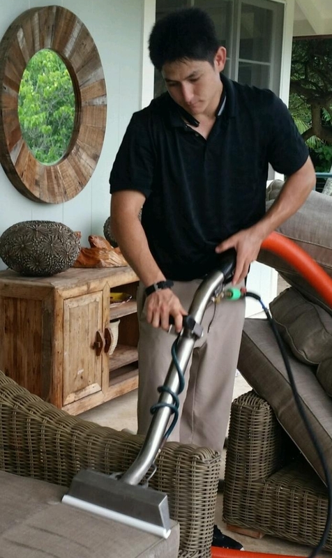

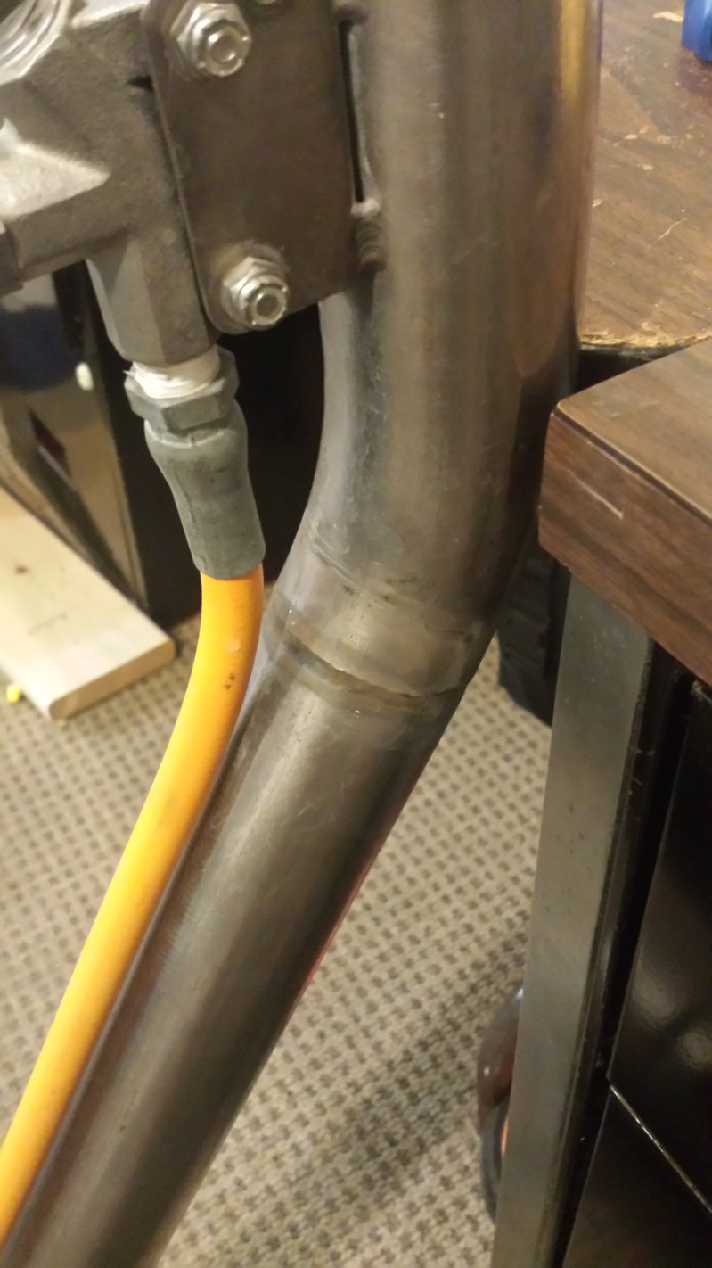

I cut 23" off of mine, and I wouldn't change a thing.. I do need to have another one made though it sucks when I have to use my Prochem tool!!

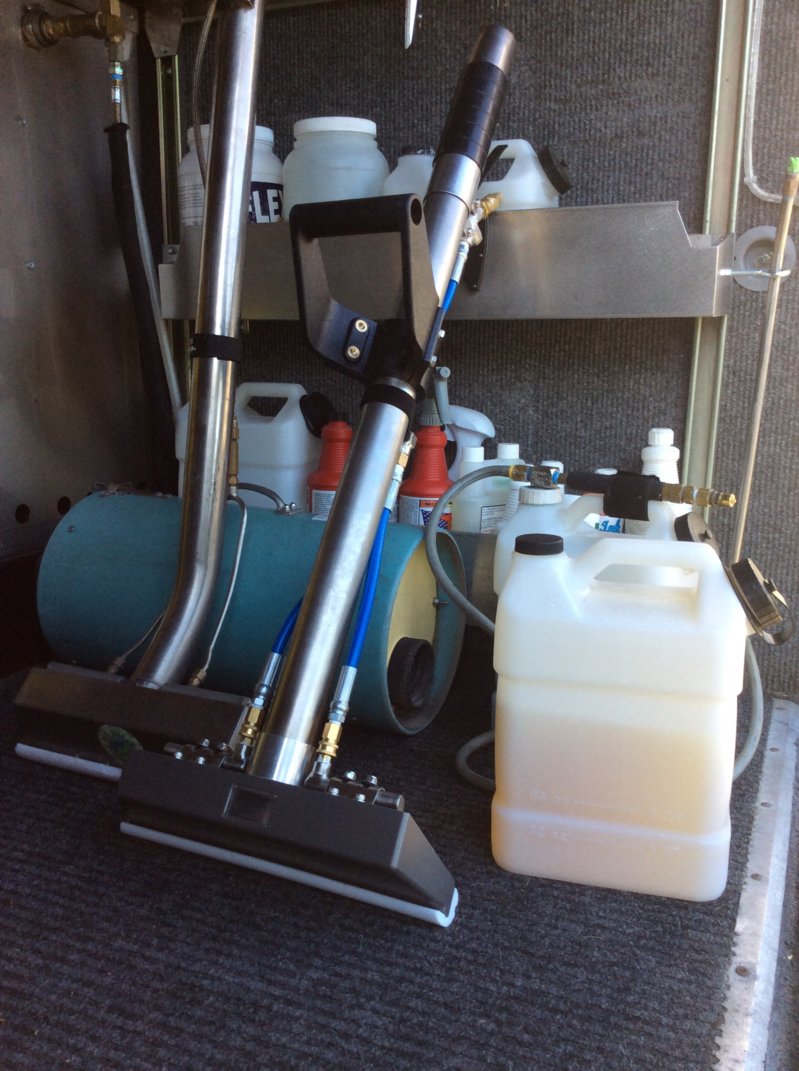

the Devpro is awesome on steps
You can stand dead center and go to town.
No, it doesn't flip for the riser like the PMF stair tool.

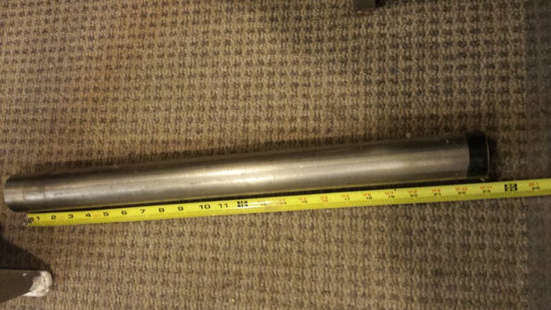

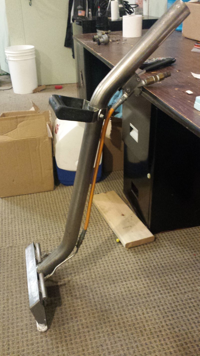

Now that I have an extra wand I was going to cut one of them down and make a longer stair tool. I'll post a picture if I get around to it. The wand they sent with the 870 didn't come with a glide so I'll probably choose it.
I was going to cut it out of the middle and reweld. Doesn't look like anybody else did it that way.

Lol, I had a hip issue, and that's why I made it(had surgery,and good now).. S bend is key to keeping your back straight(except for the last two steps).. The straight tool puts too much pressure on your lower back, kind of like a fulcrum..

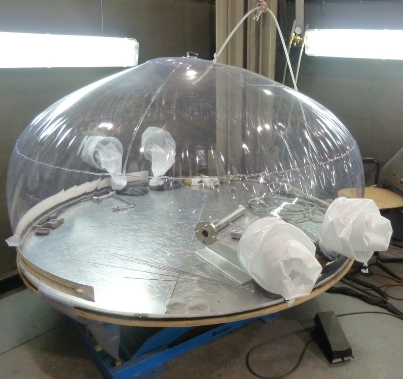

Titanium is kinda tough to weld back together? Need to do it with Zero Oxygen as I understand it.
For critical applications they use a purge chamber, but since this isn't an aerospace component a simple back-purge of the inside of the tube and weld with a large TIG cup is fine.
