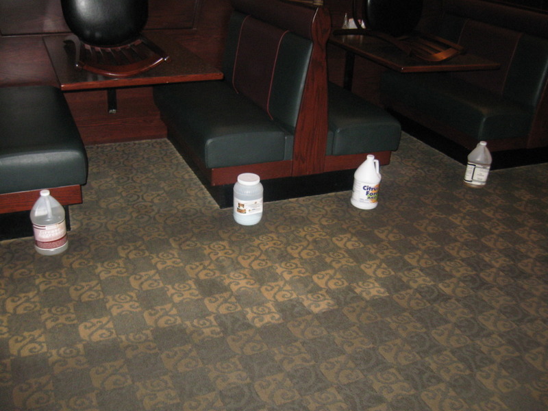

Steakhouse line up
Lyman
May 19, 2007
1,761
Johnstown new york
Lyman
Judson- slop and gobble
Chemiesters-grease aggressor
Bane-olefin pre conditioner-just laying around in garage
Matrix-citrus force asp
I am going to start with a four way clean off to figure what works best. I will post results tomorow.

My moneys on Grease Eraser as a straight up grease peeler! Used it today on a resty. Great and easy results.

I don't see Grease Eraser mentioned in his line up
..l.T.A.
..and that's a liquid. I have a sample gallon with our last order.
I'll see what a DIME'S worth of it does next to the others I have. Will try to stick to the format Larry suggested earlier.

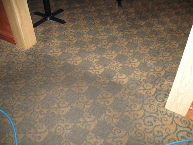

I mixed these according to the label and hit it with a grandy brush and 15 minutes of dwell and clear water rinse.

The citrus force and bane olefin did absolutely nothing. The grease aggressor cleaned it about 1/2 way, not worth your money. Scrubed everything with a dark green pad and she looked great.

Looks great, which machine, wand, flow, did you use for the test?

So was S&G the best performing prespray tested or was scrubbing clearly the difference maker?
I should have sent you a few scoops of Grease Eraser to try. Grease Aggressor is a different animal.
The S&G area looks good. I haven't tried S&G alone on any resty grease yet.

Butler, 235 atm, 175 green pad,18 flow ti wand. The test demo was all mixed in qt spray bottles and sprayed on and hit with 3 strokes of a grandy brush and 15 minutes of dwell and rinsed. All mixed according to label directions.

If your scrubbin with a green pad, what does the "Grandi Groomer" do?

I didn't want to run the 175 over the test to spread the cleaners together. So I used the brush for a little scrub.

you could have expected the Citrus Force ASD not to work.. its an additive.. not a true prespray. Use it to boost other presprays like Matrix Grandslam. Turns Grandslam into a great commercial/heavy soil prespray. But great test nonetheless.
