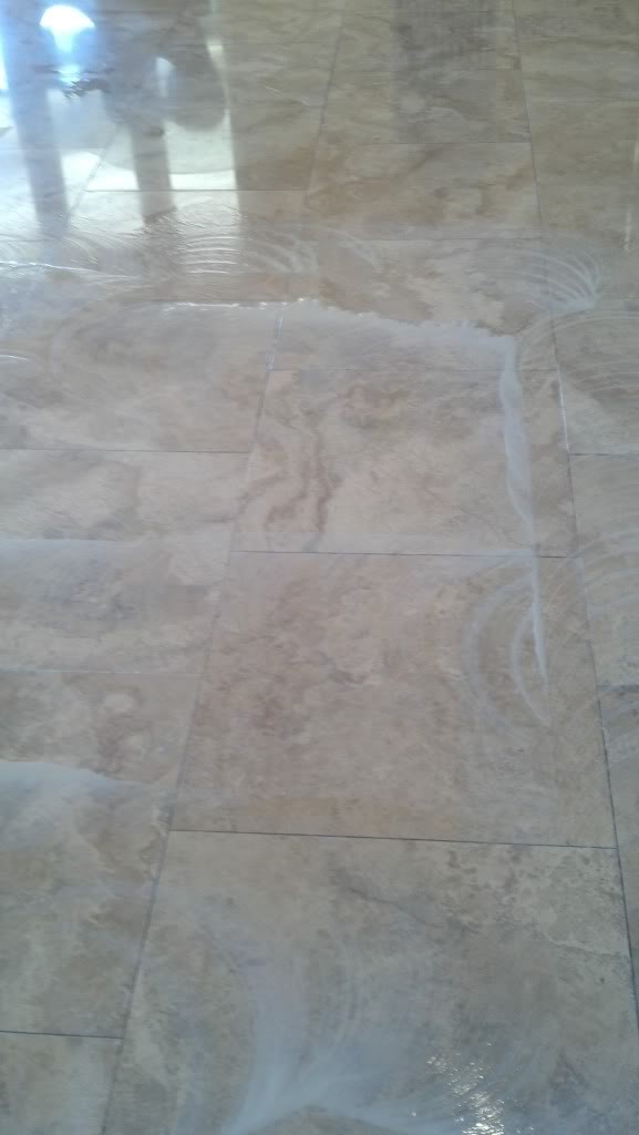

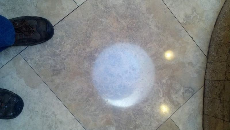

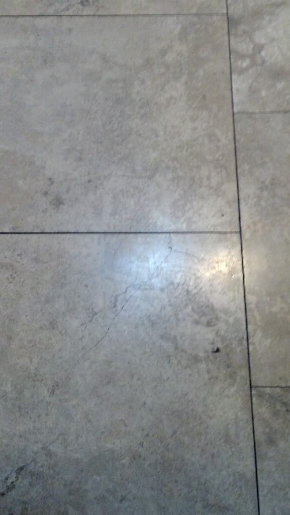

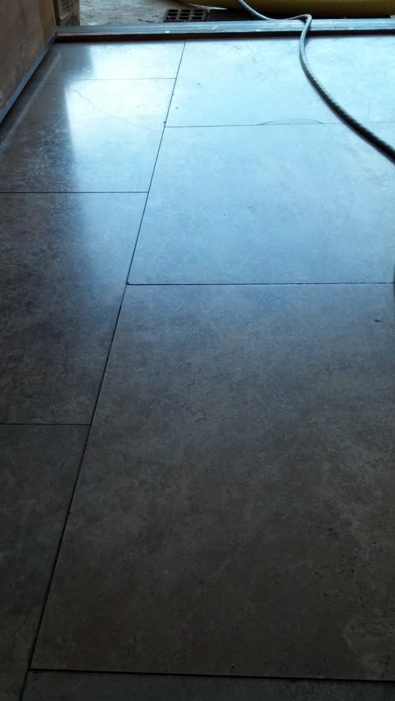

Well I spent half the day stripping the finish off the floor, it had been down for ten years, lots more than I thought. Seems like that's always the case.
I used their traverfill to fill a bunch of small to medium holes and that stuff worked, nice. I have a bunch of pictures, I will post when I'm done polishing, I can't wait.
Before stripping

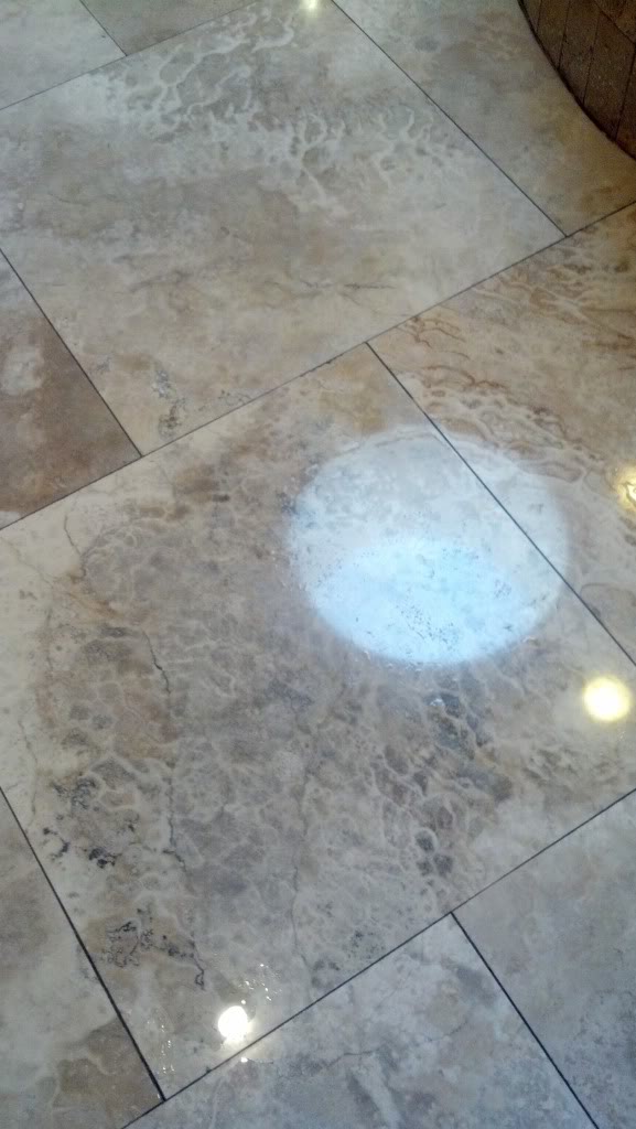

Are you using the Diamond Renew?. If yes and you see some swirls after polishing, the 11k monkey will remove them.

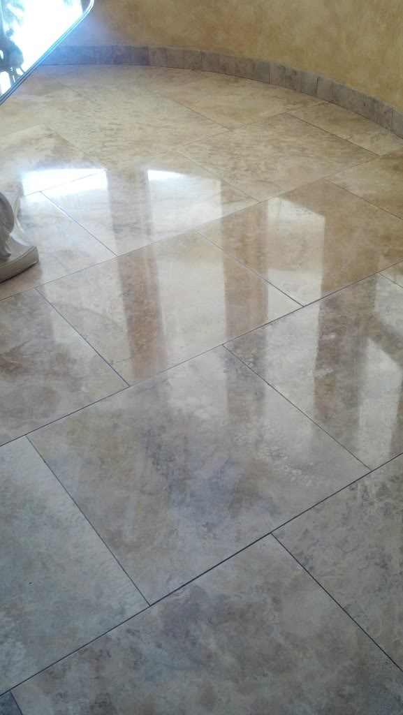

before
stripping

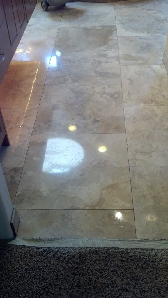

polishing

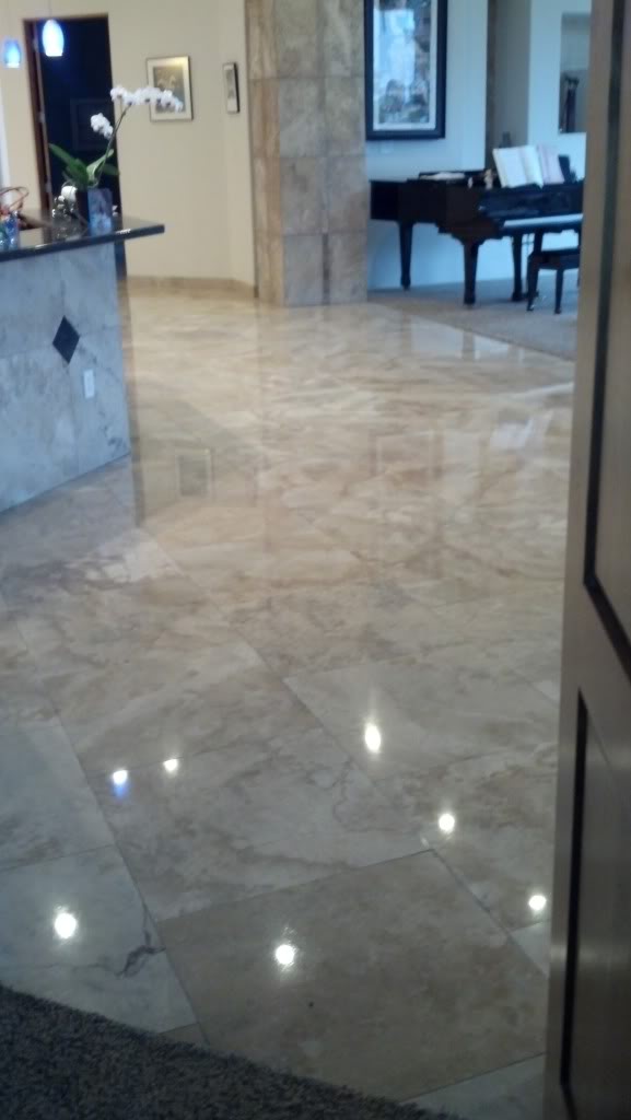

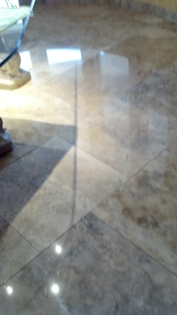

Nov 8, 2006
3,373
Albuquerque
Ron lippold

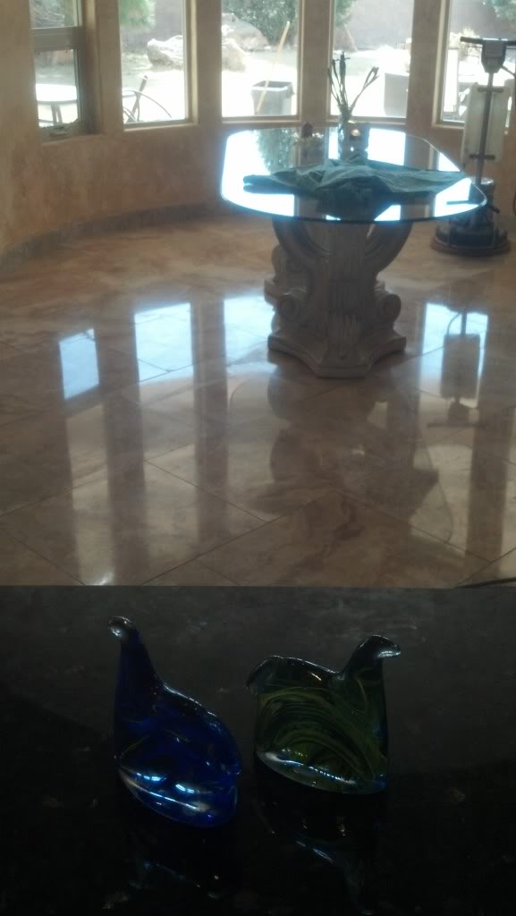

polishing
after
not done yet im going to hit a few more areas and seal in the morning, i will take a few more pictures.
Nov 8, 2006
3,373
Albuquerque
Ron lippold

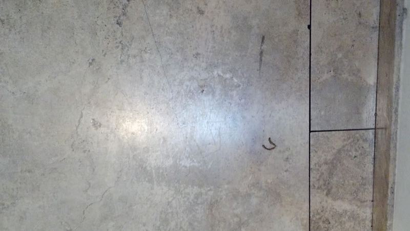

I had a little issue with swirls but I figured if I reversed my pattern it went away, rinsed about 500 psi.

Check the surface tension, before and after sealing... and I think you will see for yourself why sealing, may or may not be needed.
Since that job already had a topical, the pores may already be "loaded up" to a certain extent, but the seal you use will "fill" any voids that may not be protected.
And more importantly the grout.
Nov 8, 2006
3,373
Albuquerque
Ron lippold
O yes I did. My skills are not top notch with the squeegee. I used to remove the haze from the sealer. The 11000 did nothing to the floor except get the haze off. And the grout line are black all over, go figure.
