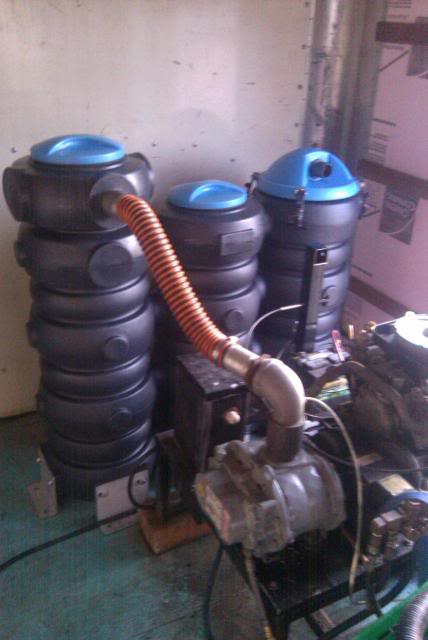

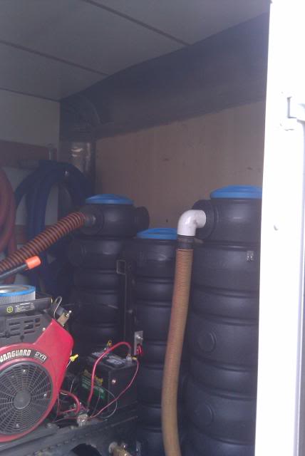

hummm i went through and dumped a bunch....maybe i might have some on my other pc...but for now...
I tweaked this out so i could run my 2 2" to a Y for a 2.5

Thats a cool mod you did for the vac ports.. how long you own one and any downside to them? You build your own machine?

it was a bastardized avenger 210....
i had it for about 6 mths before i bought out this other biz, and acquired his everest...
like i said...the basket is a bit big to be able to just throw in a knee high for ease of cleaning....
also the long blower filter didnt fit....now i think if i had tweaked where i mounted the blower port it may have worked...maybe Larry has figured it out...and thats a damn good price to...
I really liked it....and i would do it again in a heart beat...but me personally would want 2...but thats me...
i really want to know if Les can mount my everest parts on 1 of his tanks though...that would be AWESOME...
I have that top part still to, if you want it...

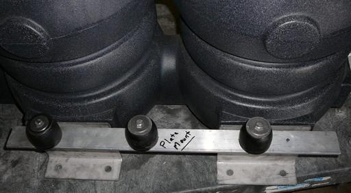

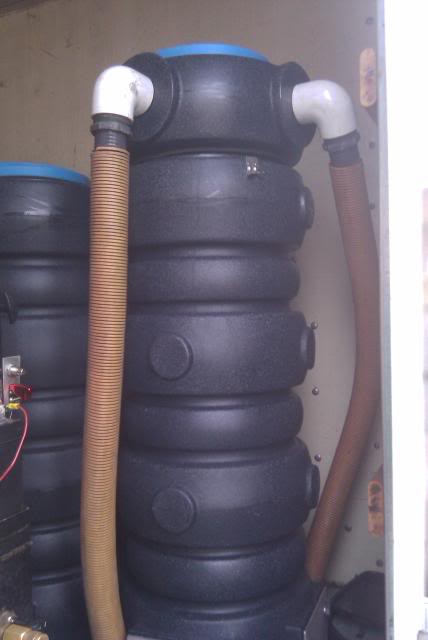

It only comes with the filter basket . . . (no float switch).
That has worked well in our installations.
This install used the four 1/2" bolts in the 1/4" steel supports to mount the power component plate:
