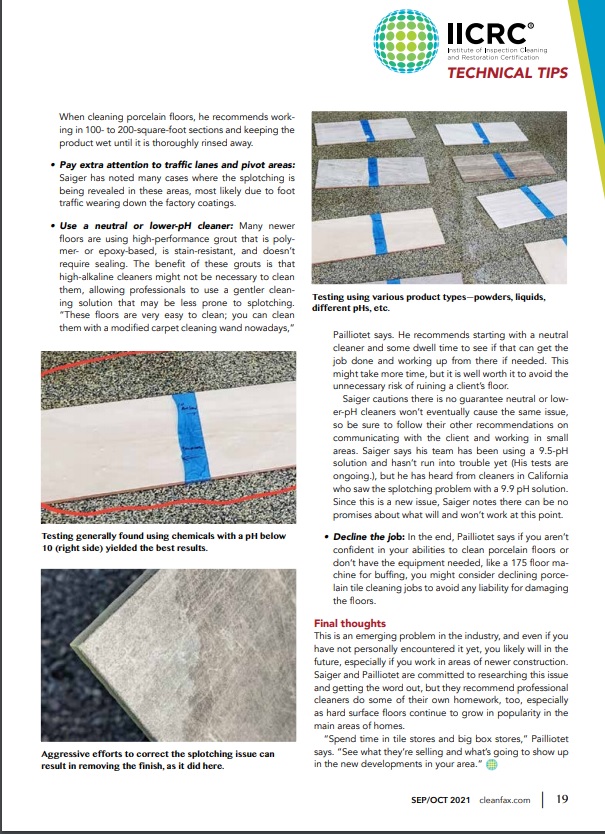

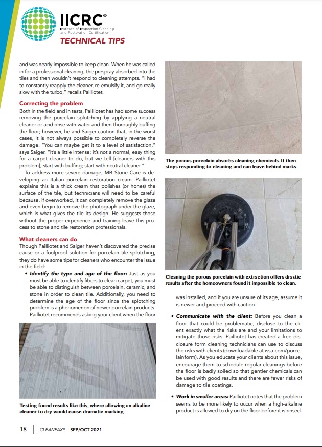

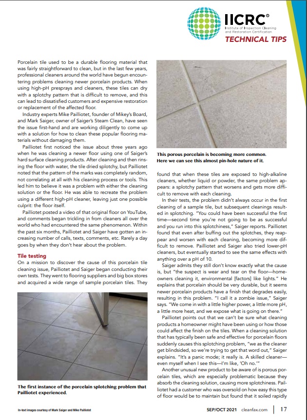

Findings as of 7/24/21
The professional cleaner needs to explain to the customer prior to cleaning the reality of their faulty flooring.https://mikeysboard.com/threads/the...ke-pailliotet-mark-saiger.298401/post-4765474
You can safely assume that any and all of the wood and stone look "porcelain" tiles and planks made within the last five years can easily be damaged by what we'll call "chemical burn" (splotchy, Rorschach like spots), heavy foot traffic, office chair wheels and sharp objects, etc.
In order to make the photograph of whatever the tile is attempting to mimic, the top protective glaze is applied as thin as possible to provide realism. The durability of this glaze is very poor.
In some cases an additional protective coating is applied to protect the glaze in the shipping process, this layer is easily damaged and can often be removed with just isopropyl alcohol.
Chemical burn typically happens in traffic lanes and pivot areas, where the glaze is already worn, so be sure to inspect prior to estimating/cleaning for pre existing damage caused by the homeowner or prior professional cleanings.
All semblance of what traditional (real) porcelain should act like, such as highly scratch and chip resistant as well as staining and wear resistance has been lost on these new faux porcelain products. Explaining this to your customers is crucial.
When cleaning stick with liquid cleaning agents in the 4 to 8 range on the pH scale. Remember, the tile itself cleans up with just a neutral cleaner, a light scrubbing or dwell time and a 300-400 psi rinse. You goal is to get the grout as clean as possible WITHOUT harming the glaze. Many modern installs will have been installed with polymer fortified grout which cleans up very easily, without extreme chemistry or PSI.
Work in small areas no larger than 300 feet at a time and DO NOT let your cleaning agents dry before rinsing.
Run an "all fiber rinse" type product through your truckmount at all times.
Do not use the plastic ring option on your spinner tool or any other tool that can potentially scratch the tile, including a Teflon glided carpet wand
Use a flat mop or bonnet to remove all standing water after cleaning.

getting back to the fix...
Small burns can be fixed by hand with a fiber pad punch out and in lite cases, just a MF towel, and the cream (#2).
It's important to work #2 as little as possible and to keep it wet when scrubbing. Much like stone restoration, check you progress often.
If overworked, an un-natural polish effect can happen with #3, but unlike stone, you can not reverse this polish/shine.
If VERY over-worked by going to heavy and hard and letting the cream dry, you can reach and start to remove the photograph.
As for cream #1:
It does need to be worked wet to dry in order to remove(lite) scratches and extreme chemical burn
It too can be over worked and caused damage, so work "lite" with a hand held polisher or by hand with a punch out vs a 100# pound floor machine.
I have not had the need to use #3 yet.
