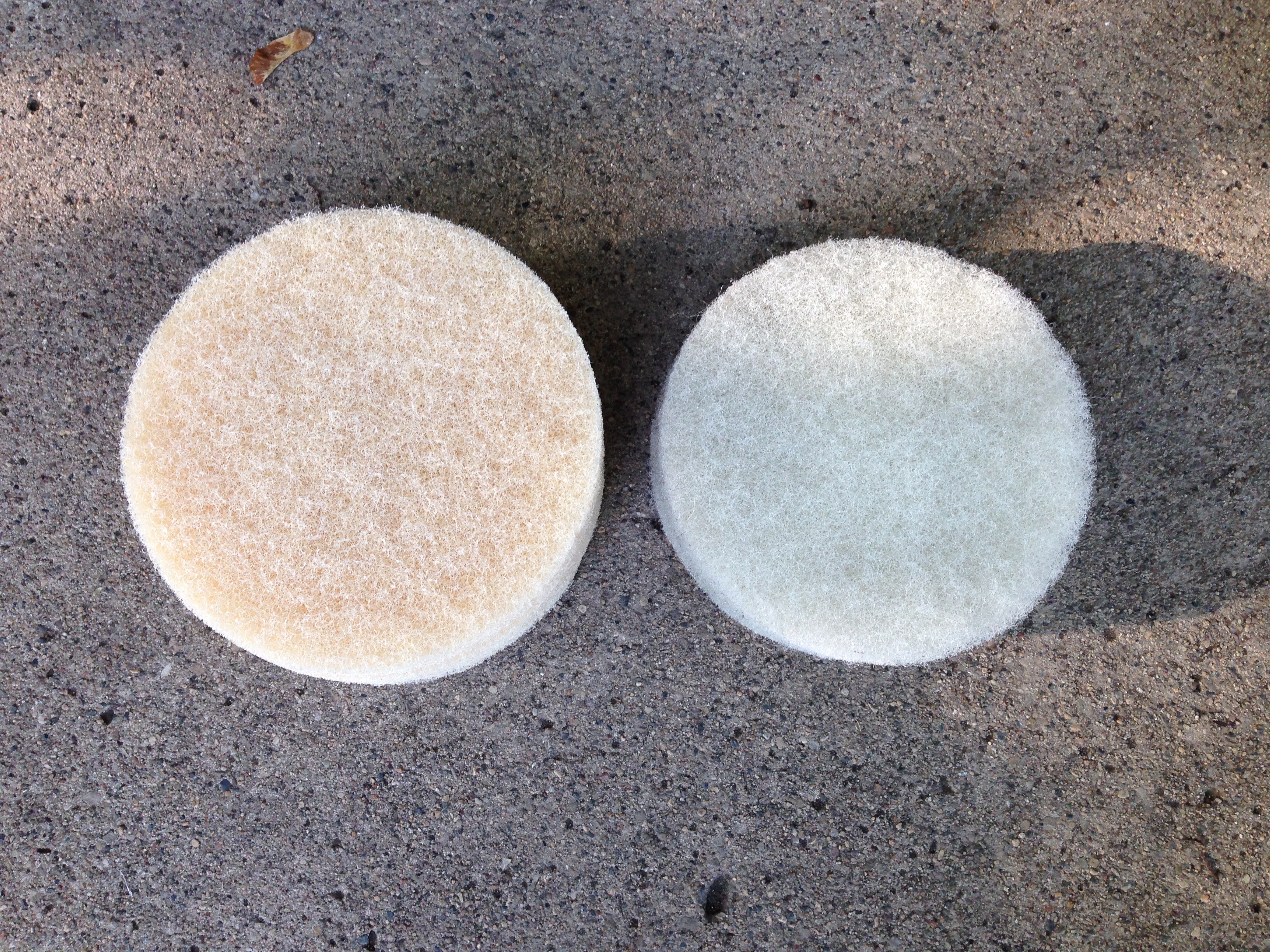

The pads on the left came from Jon Don and were MUCH burlier than the ones on the right, which came from Interlink. Both were described as tan/beige/or champagne on the sites.
I'm able to use both sides of the ones from Jon Don so I get WAY more mileage out of them.
Rick's pads are excellent too, quite a bit more pricey than Jon Don the last time I checked. 3 boxes of 15 pads will last me a while without breaking the bank.
